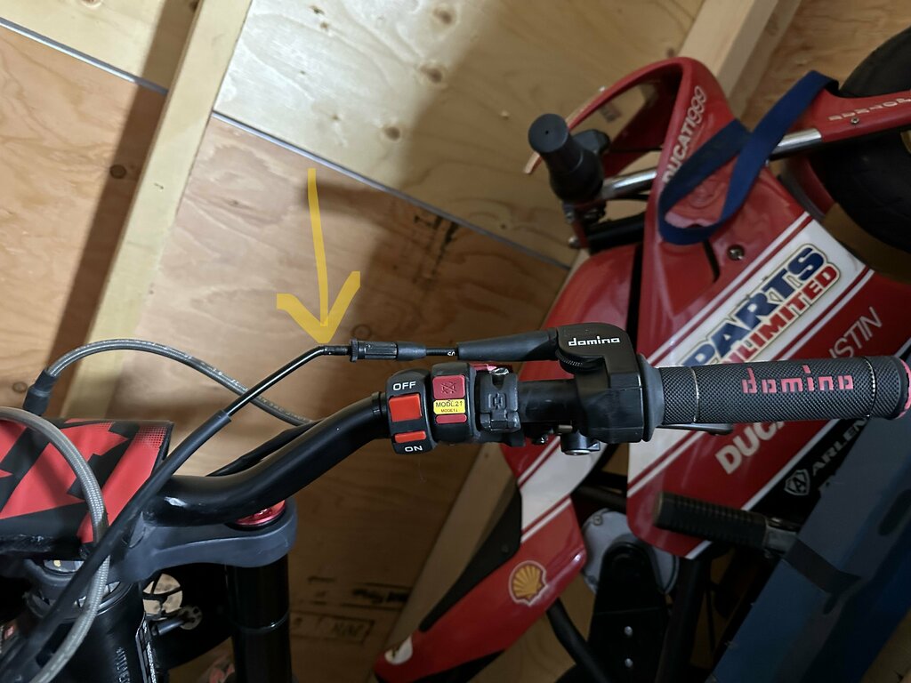

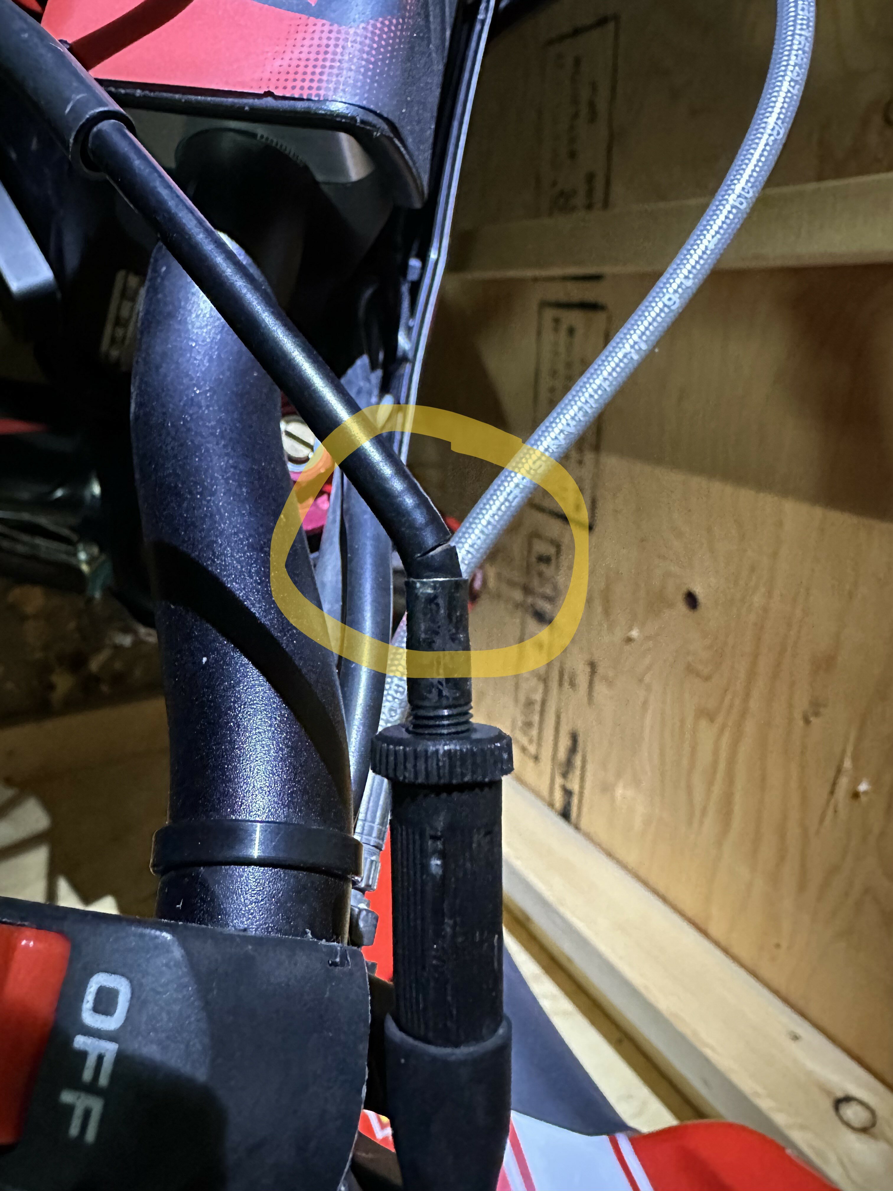

Cota300rr Posted January 22, 2024 Author Report Share Posted January 22, 2024 Here are the pictures. When I bought this bike used it had this same issue so I replaced the cable and now it has happened again a year later. I tried my best to follow the routing as per the manual, too. Anybody seen anything like it? Quote Link to comment Share on other sites More sharing options...
Tr1AL Posted January 22, 2024 Report Share Posted January 22, 2024 @Cota300rr it looks although it is not completely clear that your throttle cable is routed across the tank to the left hand side of the frame , if it is then this is the reason for the breakage in the outer throttle cable as your throttle cable outer casing has no slack in it as it would have if is routed to the right hand frame side. Quote Link to comment Share on other sites More sharing options...
Cota300rr Posted January 22, 2024 Author Report Share Posted January 22, 2024 2 minutes ago, Tr1AL said: @Cota300rr it looks although it is not completely clear that your throttle cable is routed across the tank to the left hand side of the frame , if it is then this is the reason for the breakage in the outer throttle cable as your throttle cable outer casing has no slack in it as it would have if is routed to the right hand frame side. Hmm, it's definitely routed on the right. It is attached with a cable separation clip to the clutch hydraulic line and both run along the right hand side of the tank. Sorry for the pictures not being clear, bike is tucked into a shed with six other bikes and kind of hard to get to at the moment! Quote Link to comment Share on other sites More sharing options...
Tr1AL Posted January 22, 2024 Report Share Posted January 22, 2024 2 minutes ago, Cota300rr said: Hmm, it's definitely routed on the right. It is attached with a cable separation clip to the clutch hydraulic line and both run along the right hand side of the tank. Sorry for the pictures not being clear, bike is tucked into a shed with six other bikes and kind of hard to get to at the moment! The breakage is caused by the outer cable not having enough slack in it from the point where it leaves the tank/ frame gap to the throttle tube housing if you google images of a 300RR specifically you can see many images of the cable being such a length that the cable exits upward and forward of the throttle tube housing more toward the front wheel where as yours kinks on a backward exit of the throttle tube housing exit. Hope that is of some use to you resolving the problem , have a good evening. Quote Link to comment Share on other sites More sharing options...
Cota300rr Posted January 22, 2024 Author Report Share Posted January 22, 2024 1 hour ago, Tr1AL said: The breakage is caused by the outer cable not having enough slack in it from the point where it leaves the tank/ frame gap to the throttle tube housing if you google images of a 300RR specifically you can see many images of the cable being such a length that the cable exits upward and forward of the throttle tube housing more toward the front wheel where as yours kinks on a backward exit of the throttle tube housing exit. Hope that is of some use to you resolving the problem , have a good evening. Yeah I guess I'll have to resolve it by looking at more pictures and figuring out why it's lacking that slack in it. Thanks for your input, much appreciated! Quote Link to comment Share on other sites More sharing options...
