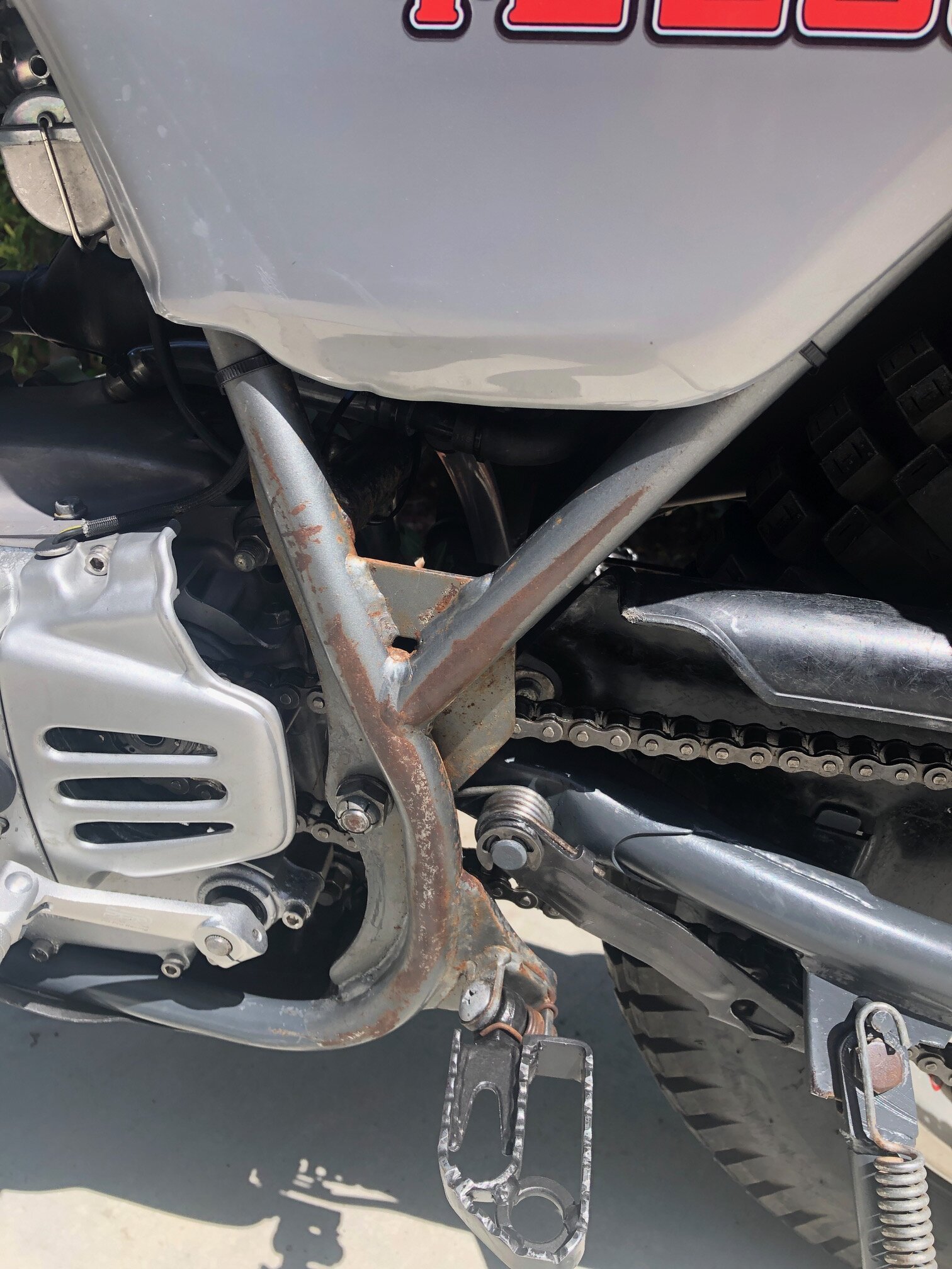

My 75' Honda TL250 has the stock tiny foot pegs. I see kits advertised to modify & enlarge the original footrests by welding in steel pieces. Have a MIG welder etc but would prefer to just buy quality modern style complete pegs that fit with none or minimal modification. Does anybody make these for my bike?

Nothing wrong with the stock pegs. But you can cut the mounts off  and weld new mounts on that fit the modern pegs. If you are just riding vintage events, you are just wasting time and money. Ride it more and figure out the bike. It just has to be ridden aggressive.

The angle of rotation (back/ up) is usually different for modern trials pegs vs vintage trials pegs and all MX bikes.  If you find modern pegs to bolt on they may not be horizontal on top.  In addition, you need to consider kick start clearance.  I widened the stock pegs.  The funny angle is for kick start clearance.
