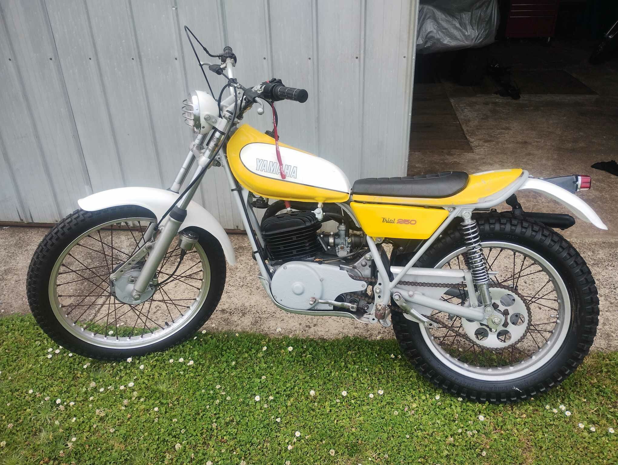

BBJ Posted January 25 Report Share Posted January 25 Hi, Can anyone help me with wheel spoke sizes or any info as trying to source some here in Australia, Like i don't have a manual or anything? They are a bit dirty looking so maybe renew to make it look nicer. Thanks for any help 1 Quote Link to comment Share on other sites More sharing options...
feetupfun Posted January 25 Report Share Posted January 25 Yamaha was selling genuine spoke sets for TY250 last time I bought some. They are zinc plated. Stainless steel spoke kits for them are available from In Motion in the UK. I know you can get spokes custom made by a bloke in Brisbane. You will probably have to send him samples to copy. There are probably people all over Australia who can make spokes for you from samples. Another option that people do is to re-plate the original spokes. 2 Quote Link to comment Share on other sites More sharing options...

BBJ Posted January 25 Author Report Share Posted January 25 Thanks guys, i did go to a local shop here and they rang some fella who i think makes them and was quoted $180 a set stainless steel.. Might be the best bet to take wheels off etc.. Quote Link to comment Share on other sites More sharing options...
faussy Posted January 25 Report Share Posted January 25 (edited) How long are you intending to keep the bike and wanting them to look new? The zinc spokes start to look tarnished again within a couple of years, at least in the weather over here. The stainless are expensive but will look just as good in 10 years as the day you get them Edited January 25 by faussy Quote Link to comment Share on other sites More sharing options...
lemur Posted January 25 Report Share Posted January 25 If all else fails; Zinc plating is the easiest electroplating that you can do yourself with very little cost or equipment. Quote Link to comment Share on other sites More sharing options...
majesty Posted January 25 Report Share Posted January 25 (edited) https://www.tytrials.com/shop/search.php?q=spokes https://www.central-wheel.co.uk/products/spokes-and-nipples/stainless-steel-spoke-sets.html Edited January 25 by majesty Quote Link to comment Share on other sites More sharing options...
