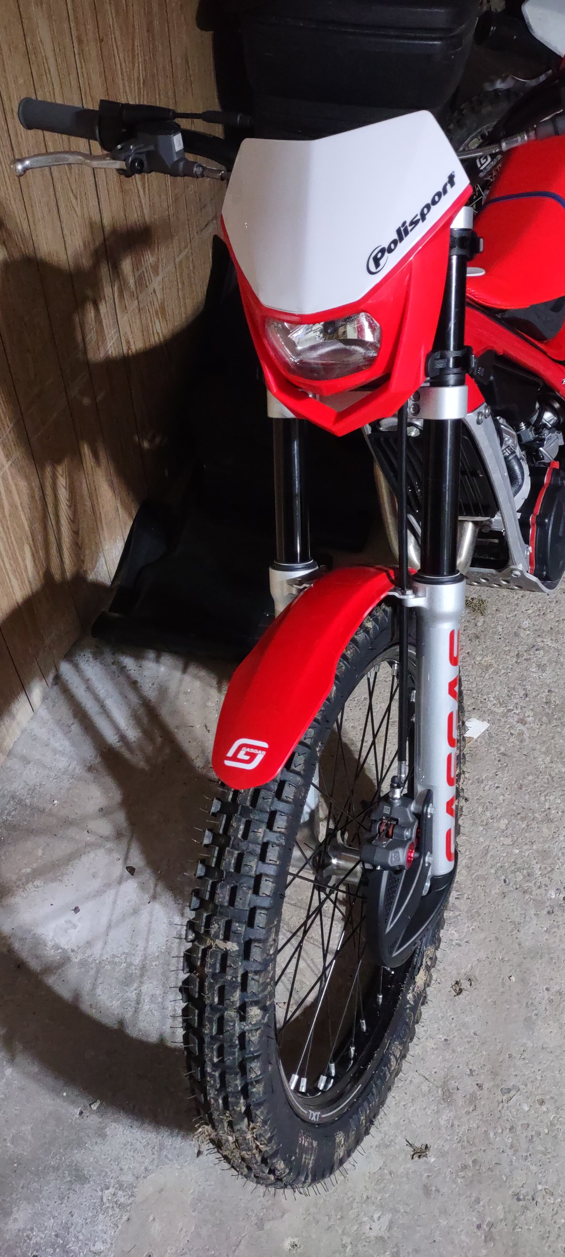

Scottro Posted February 14, 2024 Author Report Share Posted February 14, 2024 I was playing around in the garage and thought I'd try fitting a DOT legal headlight to the TXT300. Looks pretty good. If I decide to use something like this, I'll power it with a Milwaukee 18V battery and leave the bikes electrical system out of the equation. Quote Link to comment Share on other sites More sharing options...
