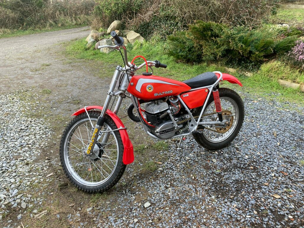

stanley Posted February 13, 2024 Report Share Posted February 13, 2024 is there a factory set for float height on m y 76 350 Sherpa , at the moment it is reluctent to start , takes 3 /4 kicks with choke on all jets pilot /main are clean , passage ways are clear , fuel filter is new , needle is set in the middle groove ,pilot is screwed out 1 1/2 turn once it starts it runs normally right through the rev range , Quote Link to comment Share on other sites More sharing options...
bullylover Posted February 14, 2024 Report Share Posted February 14, 2024 Get it started up and get the bike warm/hot. Then get a small flat blade screwdriver and just set the idle so the bike is idling okay. Then move the airscrew until you find the highest idle point. That is the correct airscrew position for your bike. Make sure it will accelerate fine with no hesitation or sluginess. This is the best way to set your airscrew. Every engine is different so tune your engine how it likes to be. Quote Link to comment Share on other sites More sharing options...
stanley Posted February 16, 2024 Author Report Share Posted February 16, 2024 Hi thanks for the reply BL engine is just rebuilt with new piston /rings/small ends/gudgen pin rebored to 84mm carb/jets are all clean/clear I took the floatbowl off "one more time" to discover one float has completley disintergrated into many small pieces floating around within the bowl carb is original I think from 1976 Bing 84 also ordered new float ass. new jets pilot/main/needle from Inmotion so waiting for post to arrive then will report hopefully just some fine tuning on the pilot as you said watch this space 1 Quote Link to comment Share on other sites More sharing options...
stanley Posted February 17, 2024 Author Report Share Posted February 17, 2024 carb floats have been installed Sherpa started second kick tick over now fine tuned ..............thank you BL for your input .........VERY HAPPY OF DAMP NORTH WALES 1 Quote Link to comment Share on other sites More sharing options...
