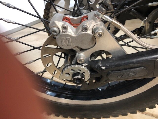

mcman56 Posted February 14, 2024 Report Share Posted February 14, 2024 (edited) The rear brake is the one thing I dislike about Evos. The Beta 4t has the brake on the other side yet has the same weakness. In addition, I found Rev3 rear brakes to work fine. I sometimes wonder if the lack of feel on Evo rear brakes is actually the brake lever (flex?). Or maybe it is the combination of the lever and my small feet (size 9). The picture is more vulnerable but a workable solution. I think the Jitsie lever helps a little also. Early Rev3s had a 2 piston caliper in the back. I did this after replacing all brake components including the disc and trying all available pads. Edited February 14, 2024 by mcman56 smaller pic Quote Link to comment Share on other sites More sharing options...
