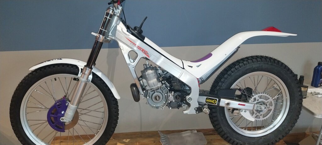

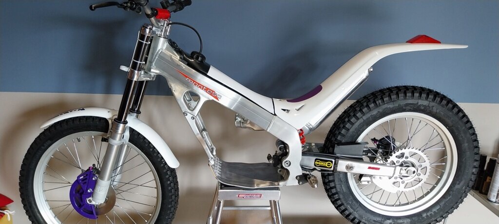

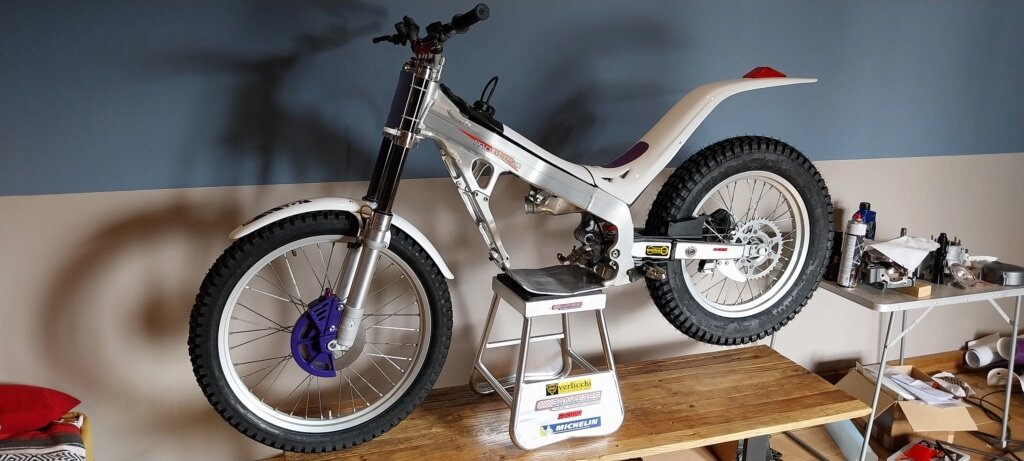

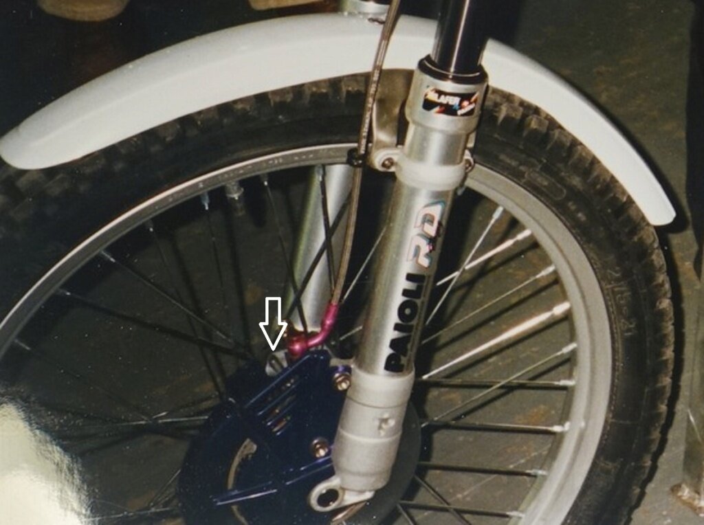

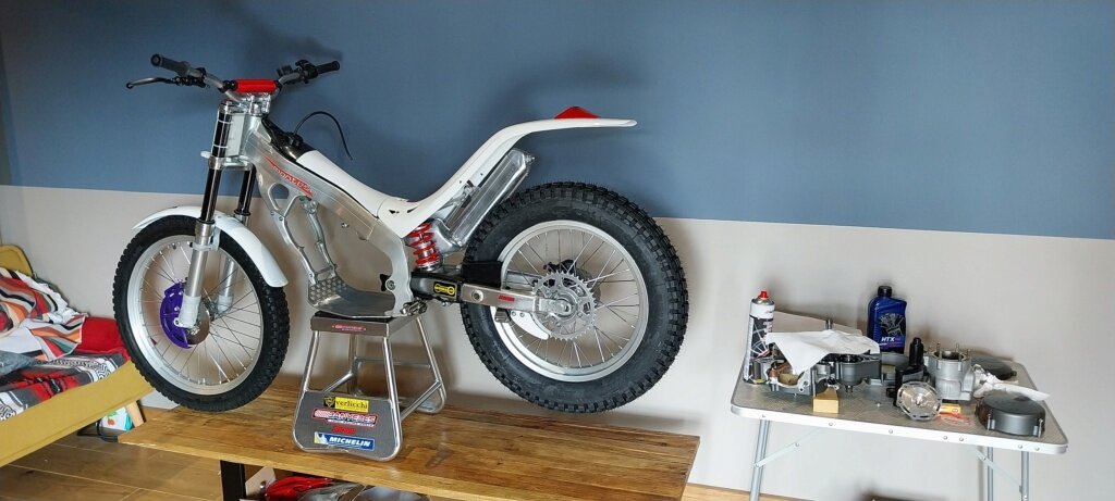

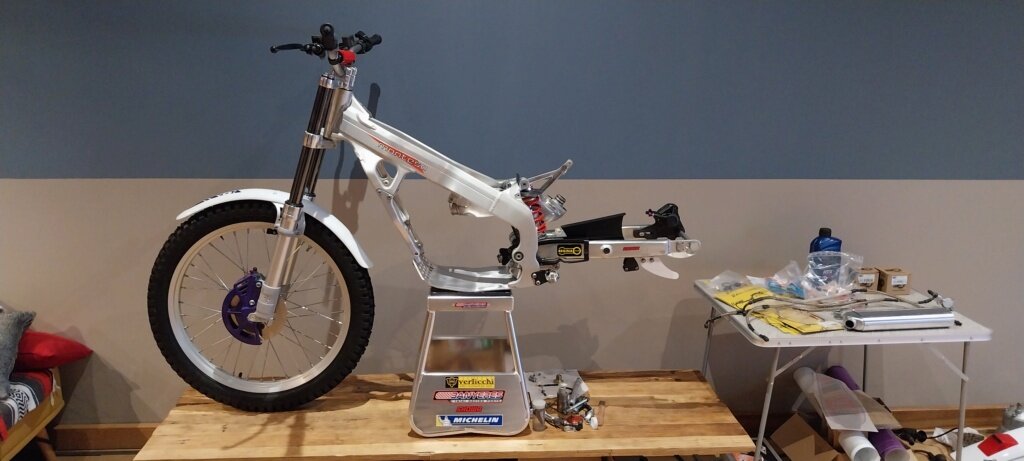

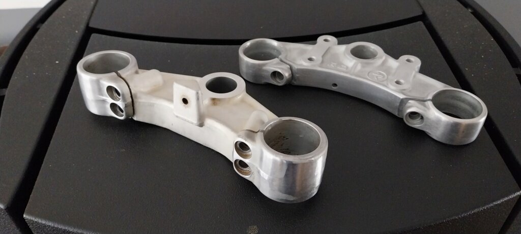

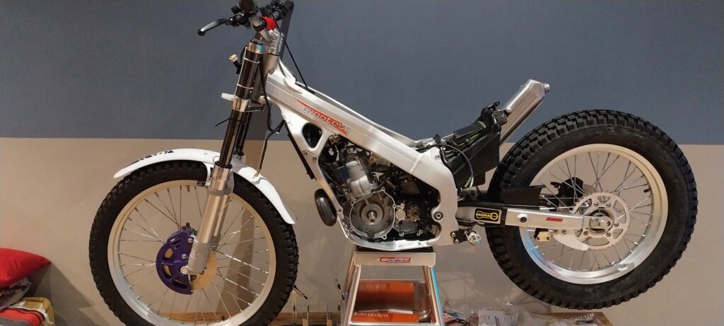

After Ogawa's bike, here is the Colomer replica 1996 project.
Special features of this motorcycle compared to the 1997 production version.

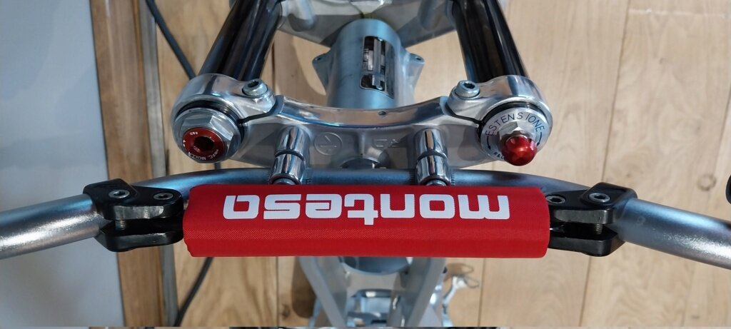

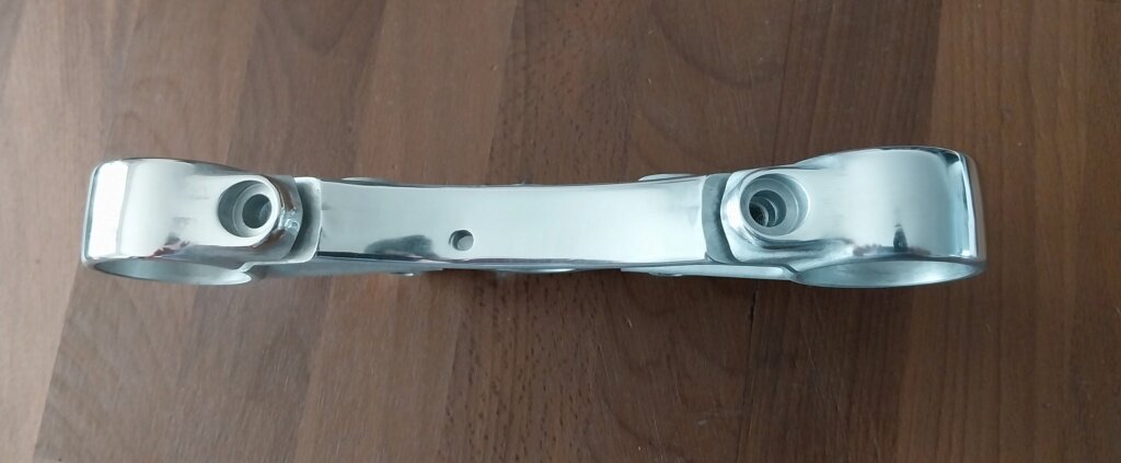

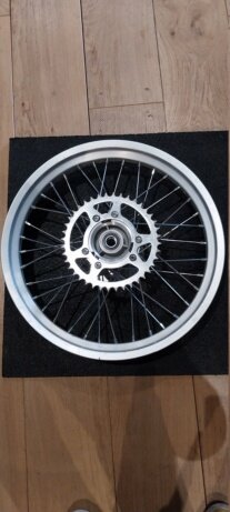

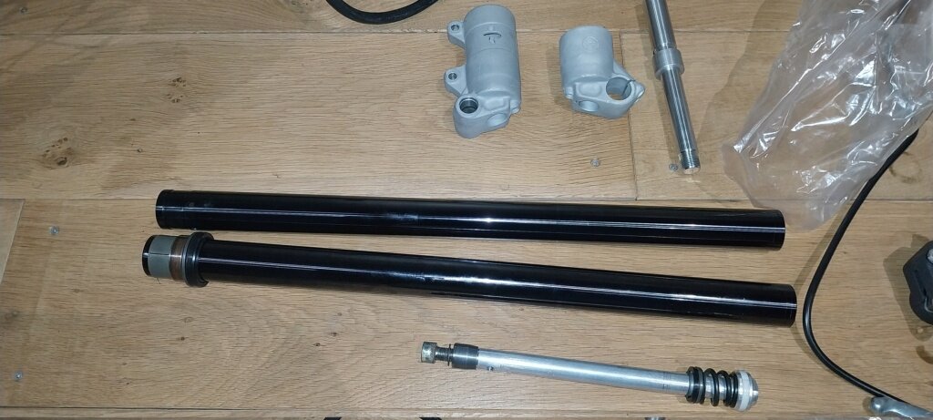

Morad 36 spoke rims mounted on polished hubs.

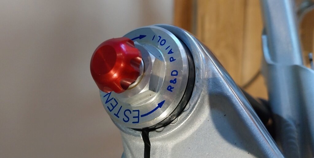

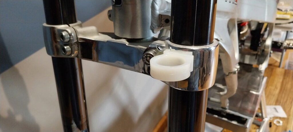

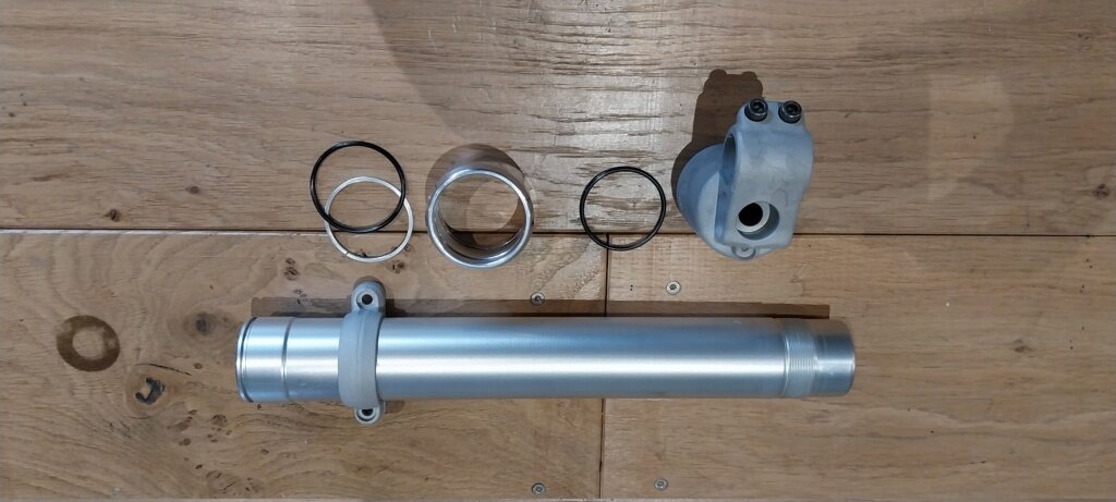

Païoli fork with DLC treated tubes. (not the 99 model black fork)
Brake and clutch hoses with purple banjos.

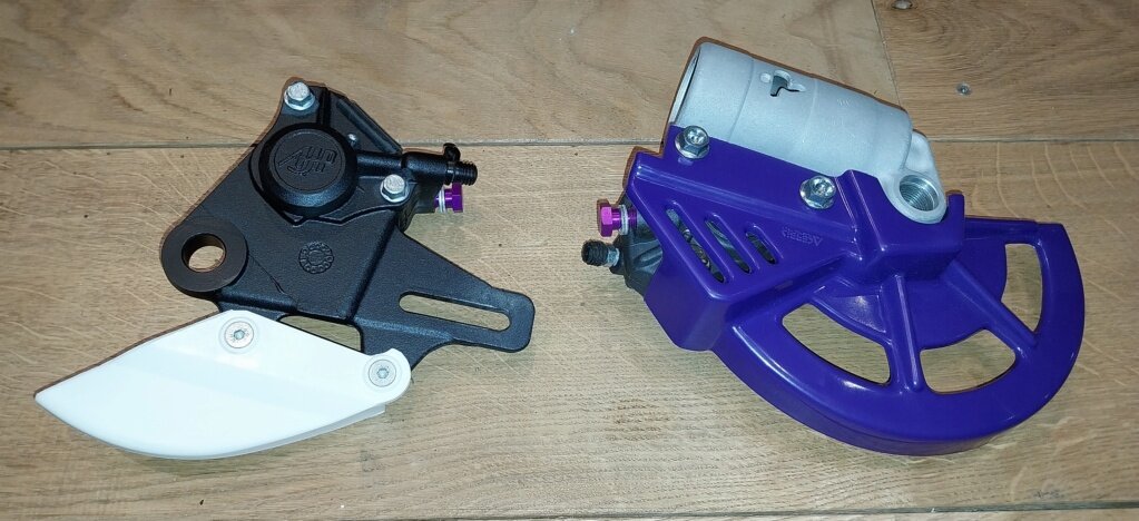

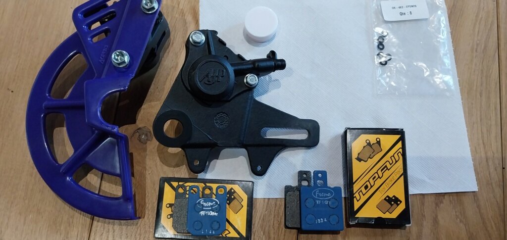

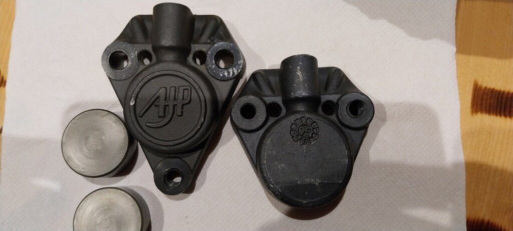

AJP front caliper previous serie with 31.8mm alloy pistons

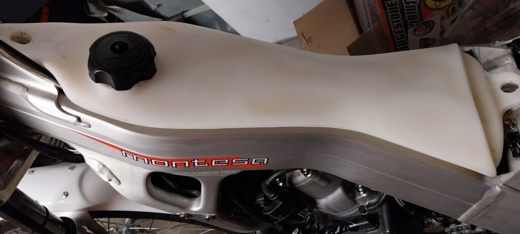

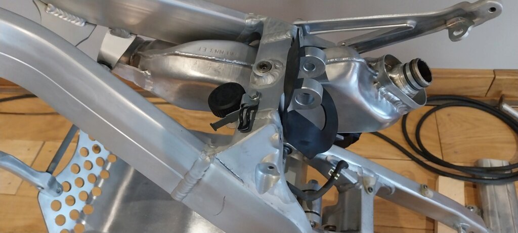

Flat tank
Disc protector 314R 1995

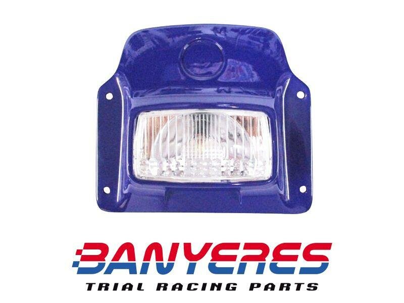

“Colomer” headlight
and more.
AJP caliper with alloy pistons (Grimeca on the 97 model)

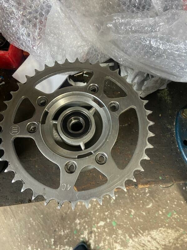

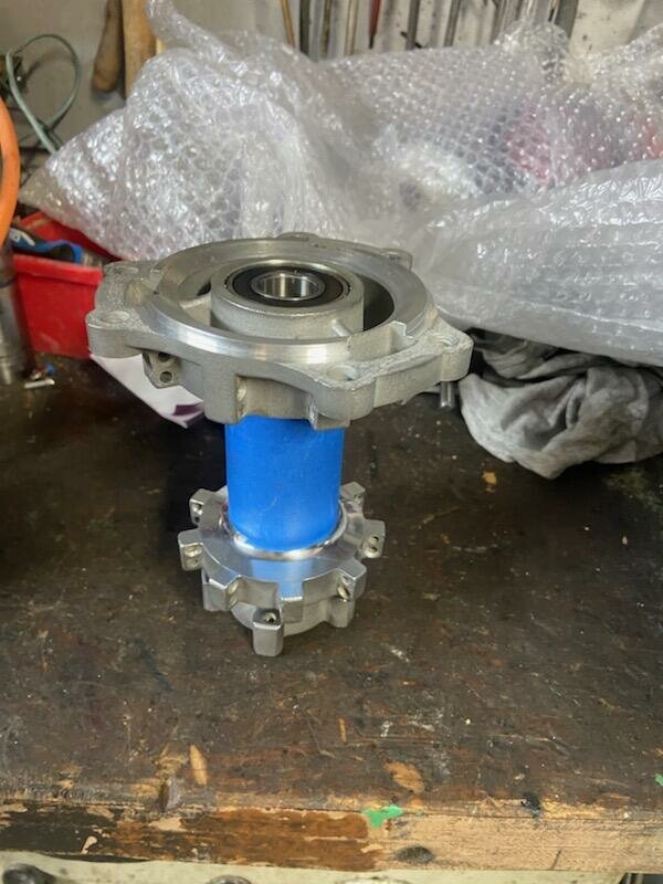

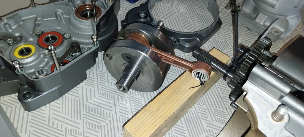

Wainting the rear hub (lathe work) and crankshaft (new conrod).

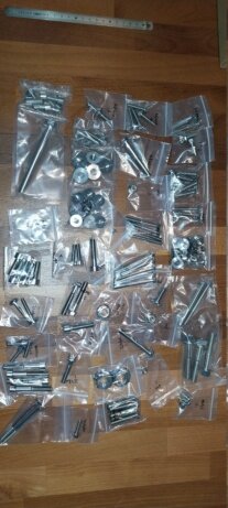

Titanium bolts ordered.
I hope you enjoy
Alain from France.

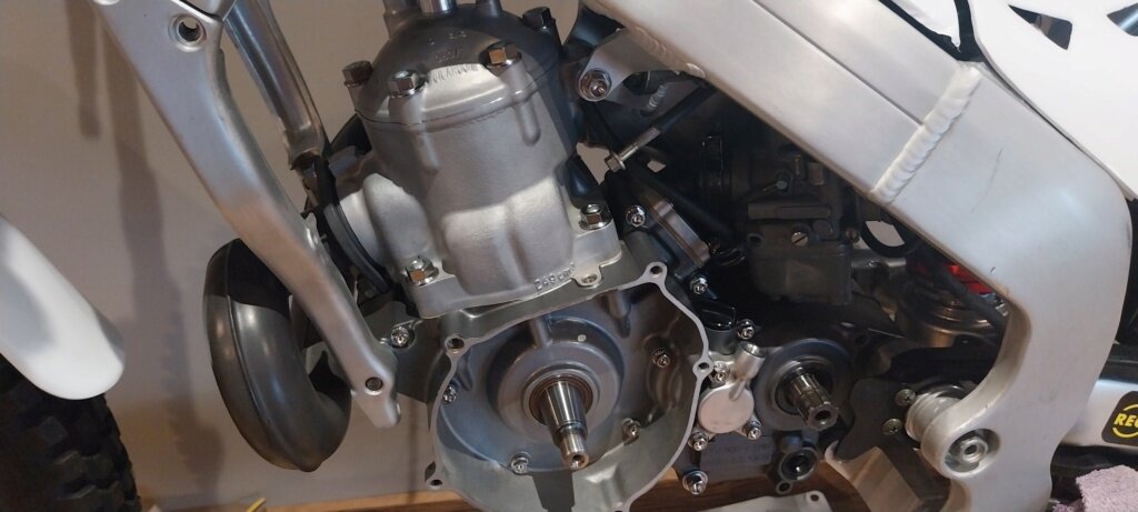

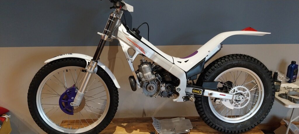

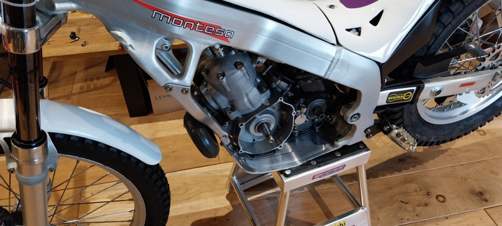

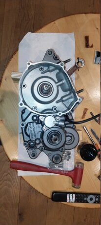

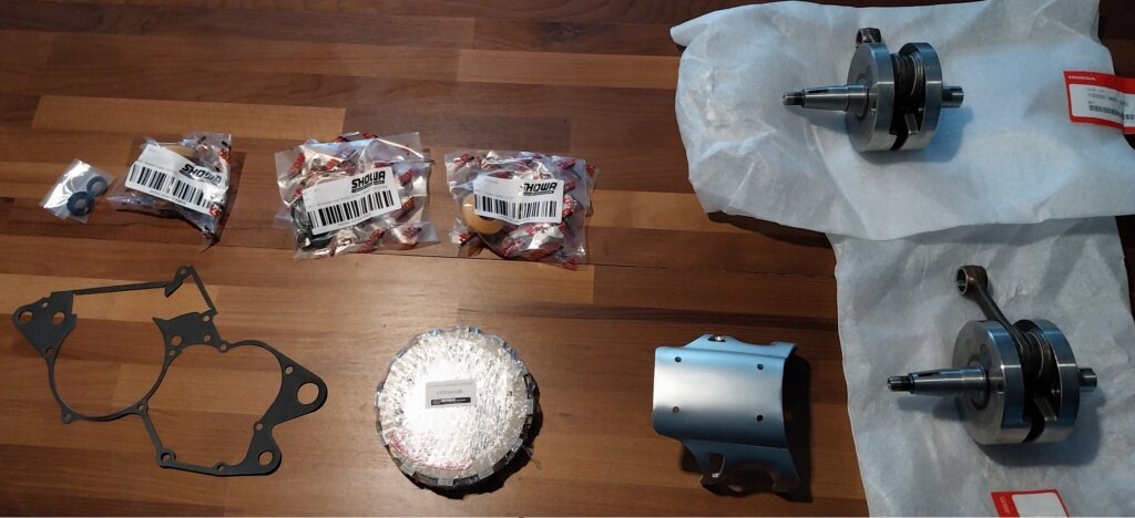

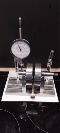

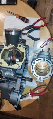

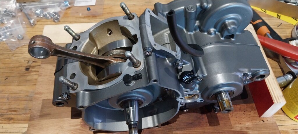

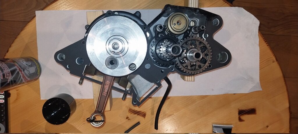

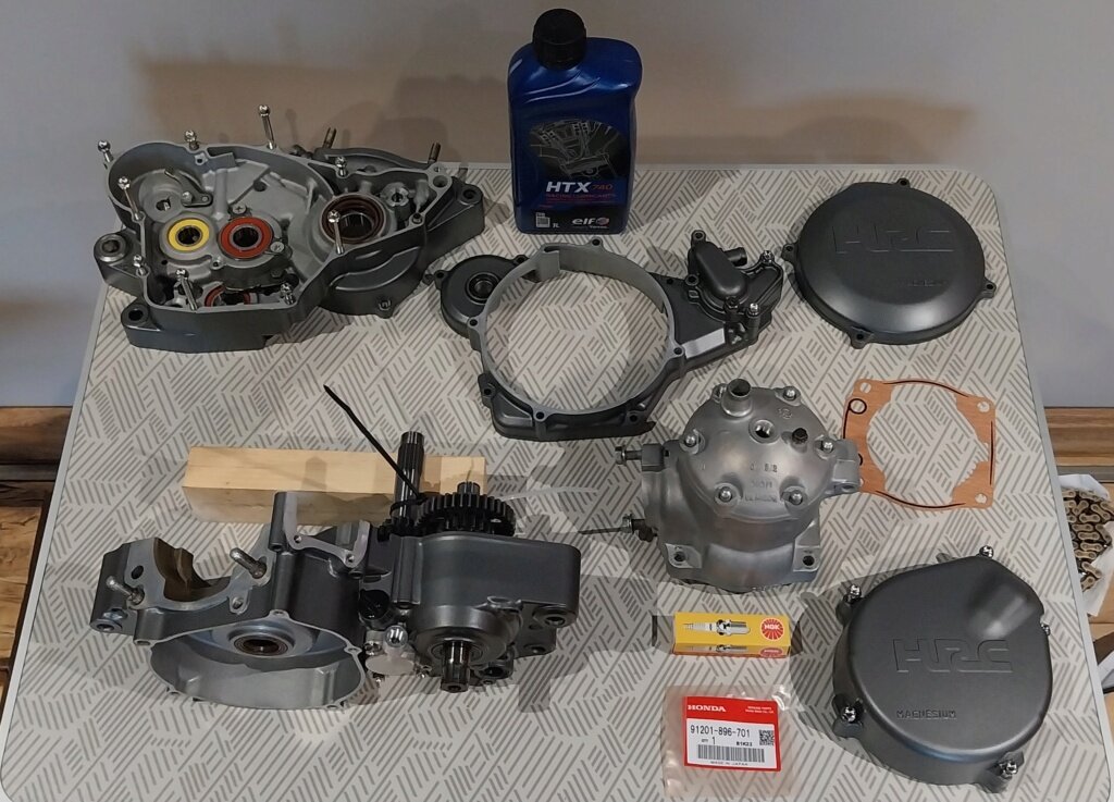

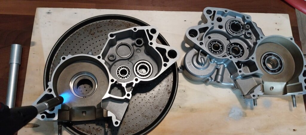

I have found 2x OEM crankshaft and conrod.
So, I remove the Italkit for an other 315R.

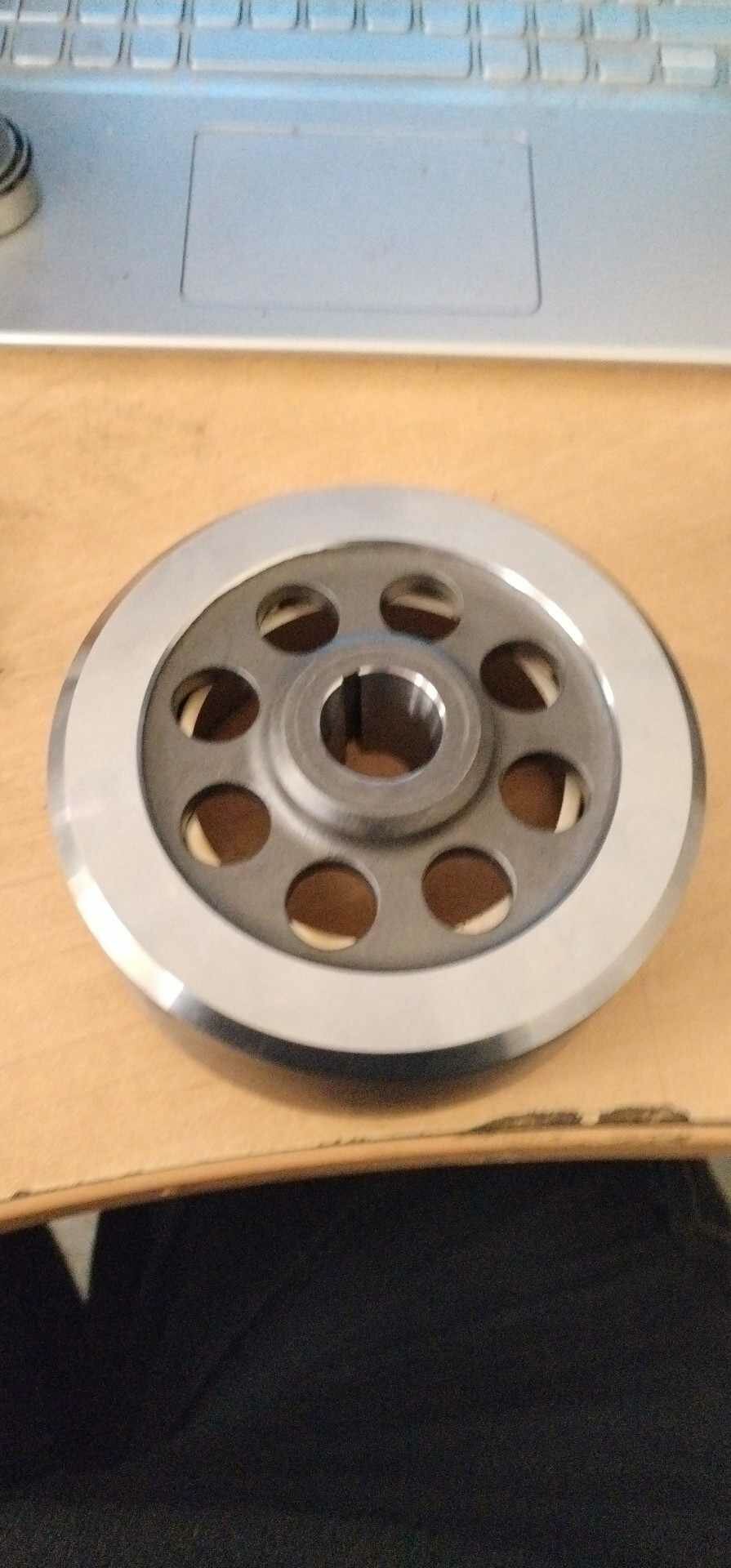

The flywheel was machined from 3.5kg to 3kg.
The engine is running well.
No vibration, no leeks. Great and Happy !

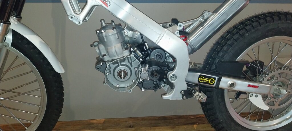

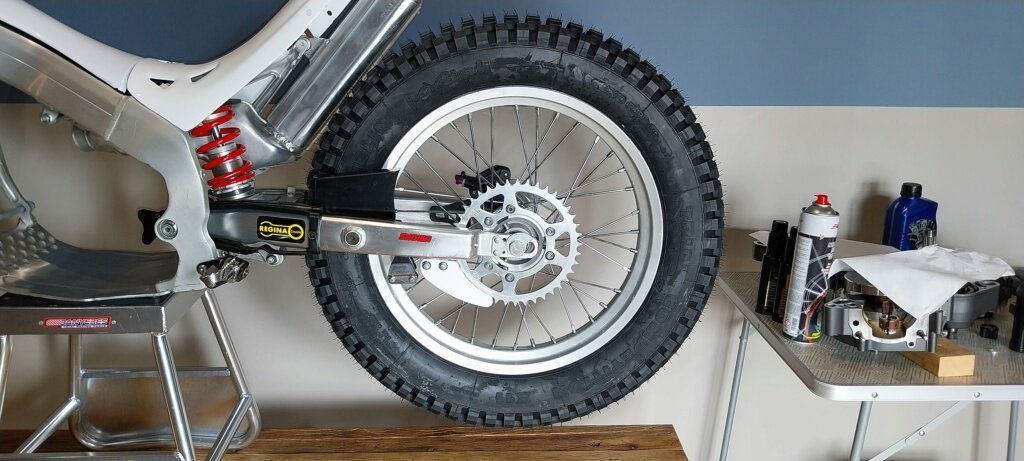

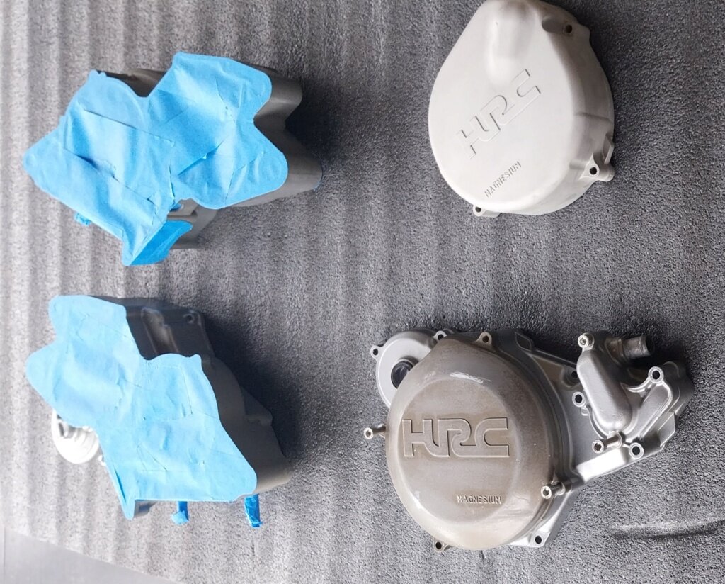

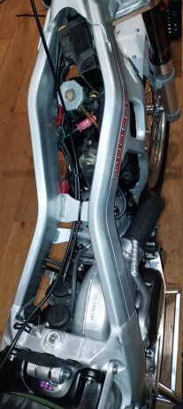

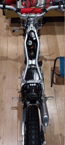

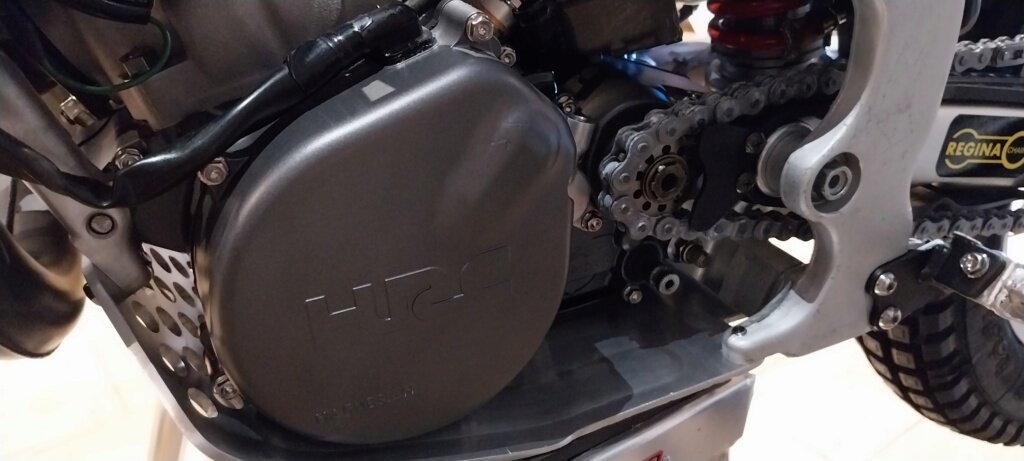

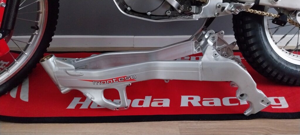

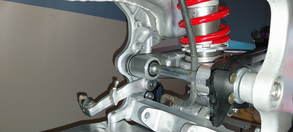

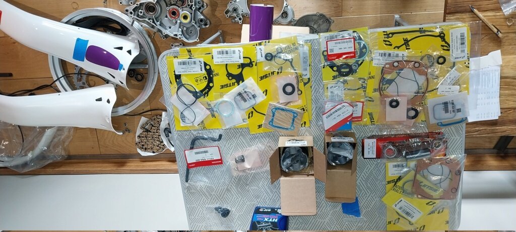

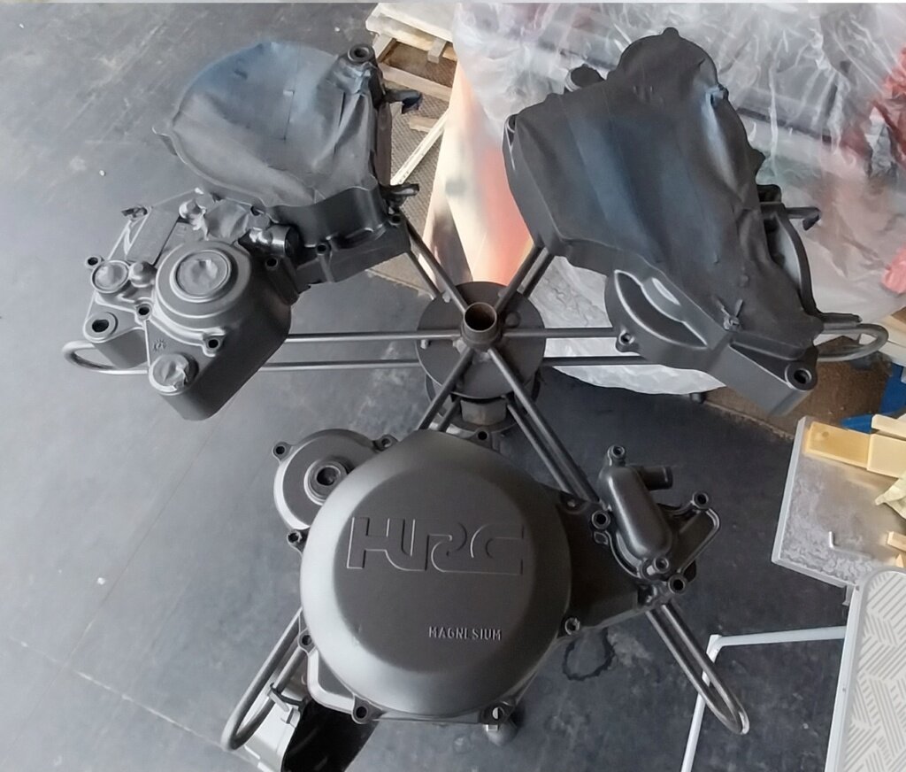

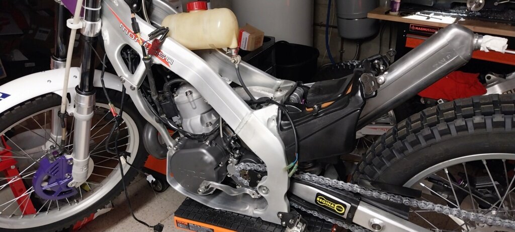

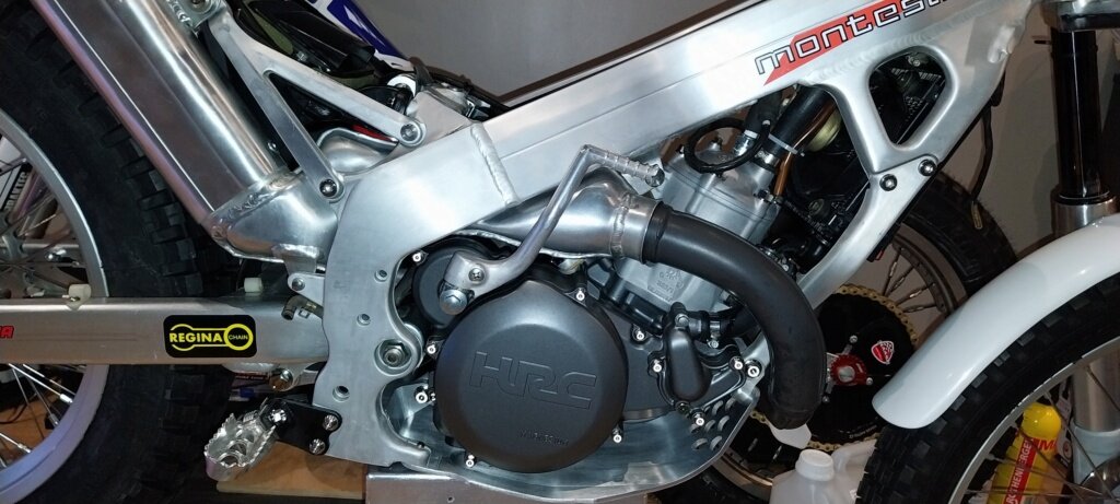

After months of stopping, reassembly resumes.

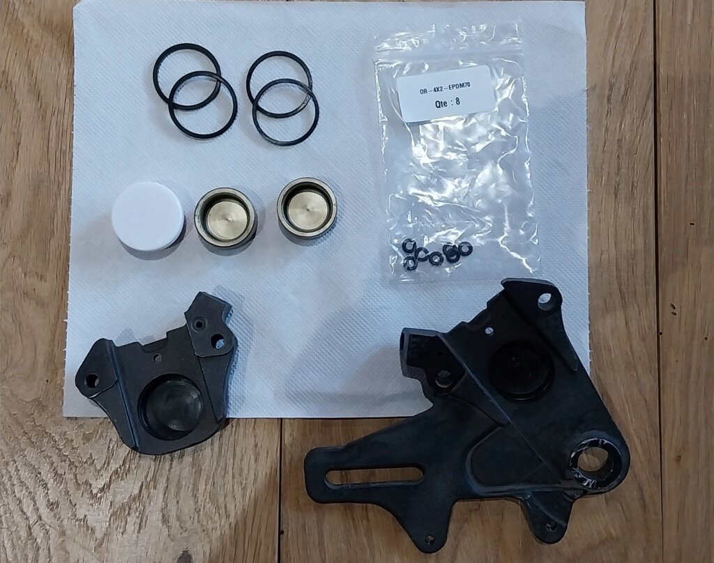

Brakes and clutch hoses after a major cleaning to decontaminate them of deposits.

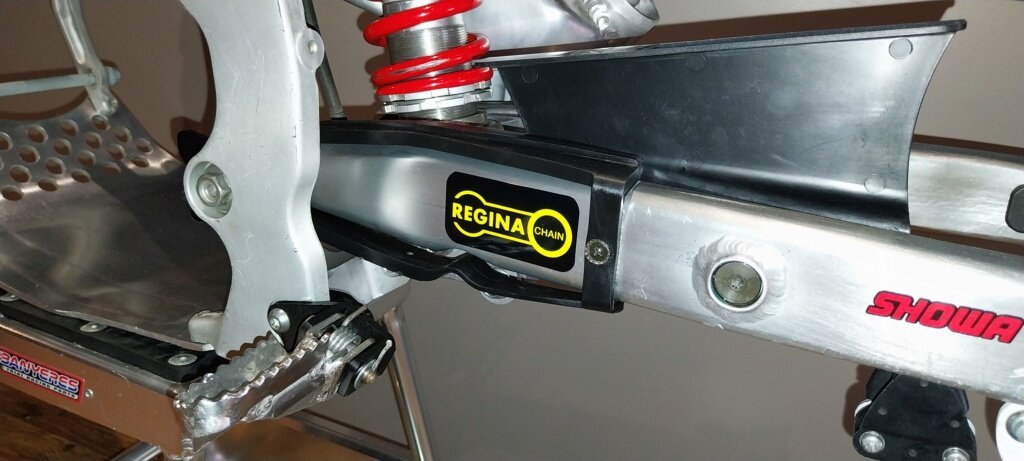

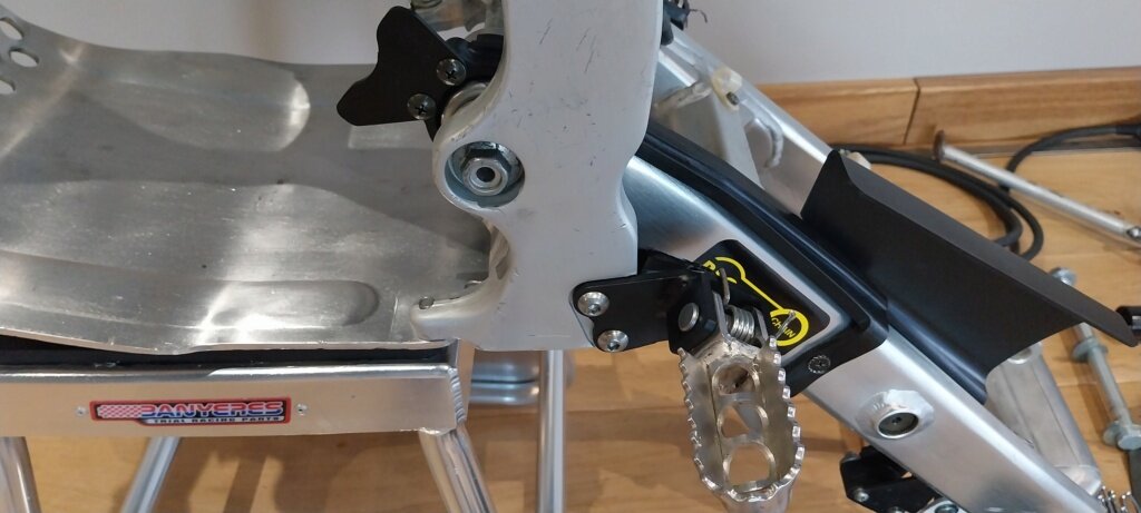

Installation of the selector, the brake pedal, the gearbox exit protection.

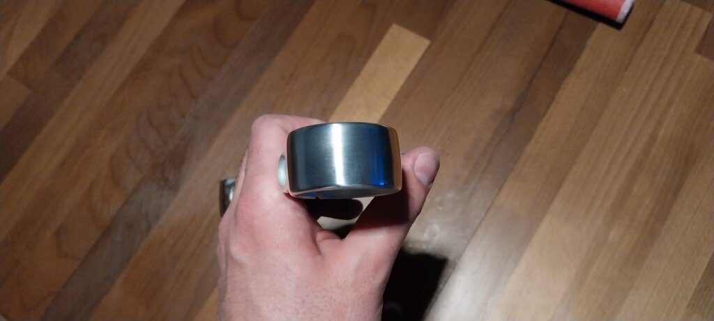

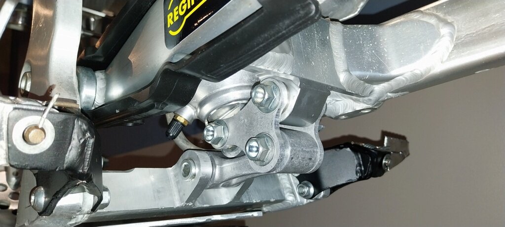

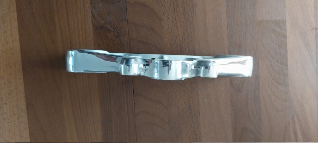

I need to rebuild a rear wheel spacer to slightly offset the caliper.
