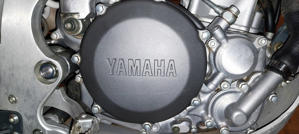

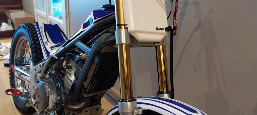

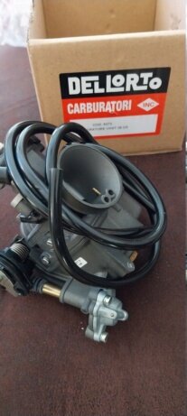

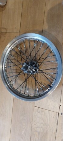

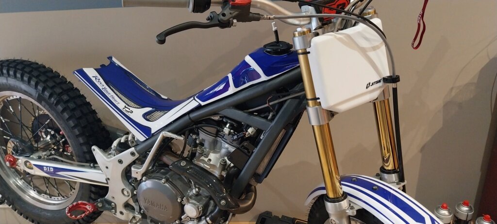

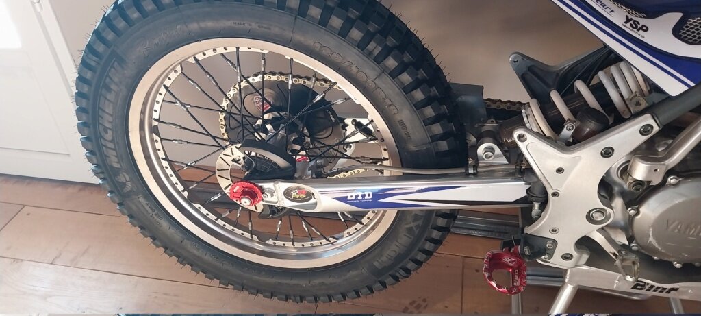

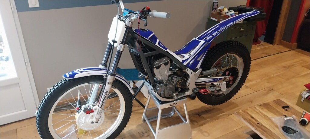

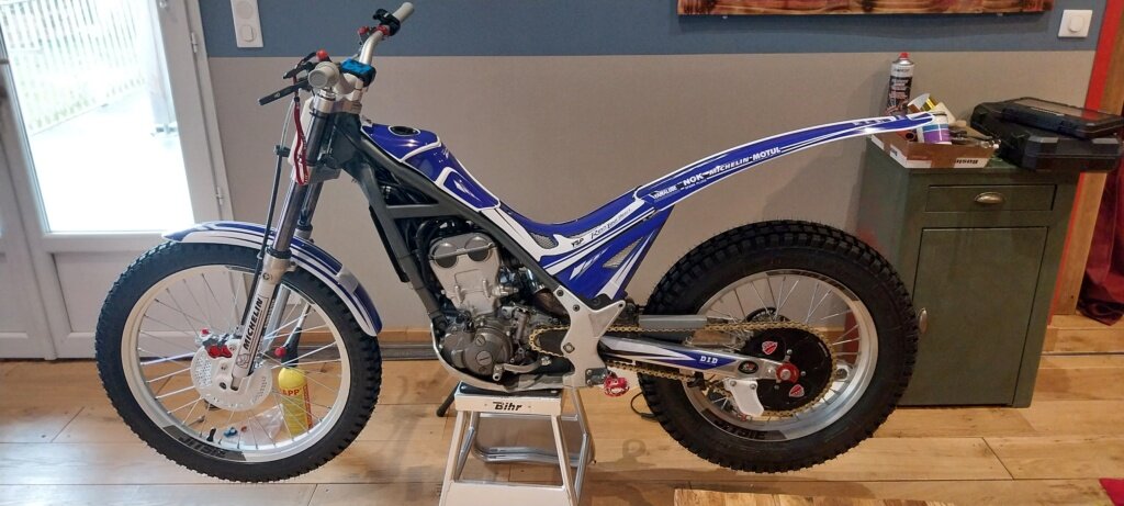

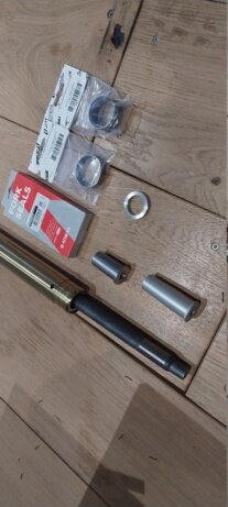

ahell Posted February 23, 2024 Report Share Posted February 23, 2024 (edited) I have some project bikes. This Scorpa is one of them. I'm a fan of Hanson racing work on this model. So, this bike is a tribute. All new chain, pads, tires ... New shock absorber buffer. Wheels bearings. Complete front brake system monobloc caliper, Braktec master cylinder and hose. S3 levers, Renthal handlebar. Lubrication chassis. New inlet rubber and airbox rubber. Hanson Racing decals New Green cotton air filter Tensioner, sprocket guard, sherco rear disc guard. Curve S3 footrest S3 handlebar foam Number plate Fuel hose. Jitsie chain tension snails. 4rt wheel axle. CSP gripster nut. Jtisie stickers. Carbon exhaust heat shield. Fork overhaul Future : Repair of the silencer which is sagging on its lower fixings. New carburetor (no gasket kit available. Expensive but essential.) Rear wheel with central rib for waterproofing. Hope you enjoy Alain from France. Edited February 23, 2024 by ahell 4 1 Quote Link to comment Share on other sites More sharing options...
