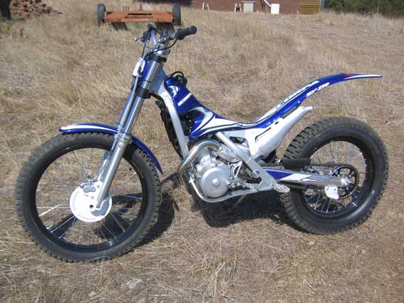

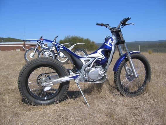

downunder Posted March 27, 2006 Report Share Posted March 27, 2006 (edited) Boo YZ250 but I think they used different rings Guess what I just got ....and it doesn't need anything trick to make it look schmick! I like 50:1 with Motul 800 and 98 octane, who cares about a little smoke ! You know the old addage...... Where there is smoke there is fire! Edited March 27, 2006 by downunder Quote Link to comment Share on other sites More sharing options...
essex rider Posted March 27, 2006 Report Share Posted March 27, 2006 Beautiful Bike, Love the triple clamps and the new colours. Add some carbon or kevlar fork and exhaust protectors and it will look super trick Quote Link to comment Share on other sites More sharing options...
