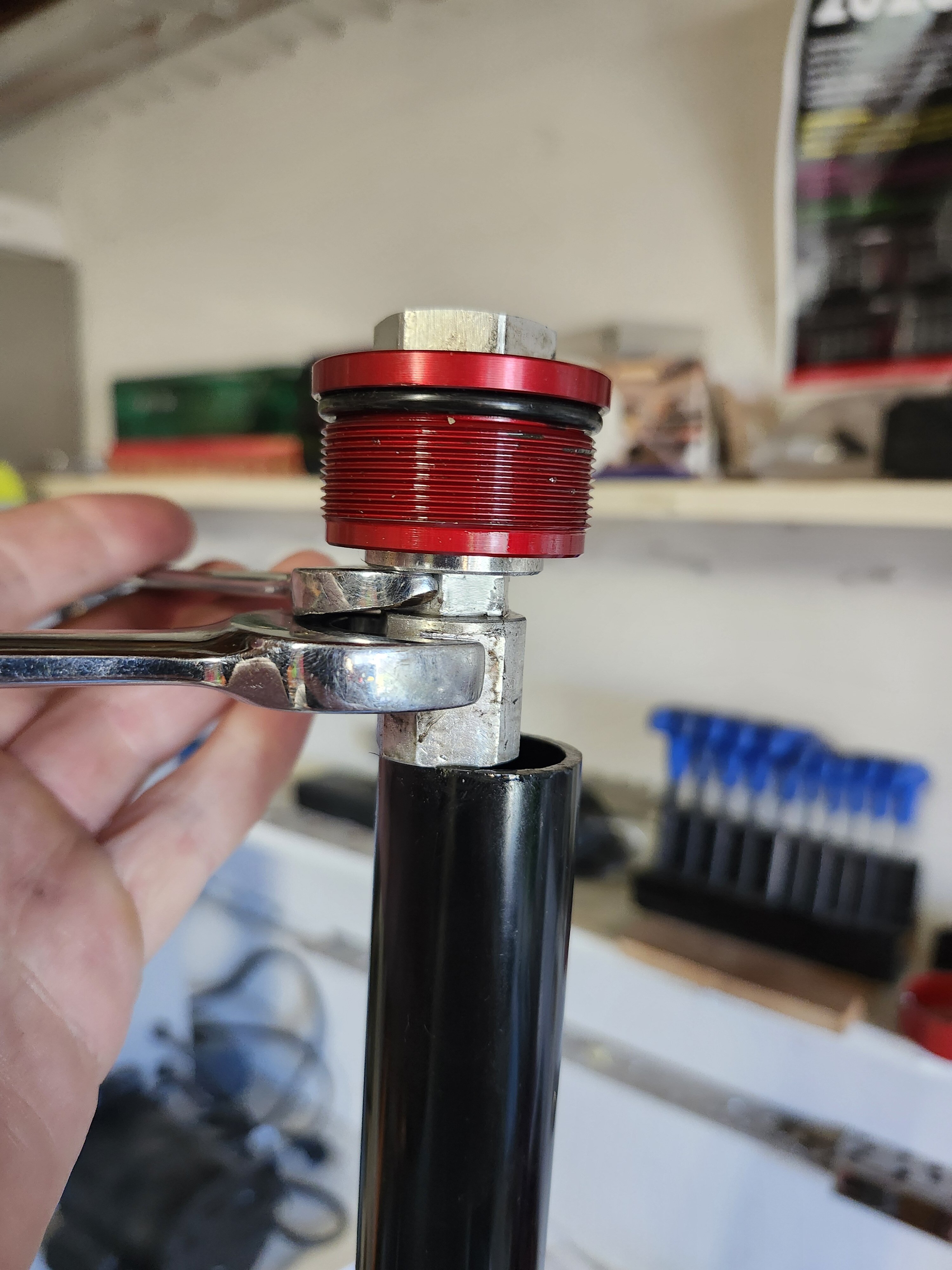

geir58 Posted February 26, 2024 Report Share Posted February 26, 2024 (edited) Hi there. I've got an 07 gasgas 280txt pro with the 40mm marzocci forks and I'm struggling to get the cartridge apart. I've got a pin spanner tool to turn the reboot cap but I can't seem to remove it. I can raise it enough to expose two hex nuts on the shift. 19mm and a thin 15mm nut, but I can't separate then. It feels like I'm going to break something. Any tips on how to disassemble? Thanks Edited February 26, 2024 by geir58 Typo Quote Link to comment Share on other sites More sharing options...
geir58 Posted February 26, 2024 Author Report Share Posted February 26, 2024 Photo for reference Quote Link to comment Share on other sites More sharing options...
konrad Posted February 26, 2024 Report Share Posted February 26, 2024 It should come apart easily. I would use a thinner 15mm wrench. Buy a cheap tool and grind it thinner. Do you have the same problem with the other side? Gentle heating always helps. Lots of Marzocchi info here: https://www.ossa-efi.com/home/chassis/marzocchi-forks Quote Link to comment Share on other sites More sharing options...
geir58 Posted February 26, 2024 Author Report Share Posted February 26, 2024 Hmm I did grind the wrench. I could take some more off. Haven't tried the other side. I'll give it a little heat to see if that helps Quote Link to comment Share on other sites More sharing options...
konrad Posted February 26, 2024 Report Share Posted February 26, 2024 Also, The Hell Team's notes say 14mm thin wrench. My thin wrenches are Imperial and one was a perfect fit. Quote Link to comment Share on other sites More sharing options...
geir58 Posted February 26, 2024 Author Report Share Posted February 26, 2024 That got it. It was just super tight for some reason, to the point where I felt like I was about to break it. Quote Link to comment Share on other sites More sharing options...
