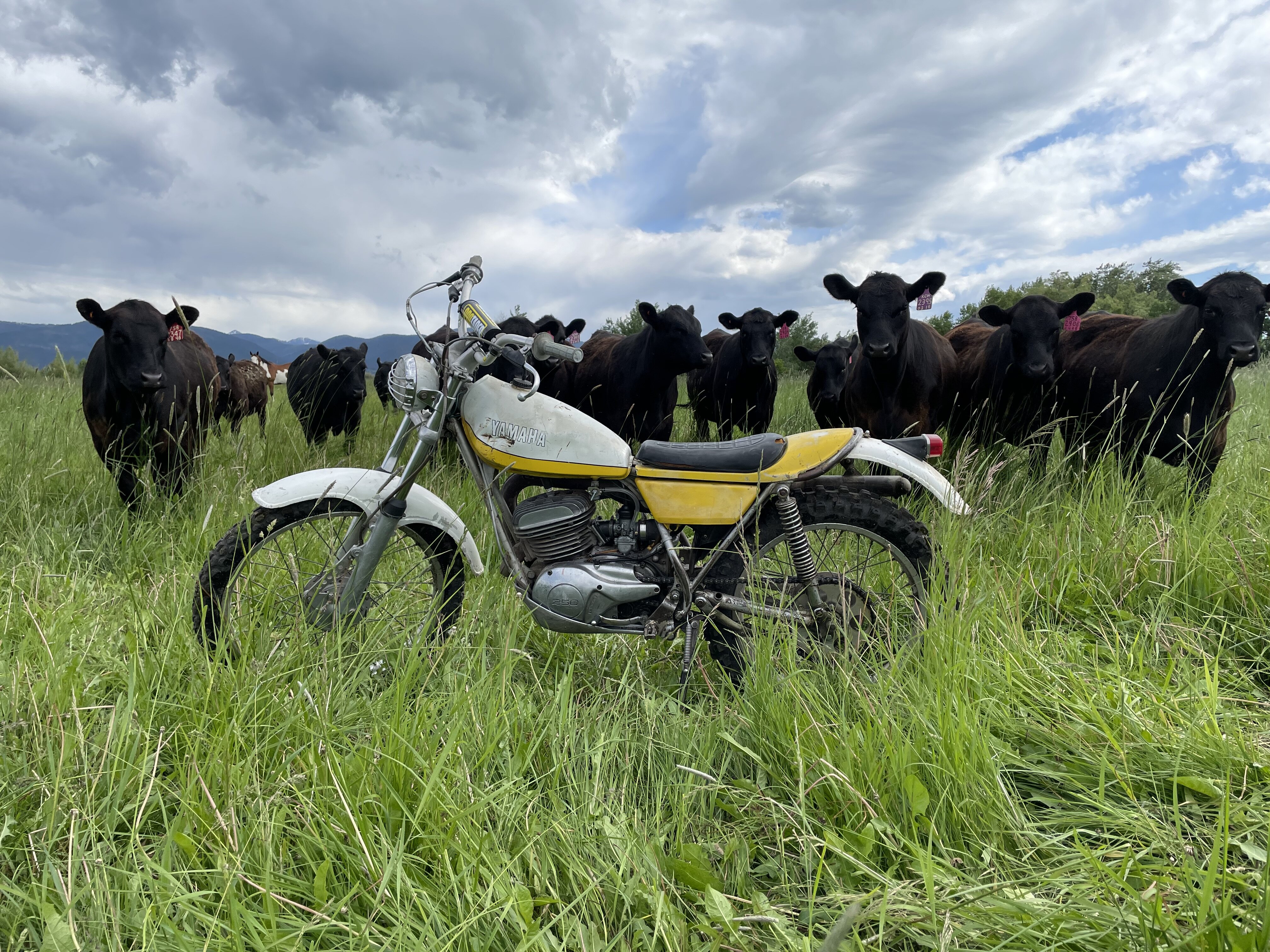

ConnorJohn Posted March 3, 2024 Report Share Posted March 3, 2024 Hey all, Hoping I can get some replies here! I’ve have a ‘74 TY250 for about a year. Took it out for a single ride other than up and down the road and around the property (moo), it was so much fun. Can’t wait for the upcoming season. two questions: 1. i purchased it for $1300. It came with an entire other bike’s worth of parts. Wheels and tires, gas tank, etc. All except the engine that was destroyed when it got wrapped around a tree. What’re your thoughts on that price for the bike and parts? I thought it was a steal. 2. I get voltage spikes on throttle and keep blowing bulbs. I replaced the condenser, contact breaker, and spark plug today and the thing fires up like it’s brand new. But still experiencing the voltage spikes. Any ideas? Maybe I’m just dumb and incorrectly wiring the lights, but also fear it could be something more systemic. Would bad magneto coils lead to this or would the condenser catch that? Any tips for trouble shooting this would be greatly appreciated. best from Montana, Connor Quote Link to comment Share on other sites More sharing options...
