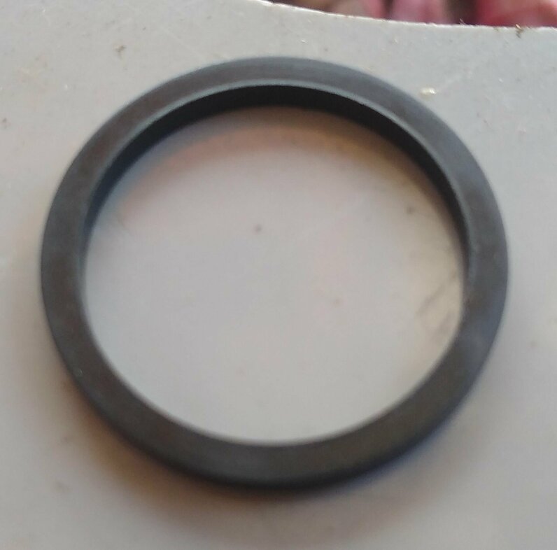

hugo_furst Posted March 4, 2024 Report Share Posted March 4, 2024 New piston seals. They compress/flex outward with braking pressure, then flex back inward and move the pistons back. If they are old / cooked from overheating, they won't . Source: "Brake Handbook" by Fred Puhn, Professional Engineer, HP Books, copyright 1985, 178 pages, mostly race car stuff. Quote Link to comment Share on other sites More sharing options...

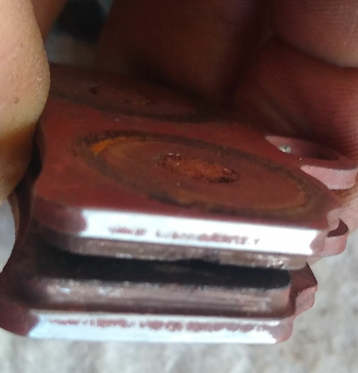

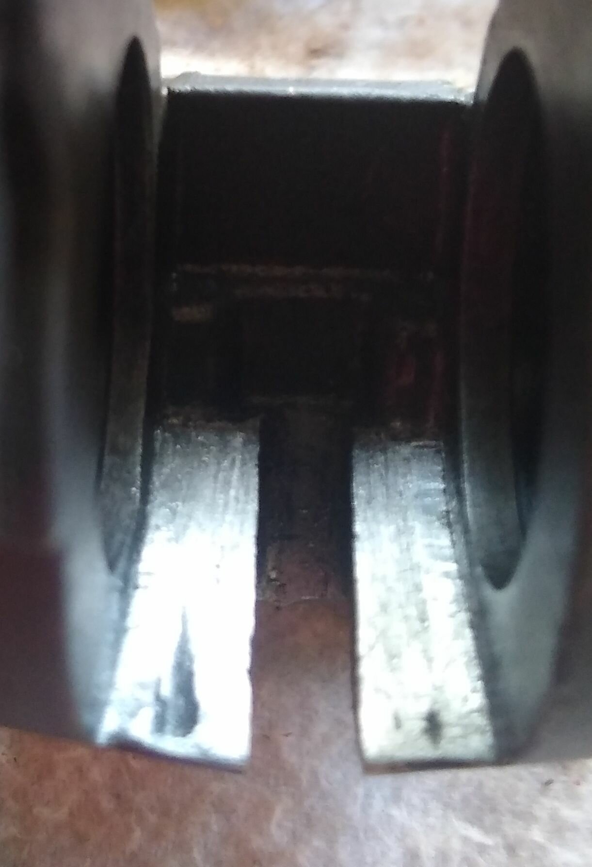

hugo_furst Posted March 4, 2024 Report Share Posted March 4, 2024 Caliper worn. Grooves where the steel plate of the brake pad rides on the aluminum caliper. Trials bike brakes usually lack the stainless steel protector found on Nissin and Brembo MX/enduro brakes. Quote Link to comment Share on other sites More sharing options...

bikerpet Posted March 5, 2024 Author Report Share Posted March 5, 2024 (edited) Thanks for all the advice, including a key PM from @konrad I was under the misapprehension that the retraction of the master cylinder piston before the feed hole opened was the main cause of retraction. I believe I've previously heard it's actually the seals, but it apparently went straight out the other ear. The front of the caliper did have grooves from the pads bearing on it. I'd given them a bit of a file to reduce them but @hugo_furst's prompting encouraged me to clean them right up. I'd looked for that due to the way a slight rollback helped to release the drag somewhat. So today I took the caliper apart again. This time I inspected the seals carefully and could see slight ridges where they have been extruding past the groove on the outer side. The grooves appeared quite clean but I gave them extra attention and replaced the seals flipped from their original position so the ridges are now on the interior side. The seals felt quite supple. I filed and scraped the pad bearing surfaces flat and square. I also filed the edges of the pads to remove the stamping roughness and put a small radius on the edges, hopefully this will reduce the scraping on the caliper surface and reduce future grooving. I tried making a stainless wear plate but there is very, very little clearance around the pistons so I would need to do some more excavation of the caliper body to fit any stainless I have here in there - 1mm was too thick. Perhaps 0.5mm sheet might fit, but it needs to be carefully shaped to sit clear of the piston. Another day perhaps. Now reassembled and very thoroughly bled. They feel better than they have for a long time. Complete release with no noticeable drag at all. Hooray. I'll try to remember to report back after they've got some hours on them to say if it's a lasting or temporary fix. Thanks everyone. EDIT. I forgot to add - Konrad sent me a link to this video showing quite clearly that it's the seals not the master cylinder that actuates the piston retraction. I should also say - probably the 'correct' solution for this is a new seal kit. But I'm your typical tight trials rider so I'd rather spend hours faffing about than spend $100 on a kit! Besides, I learnt something new. Edited March 5, 2024 by bikerpet 3 Quote Link to comment Share on other sites More sharing options...

bikerpet Posted March 6, 2024 Author Report Share Posted March 6, 2024 19 hours ago, lemur said: The little stainless leaf spring part is called the anti-rattle clip. If you're referring to the clip in the photo, that's the anti-wear shim I tried to create. Thinner SS required though. The anti-rattle spring sits over the top of the pads. But I've ditched that anyway. Quote Link to comment Share on other sites More sharing options...
