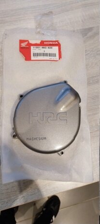

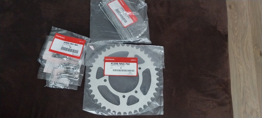

ahell Posted March 17 Author Report Share Posted March 17 Complet spare rear wheel and all new ignition cover. 1 Quote Link to comment Share on other sites More sharing options...

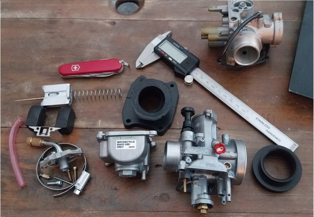

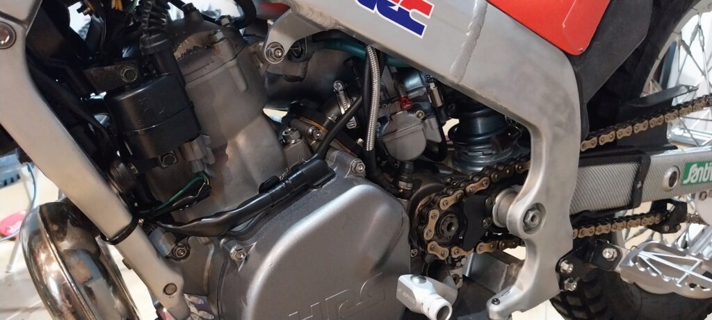

ahell Posted May 24 Author Report Share Posted May 24 (edited) I machined a keihin to 32.30mm to fit it into a remanufactured pipe. The original dellorto is 31mm. It fits without forcing. A quick dremel work to pop the pipe lug and remove the shoulder due to the original 26 diameter. I will test Josep Banyeres' sleeve to adapt the airbox. Otherwise I will install a TRS sleeve. Edited May 25 by ahell Quote Link to comment Share on other sites More sharing options...

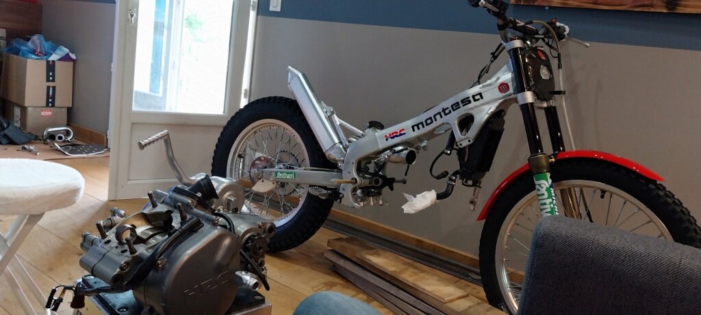

ahell Posted June 13 Author Report Share Posted June 13 (edited) Replacing the intake manifold to install the Keihin carburetor requires removing the engine. A screw is inaccessible... A quick stroke with the Dremel to adjust the manifold diameter to the white plastic part that fits into the reed valve. This gave me the opportunity to add an extra 0.5mm base gasket, following J. Banyeres' advice. The Italkit S3 piston and connecting rod are perfect. This was a good opportunity to check the previous work. 45/125 jets. It seems like a good base. New footpegs, more in line with Lampkin's bike. 48 idle jet (adaptable), 3/4 open air screw. I'll try a Keihin 48 jet to see if my adaptable jets are properly calibrated because I thought I'd see more difference between a 45 and a 48. I made three 3.5mm shims to shift the airbox further back because the carburetor and adapter piece assembly are longer than the Dellorto's. The engine is soft at the bottom. I didn't lighten the flywheel on this one. The extension seems better... test on the flat. We'll see on the climbs. Edited Thursday at 07:38 AM by ahell 1 Quote Link to comment Share on other sites More sharing options...

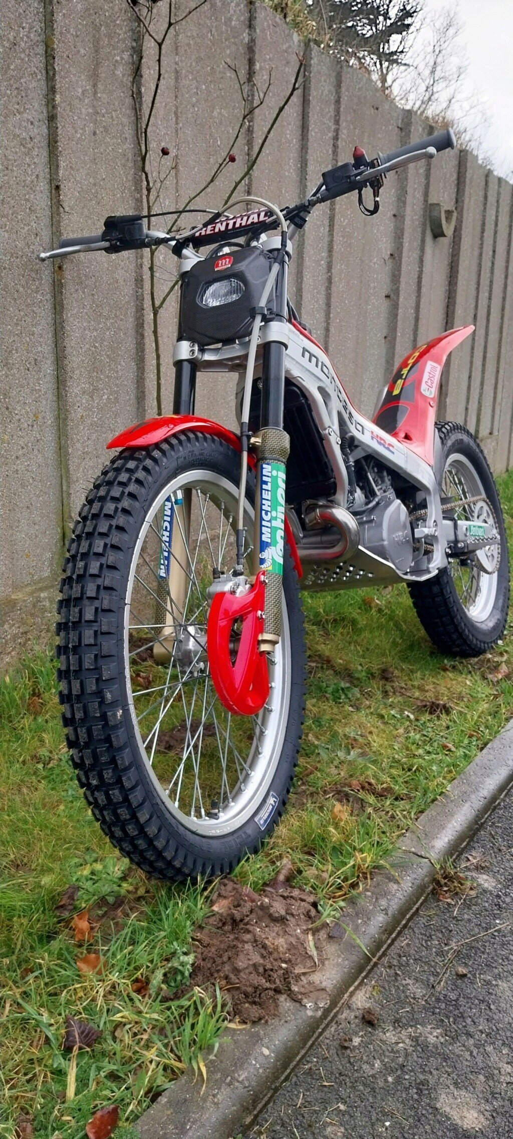

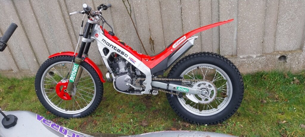

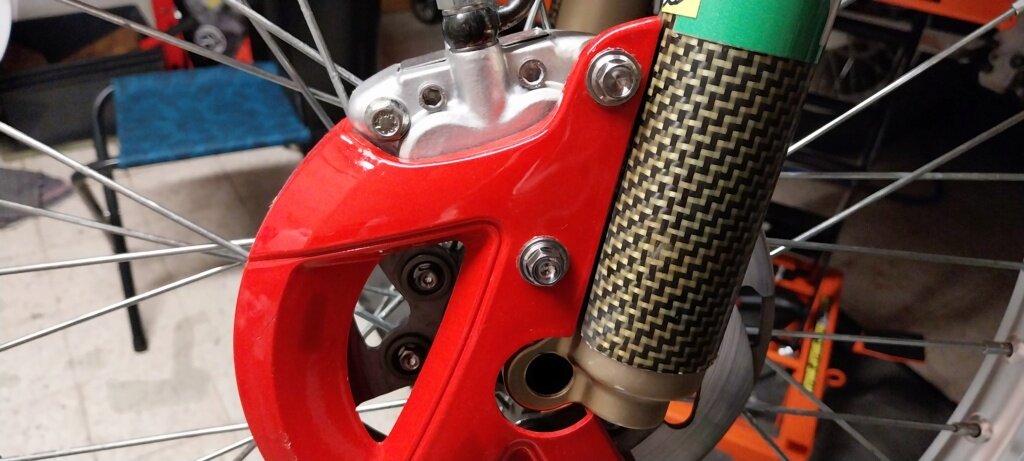

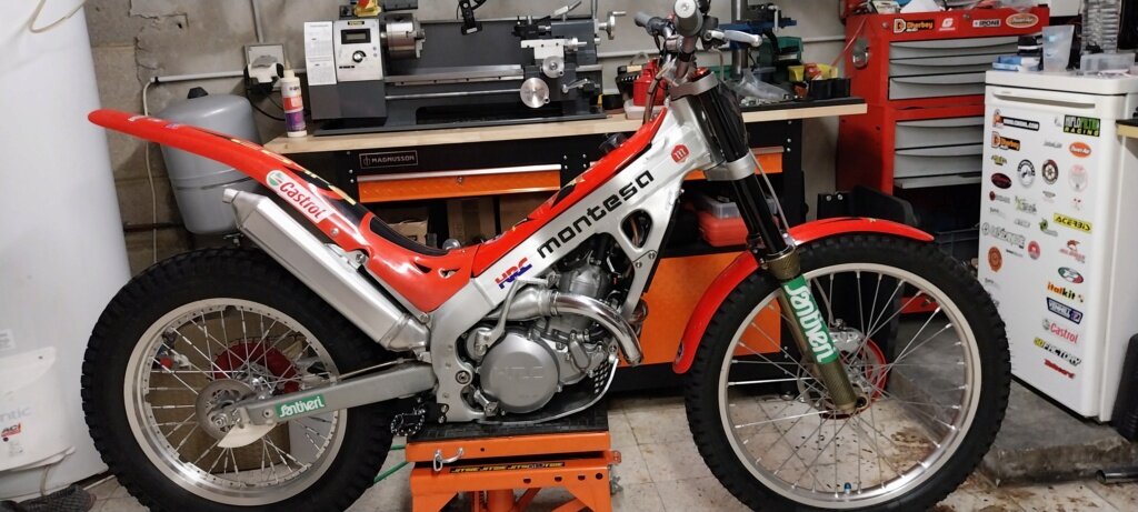

ahell Posted October 8 Author Report Share Posted October 8 keihin settings update 48/120 Rotor -10mm (around -500grs) Alloy footrest Xlight tyres Resurfacing the brake discs Dry weight : 72.9kg (stock : 77.2kg dry) Better handling, brakes, clutch, reving ... this 315R is way easier and fun ! Quote Link to comment Share on other sites More sharing options...

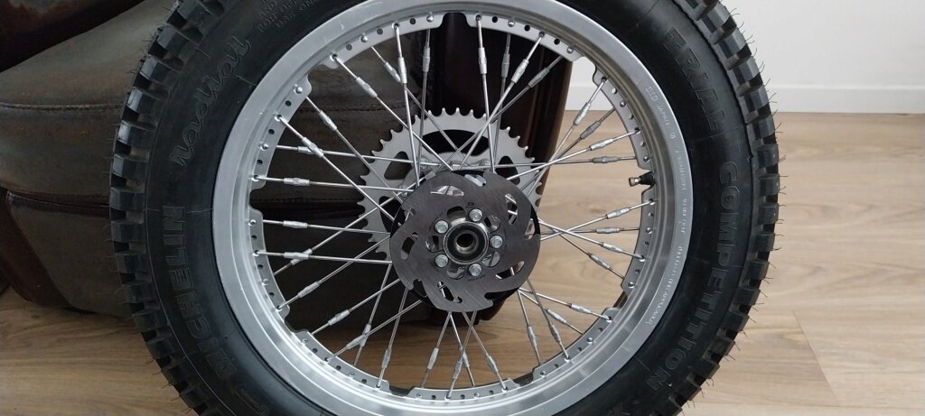

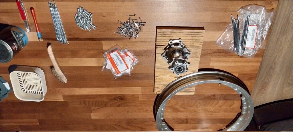

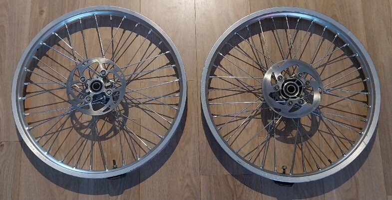

ahell Posted Tuesday at 08:20 PM Author Report Share Posted Tuesday at 08:20 PM (edited) Restoration of a pair of original 4RT 32-spoke wheels. Sandblasting, painting, and polishing of the hubs, SKF bearings. Cleaning and treatment of the spokes. Deglazing of the discs. The weight saving on the front wheel is 700 grams less than 315R wheel! Spokes nipples are aluminum, brake disc, different hub, and four fewer spokes... a significant weight reduction. Edited Tuesday at 08:39 PM by ahell Quote Link to comment Share on other sites More sharing options...

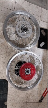

ahell Posted Wednesday at 07:12 PM Author Report Share Posted Wednesday at 07:12 PM 32 spokes rear wheel, 750grs less than 36 spokes wheel. Dry weight : 71.5kg (- 6kg) 1 Quote Link to comment Share on other sites More sharing options...
ahell Posted Thursday at 07:47 AM Author Report Share Posted Thursday at 07:47 AM 32x spokes wheels save 1.450kg ! Quote Link to comment Share on other sites More sharing options...
