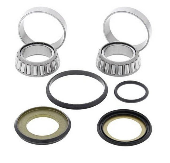

halfway Posted April 14, 2024 Author Report Share Posted April 14, 2024 Thanks folks, yes it is a common taper roller and I can get them fine from a bearing shop but having the seals to go with them would be good, which I can't find. Was hoping that a kit with seals from another bike would have the same size taper bearings and seals. Quote Link to comment Share on other sites More sharing options...
lemur Posted April 15, 2024 Report Share Posted April 15, 2024 Sealed taper bearing, good luck with that you would need to sink the bearing deep into the headstock and install a seal above and below the bearings. If your headstock has bearing seals now those too are standard items at the same store. Do you really want somebody to put those 4 items into a kit form and sell it to you at 300% markup? 1 Quote Link to comment Share on other sites More sharing options...
halfway Posted April 15, 2024 Author Report Share Posted April 15, 2024 This is a kit for a beta rr300, just can't find one for the synt. No bearing suppliers have these listed. Quote Link to comment Share on other sites More sharing options...
lemur Posted April 16, 2024 Report Share Posted April 16, 2024 You're asking the wrong questions, if you want a catalog of taper bearing seals you go to the same place you buy your bearings and ask for the bearing seal catalog. Bearing seal manufacturers include names like Timken, FAG, SKF and dozens more that you will recognize. Virtually every bearing supplier has listings for bearing seals on spec, you're just asking for the wrong thing when you ask for kits to fit a specific vehicle application. ... taper roller bearings with a seal on one side and only a grease cup on the other side is standard equipment on the majority of car, truck and trailer wheels traveling the road today. Quote Link to comment Share on other sites More sharing options...

halfway Posted April 17, 2024 Author Report Share Posted April 17, 2024 All sorted, getting the bearings was never the issue. Simply bearings have them, it was the seperate seals that I was struggling with as them I couldn't find on any bearing suppliers website, they do them for the other size tapper rollers but not the 32004. Turns out after cleaning up that there is an 'o' ring in a groove at the bottom of the head stem and a washer at the top with an 'o' ring, these were missing, they will do a fine job of sealing the head stock with new 'o' rings. Cheers all. Quote Link to comment Share on other sites More sharing options...
