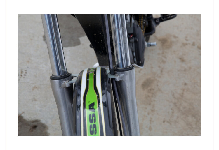

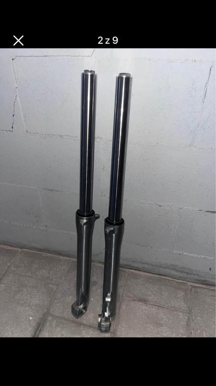

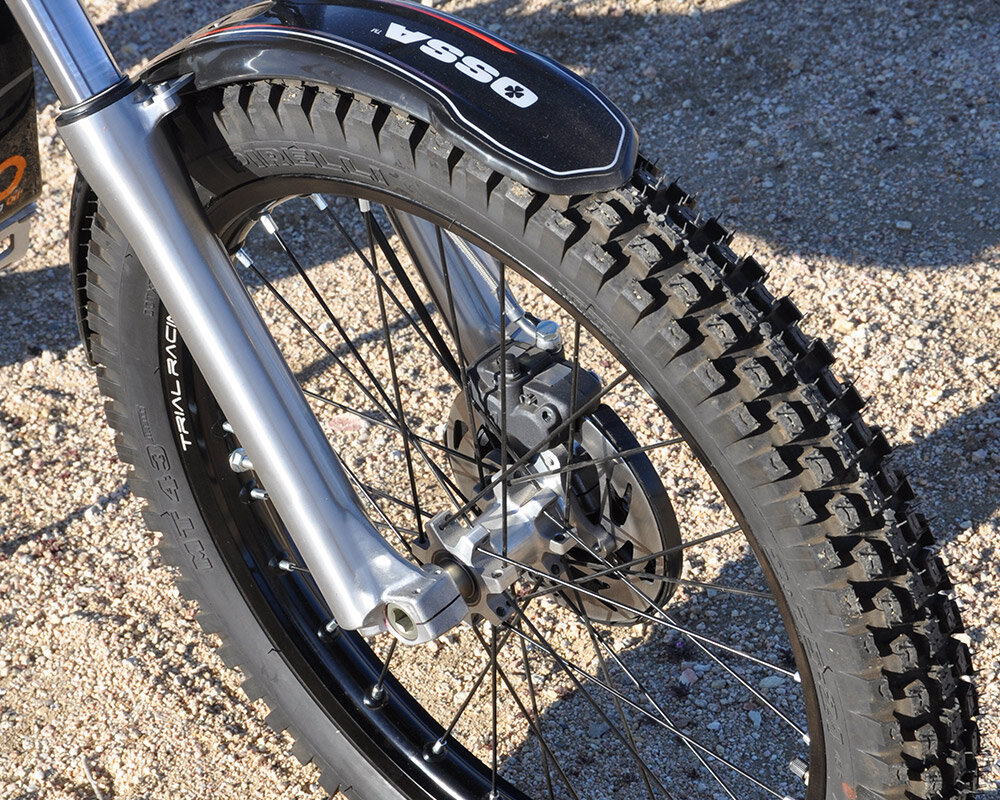

gleiwitz Posted April 14, 2024 Report Share Posted April 14, 2024 I wanted to ask if any of you know if parts from the original Marzocchi 40 mm fit into the Ossa Explorer Ollé Fornt Forks? Quote Link to comment Share on other sites More sharing options...
konrad Posted April 14, 2024 Report Share Posted April 14, 2024 Two different manufacturers. Seems unlikely to me. Post some photos of your Olle internals. What is the distance (completely unweighted) from the center of the axle to the top of the stanchion? Where would you buy Marzocchi internals anyway? A complete fork swap seems more doable. Or are you asking if the fender, caliper, and wheel will swap over? That is very likely to be a bolt-on operation.. 1 Quote Link to comment Share on other sites More sharing options...
gleiwitz Posted April 14, 2024 Author Report Share Posted April 14, 2024 I was thinking more about consumable parts such as dust or oil seal, springs, bush kit, etc I can't find information or parts anywhere and I wanted to use them in my built Fantic Mono. Quote Link to comment Share on other sites More sharing options...
konrad Posted April 14, 2024 Report Share Posted April 14, 2024 (edited) At a minimum, fork seals seem likely: https://www.splatshop.co.uk/fork-oil-seals-40x52x10mm-marzocchi-each.html Edited April 14, 2024 by konrad 1 Quote Link to comment Share on other sites More sharing options...
reggie Posted April 15, 2024 Report Share Posted April 15, 2024 I have it on good authority that the fork seals fit. 1 Quote Link to comment Share on other sites More sharing options...
gleiwitz Posted April 15, 2024 Author Report Share Posted April 15, 2024 Thank you very much. This means that there is a chance that basic service can be carried out using them. Thanks to this, I will be able to use them in my fantic project. I don't have high expectations for them. after service, they should fulfill their purpose. Quote Link to comment Share on other sites More sharing options...
