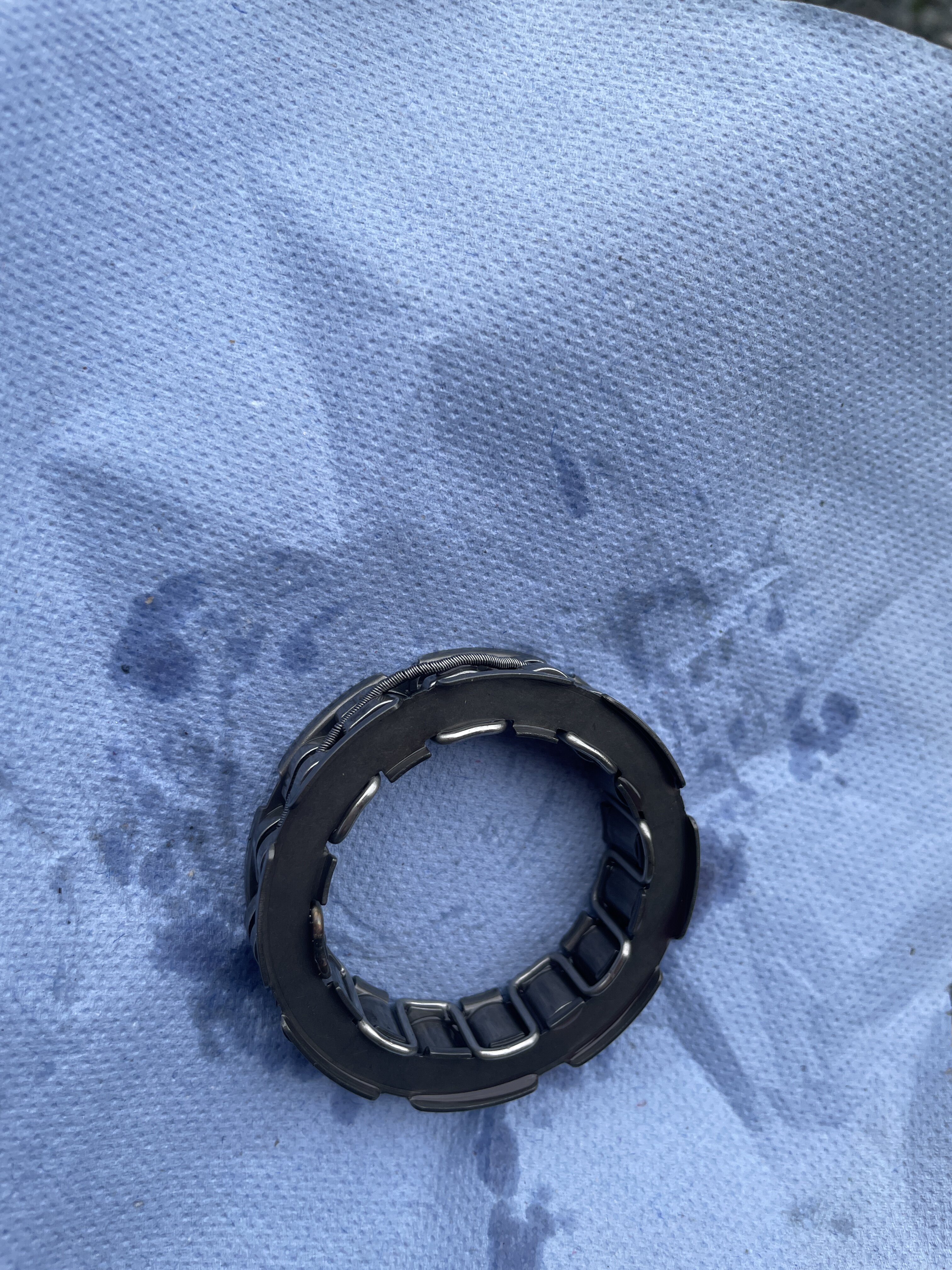

trevbul1 Posted May 2, 2024 Author Report Share Posted May 2, 2024 Update on my post re my TRS starter mechanism making a loud knock as it comes to a stop. Forum advice (thank you, everybody!) suggested replacing the sprag (non-return/ freewheel) bearing which was supplied promptly by Steve Saunders SXS in Gloucestershire. The fault which develops is that the spring holding the pawls in the race stretches. A great shame that this design has not been improved and also that you cannot buy just the spring – the bearing and pawls are still perfect with no sign of wear or stress. However what was not mentioned in the advice was that two of the pawls escaped from the bearing race whilst in transit and my ageing eyesight failed to detect that each pawl has striations on the outer surface that all need to face in the same direction – otherwise the bearing will grip in both directions, where it should only grip when rotated anti-clockwise. It took my son-in-law’s keen eyes to spot my error and it would have been a lot easier had I known what to look for in the first place. Hope this post might help somebody else in the future. Quote Link to comment Share on other sites More sharing options...

bigfoot Posted May 8, 2024 Report Share Posted May 8, 2024 My bike started to make a clunking stop rather than the usual whiz a few months ago and finally started to make horrible noises trying to start. Traced it to the free wheel bearing an mentioned above. The bearing was in good condition but the spring had stretched. Simple fix. Take the side case off, undo the centre bolt and pull the starter gear out and it's there. No need to remove the flywheel. 10 minute job. £40 for the replacement but it would be easy to just change the spring if you can get it. It's the same sort of spring as used in bearing seals but without knowing the original length it could be difficult to get it right. If your bike starts clunking on stopping I'd suggest replaceming before it gets worse. No sign of an other damage on mine but you never know, it could damage the other bearing surfaces. Quote Link to comment Share on other sites More sharing options...
