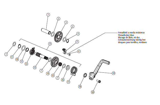

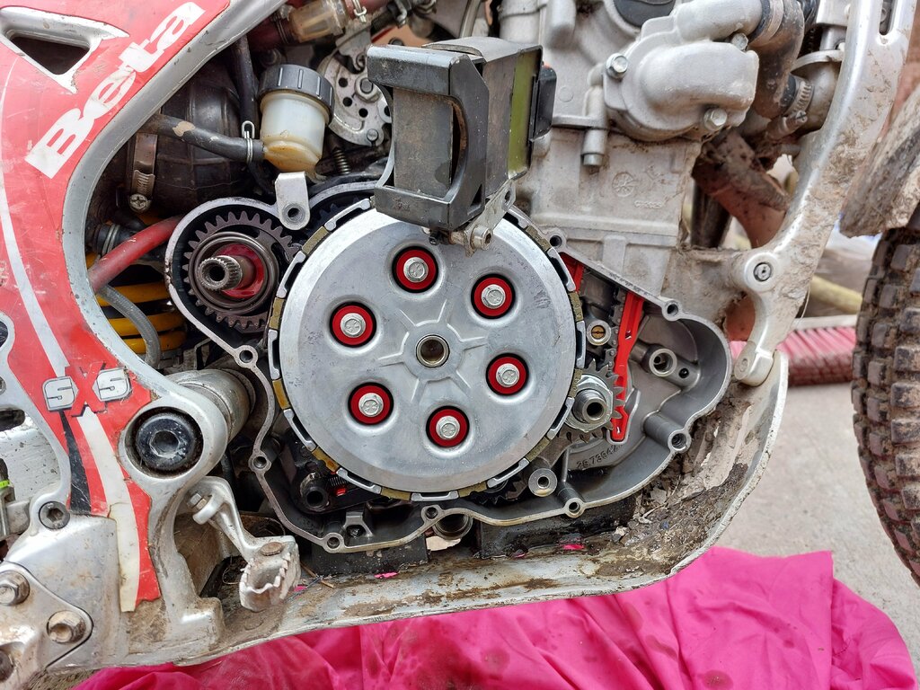

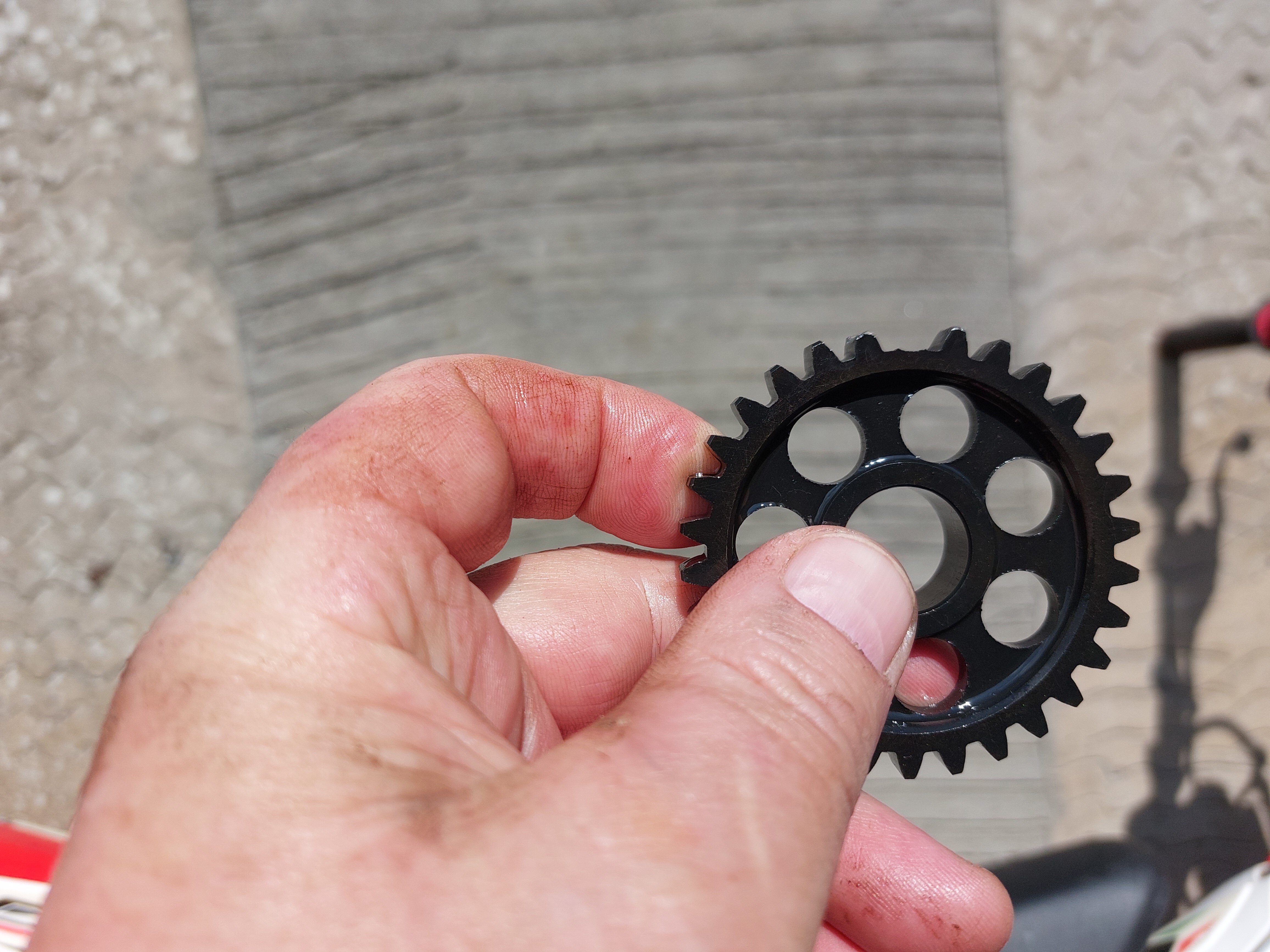

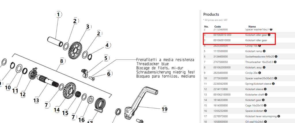

scratcher Posted April 28, 2024 Report Share Posted April 28, 2024 hey guys, is the idle gear for a evo 4t 2009 different to a 2t. im trying to locate one if anyone knows any for sale..its for my 300 4t Quote Link to comment Share on other sites More sharing options...
reggie Posted April 28, 2024 Report Share Posted April 28, 2024 Do you mean kick start idler gear ? FYI there are not a lot of engine parts shared between the Evo 4t and Evo 2t Quote Link to comment Share on other sites More sharing options...
scratcher Posted April 28, 2024 Author Report Share Posted April 28, 2024 its not the gear on kickstarter...its the gear it turns 1 Quote Link to comment Share on other sites More sharing options...

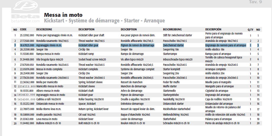

chris morris Posted April 29, 2024 Report Share Posted April 29, 2024 old 4t manual says 18.67825.000, but part finder says use 001060010000 Quote Link to comment Share on other sites More sharing options...
scratcher Posted April 29, 2024 Author Report Share Posted April 29, 2024 chris...i contacted beta uk today, an the told me same part but part numbers changed..i ordered it.. Quote Link to comment Share on other sites More sharing options...

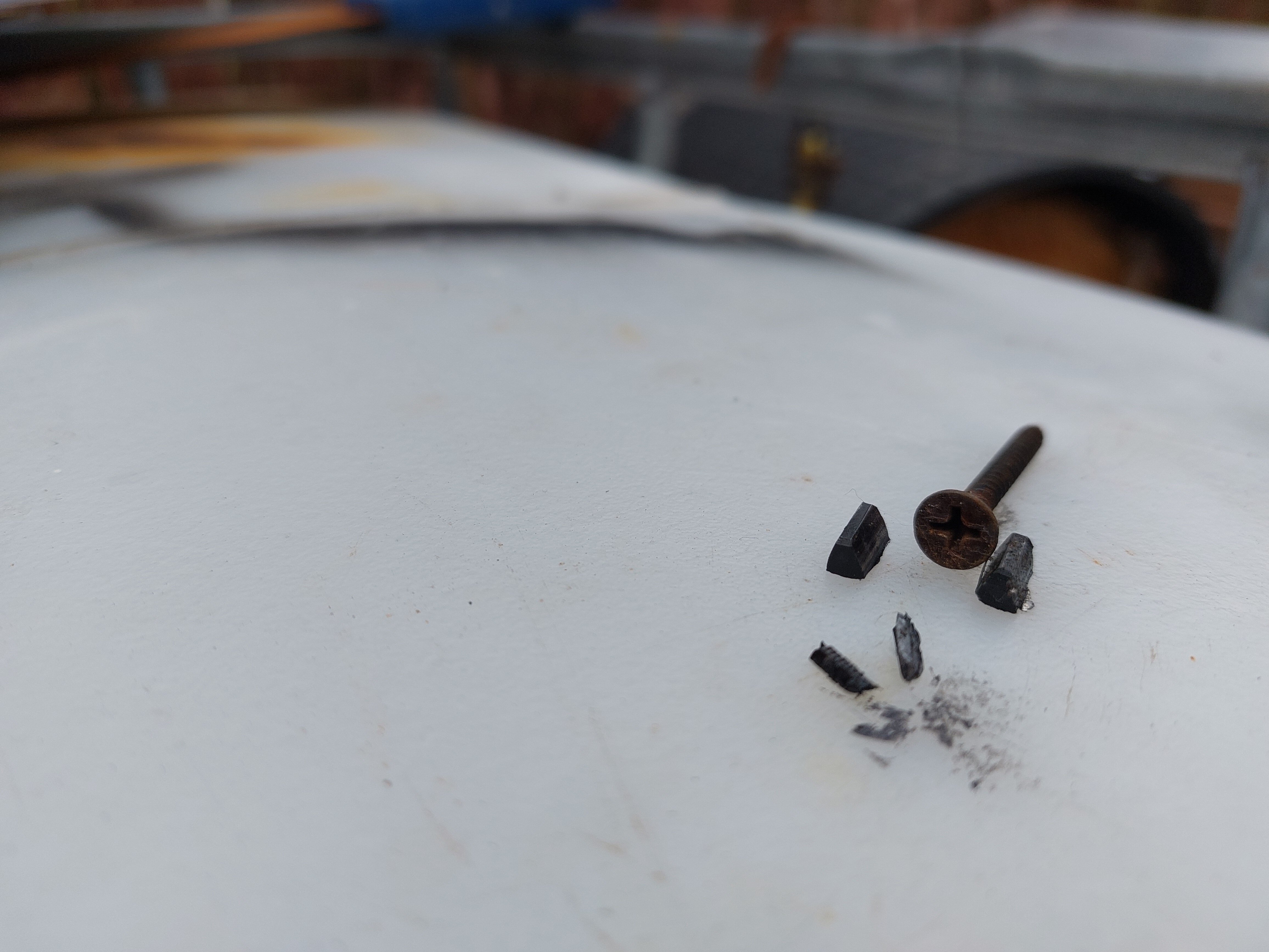

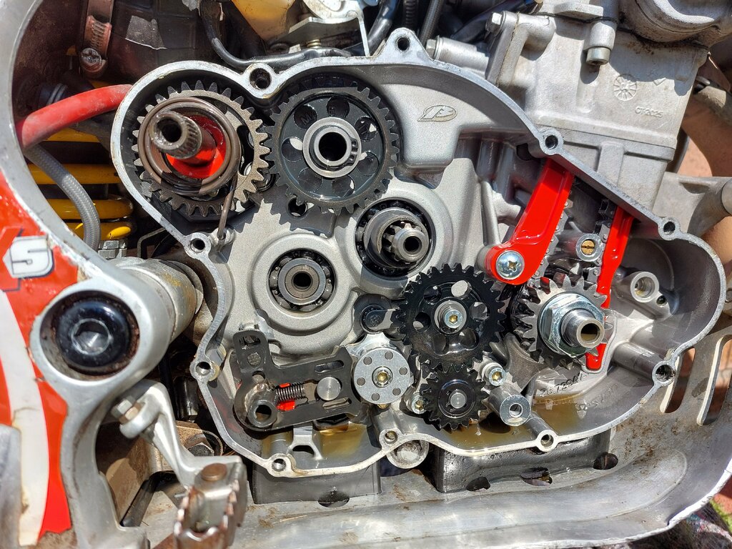

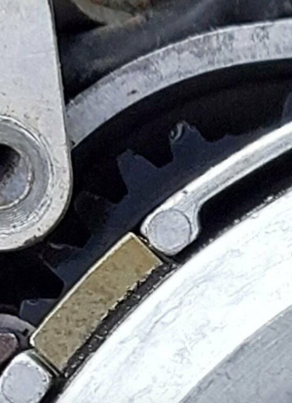

scratcher Posted May 1, 2024 Author Report Share Posted May 1, 2024 hopefully this is the culprit Quote Link to comment Share on other sites More sharing options...

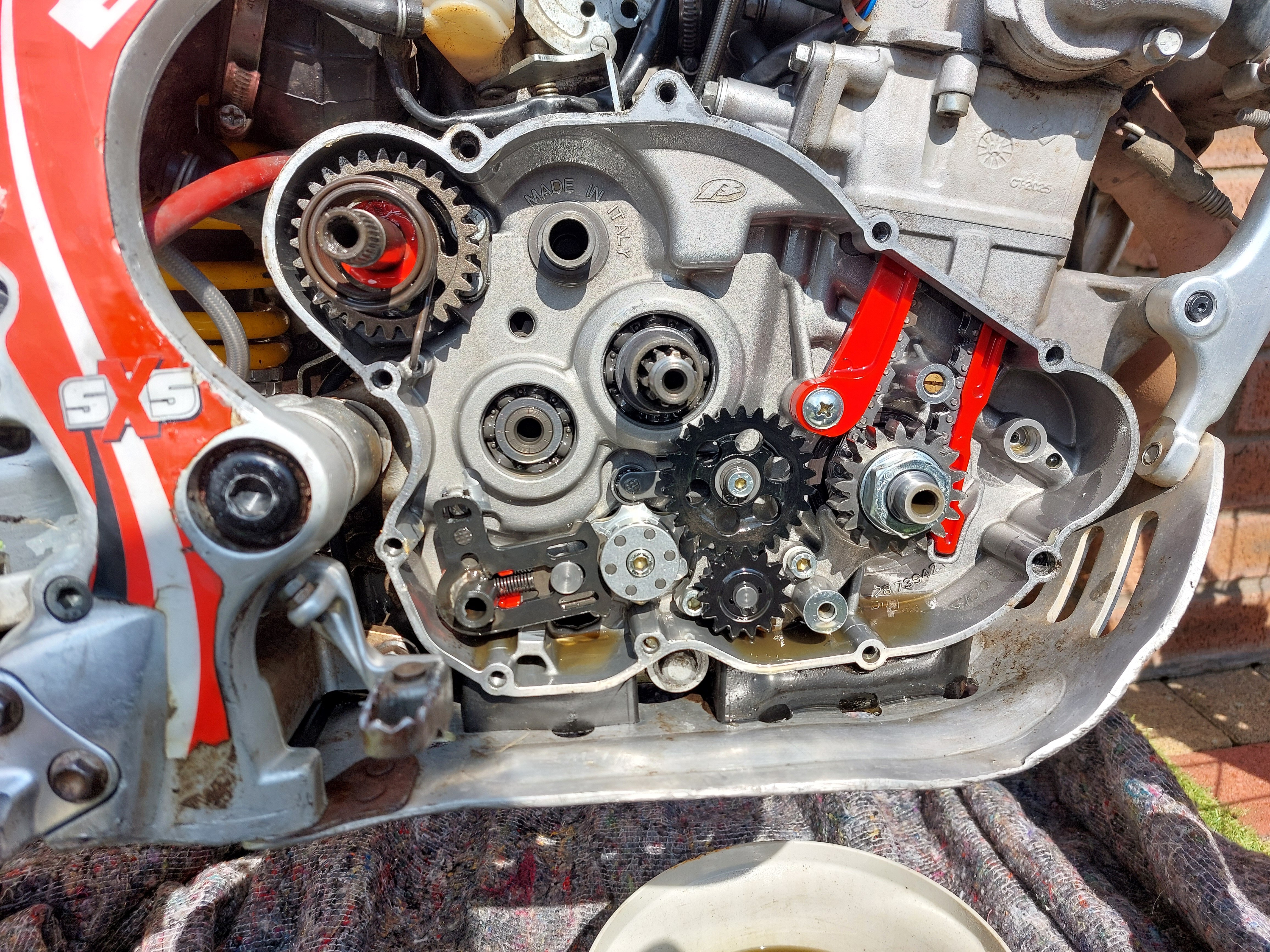

scratcher Posted May 1, 2024 Author Report Share Posted May 1, 2024 Quote Link to comment Share on other sites More sharing options...
