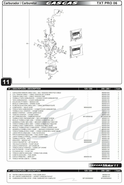

thesaint Posted May 7, 2024 Report Share Posted May 7, 2024 I have an 2005 Gas Gas TXT 125 Pro that i have been standing since 2017 without being started. I tried to start the bike today but it would not start. The first thing i did was to check the for spark (which is okay) After that i took off the airfilter box and rear fender. I found an old hand pump spray bottle which i poored gasoline with 3% oil mixture in thinking of spraying fuel in to the carburettor. I am aware that it is supposed to be 2% but since the bike have not been started for a long time i decided to use 3% oil mixture. So the first time i tried to start the bike i sprayed in 2 spray pumps with fuel from the the spray bottle. This was enough that the biked was about to start but stopped. On the second try i sprayed in 6 or 7 pumps of fuel using the spray bottle and the bike started really easy and ran for a little over 10 seconds before it stopped. I wonder if the settings both for the air/fuel mixture is wrong after i had the carburettor apart? I hope that some here on the forum can help me with the standard settings for the fuel/air mixture and also the standard setting for the idle screw. I seem to remember that the air/fuel mixture is to screw the air/fuel mixture all the way in and the turn it back out about 1 and 1/2 turn back but i want to check that for sure so i hope some here on the forum can help me out. When i use the hand pump and spray in about 7 pumps of fuel the bike runs great for about 10 seconds before it stops. So this is a fuel issue. Since i do not remember for sure which of the screws on the picture of the carburettor is the fuel/air mixture screw and which is the idle screw? See the picture below where i have marked what i think is the fuel/air screw with a yellow arrow and what i think is the idle screw with a red arrow. Quote Link to comment Share on other sites More sharing options...

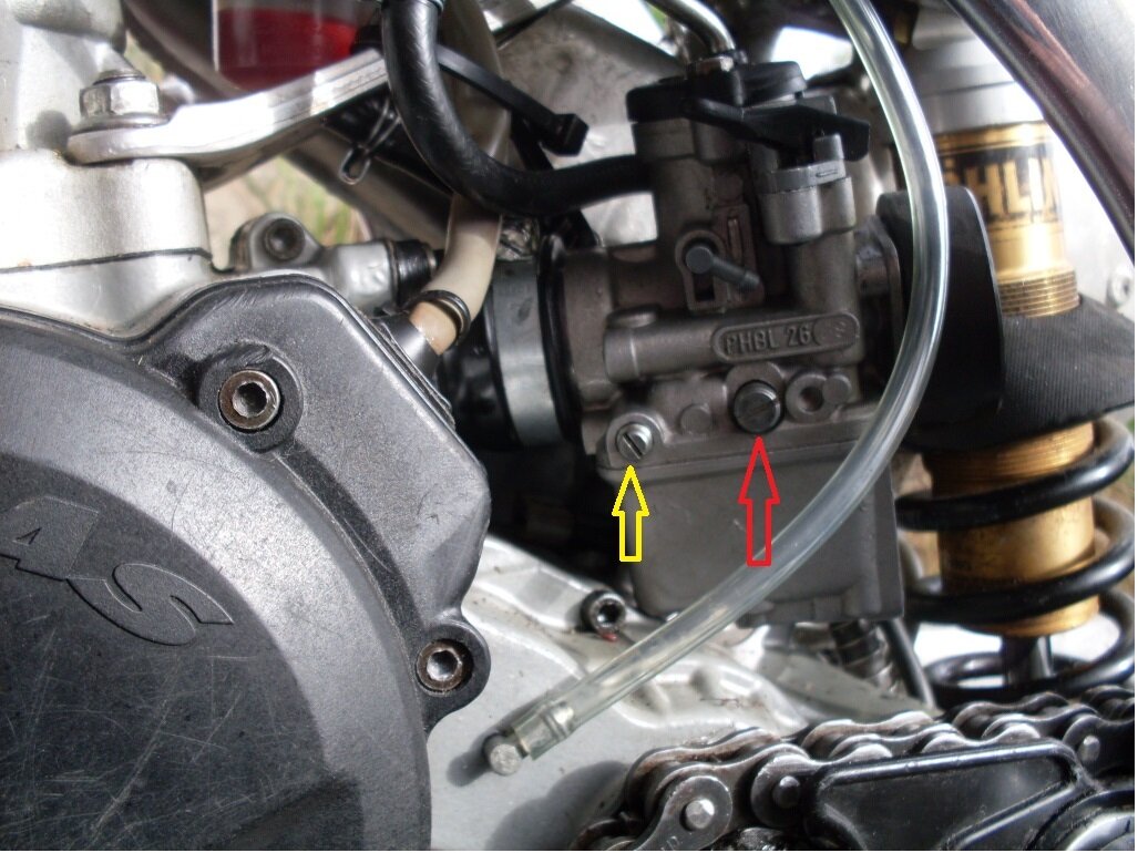

konrad Posted May 7, 2024 Report Share Posted May 7, 2024 Your colored arrows are correct. Dellorto PHBL 26 mixture screw is typically about 4 turns out from fully seated. The pilot jet (and possibly starter jet too) is plugged from sitting for years with old premix. Usually, spray carb cleaner is insufficient. You need to clean the jet by passing a fine wire through the orifice. But the diameter is critical, so I use pin gauges for that job. Some people are uncomfortable using that method and should replace the jet(s) instead. Quote Link to comment Share on other sites More sharing options...

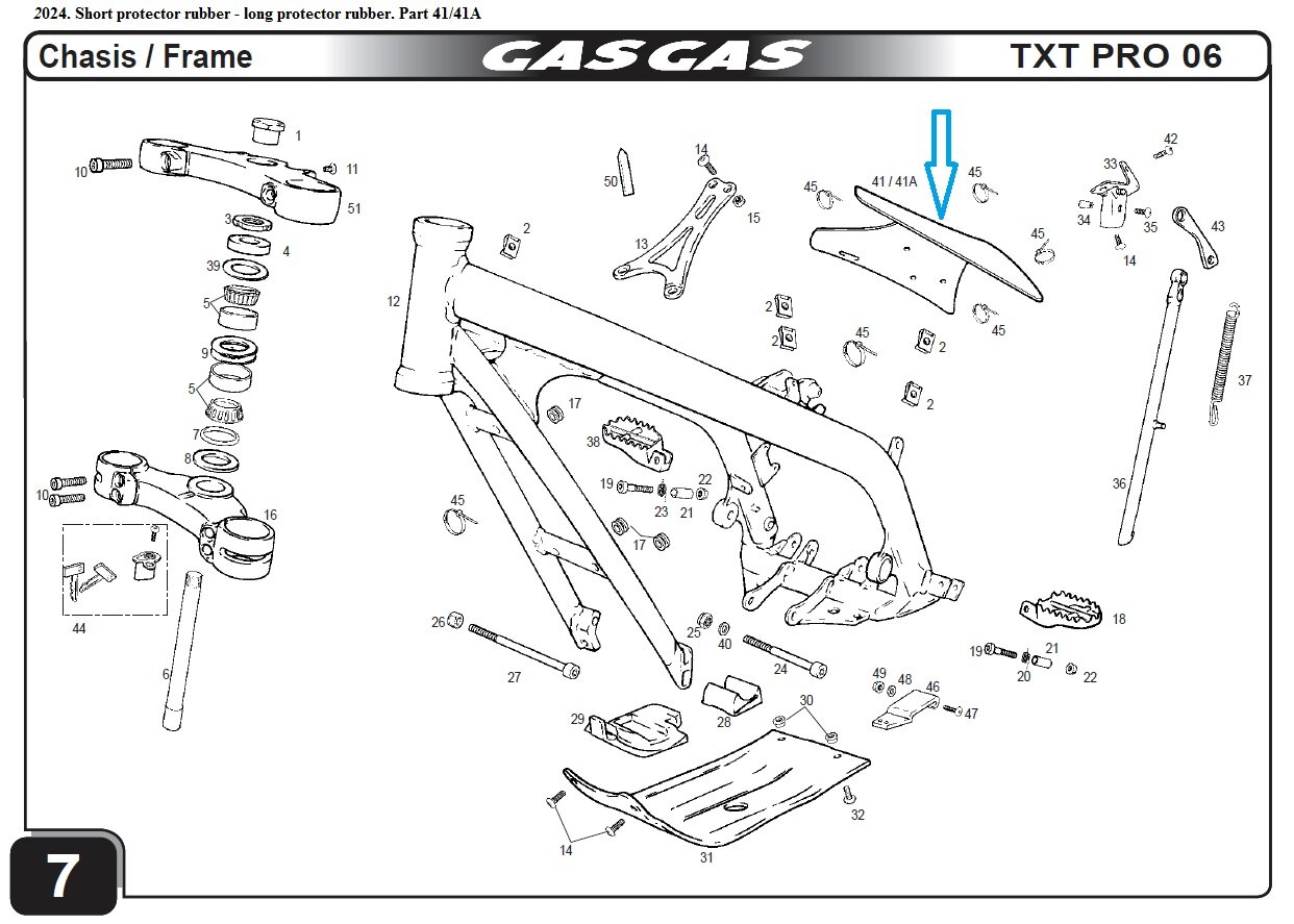

thesaint Posted May 9, 2024 Author Report Share Posted May 9, 2024 On my TXT 125 Pro the protector rubber is not on the bike. I ordered the part some time ago so i have it on the shelf so i will put it on the bike. I just put it on the bike where it is supposed to sit and to me it does not look to protect much i have to say. It is part 41/41A on the picture below. Also shown with a blue arrow. Quote Link to comment Share on other sites More sharing options...
thesaint Posted May 10, 2024 Author Report Share Posted May 10, 2024 (edited) On 5/7/2024 at 11:10 PM, konrad said: Your colored arrows are correct. Dellorto PHBL 26 mixture screw is typically about 4 turns out from fully seated. The pilot jet (and possibly starter jet too) is plugged from sitting for years with old premix. Usually, spray carb cleaner is insufficient. You need to clean the jet by passing a fine wire through the orifice. But the diameter is critical, so I use pin gauges for that job. Some people are uncomfortable using that method and should replace the jet(s) instead. I just noticed first now that you wrote that the mixture setting for the fuel/air screw is 4 turns out. Is that not much? Before i tried to start the bike i had the setting on 1 and 1/2 turn out and after i started the bike i opened the fuel/air screw a little more so on my bike it is almost 2 rounds out now. The bike runs great but should i try to open up more? The pilot jet was and is open and in perfect order on my bike. I would not mind having the bike going slower so i do not know if i can tell if i put on a 9 tooth front sprocket front and 48 tooth rear sprocket? I think the front sprocket is a 8 tooth and the rear sprocket is a 42 tooth. Something tells me i will not notice any big difference with a a 9 tooth front sprocket front and 48 tooth rear sprocket Edited May 11, 2024 by thesaint Quote Link to comment Share on other sites More sharing options...

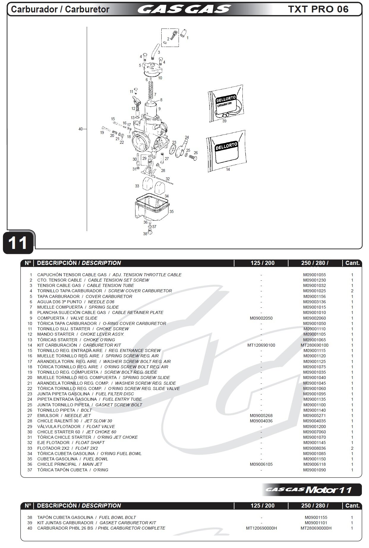

lemur Posted May 10, 2024 Report Share Posted May 10, 2024 "almost 2 rounds out" <- sounds much closer to a conventional carburetor setting 👍 if it works there leave it. Pretty sure the low speed adjuster screw on a Dellorto controls fuel and on most other carbs it controls air so you might find adjustment alters the engine opposite to what you might expect. I think as you turn the screw out you are enriching the fuel mixture on a Dellorto. What do they label part #27 & part # 30 on your diagram? Those look more like the emulsion tube that I refer to as being most critical to clean after being subjected to fuel evaporation. Variations on the name 'emulsion tube' are atomizer or pulverizer tube depending on the documentations original language. Quote Link to comment Share on other sites More sharing options...

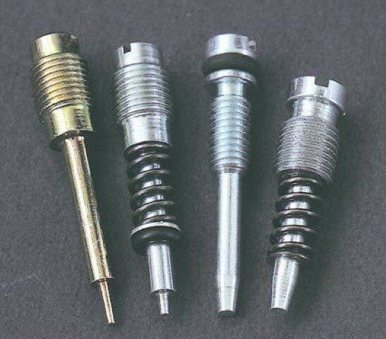

konrad Posted May 10, 2024 Report Share Posted May 10, 2024 (edited) 12 hours ago, thesaint said: I just noticed first now tha you wrote that the mixture setting for the fuel/air screw is 4 turns out. Is that not much? Before i tried to start the bike i had the setting on 1 and 1/2 turn out and after i started the bike i opened the fuel/air screw a little more so on my bike it is almost 2 riounds out now. The bike runs great but should i try to open up more? The Dellorto is unlike a Japanese 2T carb (where 1.5 turn out is the normal starting point). Despite being on the engine side of the slide, the Dellorto's mixture screw controls fuel (out is richer). For the Dellorto, 3 to 4 turns out is typical. If it runs best at 2 turns out, that's fine. But don't be afraid to experiment with the mixture screw (just remember that the spring needs to be somewhat compressed to ensure the screw does not vibrate loose and fall out.) Most manufactures have a procedure for setting the mixture screw that optimizes idle smoothness or minimizes idle emissions. I set the mixture screw for best performance just off idle. Attached a pic for reference. Mixture screws on the right left are for fuel, mixture screws on the left right are for air. Edited May 11, 2024 by konrad 1 Quote Link to comment Share on other sites More sharing options...
thesaint Posted May 11, 2024 Author Report Share Posted May 11, 2024 (edited) 22 hours ago, lemur said: "almost 2 rounds out" <- sounds much closer to a conventional carburetor setting 👍 if it works there leave it. Pretty sure the low speed adjuster screw on a Dellorto controls fuel and on most other carbs it controls air so you might find adjustment alters the engine opposite to what you might expect. I think as you turn the screw out you are enriching the fuel mixture on a Dellorto. What do they label part #27 & part # 30 on your diagram? Those look more like the emulsion tube that I refer to as being most critical to clean after being subjected to fuel evaporation. Variations on the name 'emulsion tube' are atomizer or pulverizer tube depending on the documentations original language. According to the parts diagram part 27 is needle slow and part 28 is Jet slow 30. Below is a drwaing of the carburetor and the parts list When you open the drawing in a new window you can enlarge it and easy see the parts Edited May 11, 2024 by thesaint Quote Link to comment Share on other sites More sharing options...
thesaint Posted May 11, 2024 Author Report Share Posted May 11, 2024 (edited) 21 hours ago, konrad said: The Dellorto is unlike a Japanese 2T carb (where 1.5 turn out is the normal starting point). Despite being on the engine side of the slide, the Dellorto's mixture screw controls fuel (out is richer). For the Dellorto, 3 to 4 turns out is typical. If it runs best at 2 turns out, that's fine. But don't be afraid to experiment with the mixture screw (just remember that the spring needs to be somewhat compressed to ensure the screw does not vibrate loose and fall out.) Most manufactures have a procedure for setting the mixture screw that optimizes idle smoothness or minimizes idle emissions. I set the mixture screw for best performance just off idle. Attached a pic for reference. Mixture screws on the right left are for fuel, mixture screws on the left right are for air. Thanks for posting the picture and the help 😊😊 The fuel/air mixture screw i have on the bike is the one to the right without the spring (Screw number 3 from the left) The fuel/air mixture on my bike is turned out 2 turns as the bike is today (it runs great) But i will turn the out the fuel/air screw close to 2 more tuns out so it will be 4 turns out from fully closed and check how that works 😊 You are absolute correct about screws can vibrate loose and fall off so i usually checks that. I have to say that when i check for loose screws i have never checked any adjustemnt screws on the carburator. Update! I have adjusted the fuel/air screw from fully in to a little over 3 turns out. With the fuel/air screwed out a little over 3 turns compared to 2 rounds out it used to be i can not tell any difference of the mixtture settings. When adjusted the fuel/air screw out 4 turns the screw feels a little to loose so for my liking. I think that there is a chance the fuel/air screw can vibrate loose. Anyway the bikes runs great with the fuel/air mixture screw adjusted out a little over 3 turns out from fully closed. The bike starts really easy both cold using the choke and warm with a little throttle with this mixture setting. Edited May 11, 2024 by thesaint Quote Link to comment Share on other sites More sharing options...
lemur Posted May 13, 2024 Report Share Posted May 13, 2024 On 5/11/2024 at 11:52 AM, thesaint said: According to the parts diagram part 27 is needle slow and part 28 is Jet slow 30. Below is a drwaing of the carburetor and the parts list When you open the drawing in a new window you can enlarge it and easy see the parts It says part #27 is the Emulsor for the needle jet. That's the part that will need the most attention. Quote Link to comment Share on other sites More sharing options...
thesaint Posted May 13, 2024 Author Report Share Posted May 13, 2024 14 hours ago, lemur said: It says part #27 is the Emulsor for the needle jet. That's the part that will need the most attention. Thanks for letting me know 👍 👍 I was not aware of that. Quote Link to comment Share on other sites More sharing options...
lemur Posted May 13, 2024 Report Share Posted May 13, 2024 The job of the emulsion tube is to initiate the process of atomizing liquid fuel (and pre-mix lubricant) into the air intake stream, this is the part that makes your float level critical, the top half of the emulsion tube is to remain above the float bowl fuel level and the bottom half of that tube is submerged, emulsion tube is where air bubbles are introduced into the upward fuel flow, iIt will typically have a series of carefully placed tiny holes in the sides of a brass tube to introduce the air and those are the passages most likely to become plugged. If the emulsion tube does not work you get raw fuel or no fuel getting dumped into the carburetor instead of a fine mist spray. The whole assembly is similar to a fly sprayer or a perfume spray bottle or the nozzle on a can of spray paint fed by a toilet tank float valve. Quote Link to comment Share on other sites More sharing options...

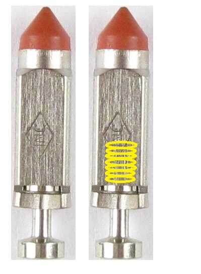

thesaint Posted May 15, 2024 Author Report Share Posted May 15, 2024 (edited) Jus back home from the post office after getting the new float valve/needle in the mail for my TXT Pro. When looking at the picture of the spring loaded needle i still think that if you take out/off the spring for the needle will not make any diffence at all since the needle will go up and shut off the fuel when the float chamber is full just as easy (if not more easy) without the spring. The spring loaded needle sit on the carburetor just like it is shown on the picture so what the spring does is to push the needle down towards floats You can see where i have tried to draw a yellow spring Edited May 18, 2024 by thesaint Quote Link to comment Share on other sites More sharing options...
