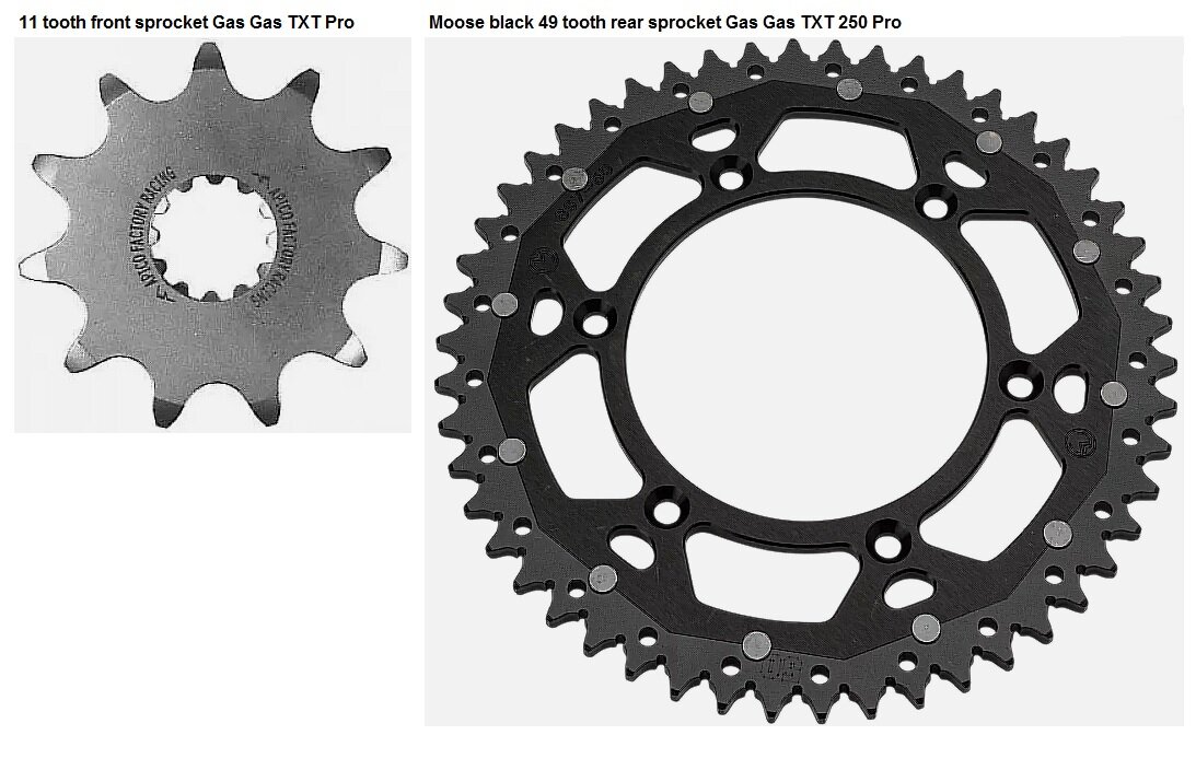

thesaint Posted May 13, 2024 Report Share Posted May 13, 2024 (edited) On my Gas Gas TXT 125 Pro i have a 9 tooth front sprocket (if i counted it correct) and what i think is a 46 rear sprocket. If i go for a 11 tooth front sprocket and a 49 tooth rear sprocket will i notice any differnce? I must say that i have a feeling that i will not notice any special differnce if i replace the front 9 tooth and rear 46 tooth sprockets with 11 t and 49 t sprockets or am i wrong? Edited May 13, 2024 by thesaint Quote Link to comment Share on other sites More sharing options...
faussy Posted May 13, 2024 Report Share Posted May 13, 2024 (edited) Thats a big enough change. Its also making it higher geared, for a 125 that may no be the thing. Are you trying to make 1st taller? I think 9/48 was the hot setup back then for 125s Edited May 13, 2024 by faussy Quote Link to comment Share on other sites More sharing options...
konrad Posted May 13, 2024 Report Share Posted May 13, 2024 46/9 = 5.11 49/11 = 4.45 46/9 yields a higher gear reduction ratio than 49/11. 46/9 will yield more driving force at the rear wheel than 49/11 (for the same engine speed). 49/11 will yield higher ground speed than 46/9 (for the same engine speed). Those sprocket combinations are nearly 15% different -- that will produce a very noticeable change. 1 Quote Link to comment Share on other sites More sharing options...
thesaint Posted May 13, 2024 Author Report Share Posted May 13, 2024 (edited) 2 hours ago, konrad said: 46/9 = 5.11 49/11 = 4.45 46/9 yields a higher gear reduction ratio than 49/11. 46/9 will yield more driving force at the rear wheel than 49/11 (for the same engine speed). 49/11 will yield higher ground speed than 46/9 (for the same engine speed). Those sprocket combinations are nearly 15% different -- that will produce a very noticeable change. I might try it if it will produce a noticeable change 😊 😊 If it is not the "big" thing on the 2005 TXT 125 Pro i can use the sprockets on my TXT 250 Pro Edited May 13, 2024 by thesaint Quote Link to comment Share on other sites More sharing options...
