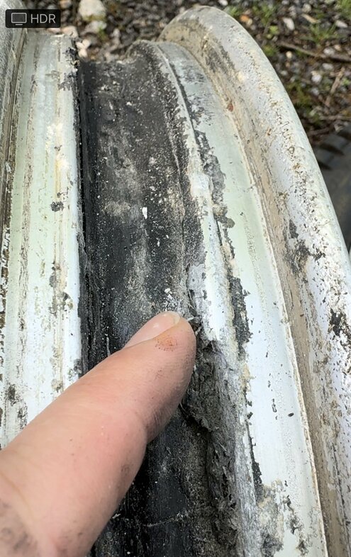

nitjay - hrc Posted May 23, 2024 Author Report Share Posted May 23, 2024 Thanks all for the input - got a few options to try. Also this is the other rim - I assume it needs new rim tape, I’ve heard they are a pain to get right. You can also see corrosion - If it’s too far gone I could use this as a tubed option? Quote Link to comment Share on other sites More sharing options...
lemur Posted May 23, 2024 Report Share Posted May 23, 2024 How long was it in the ocean? 3 Quote Link to comment Share on other sites More sharing options...
