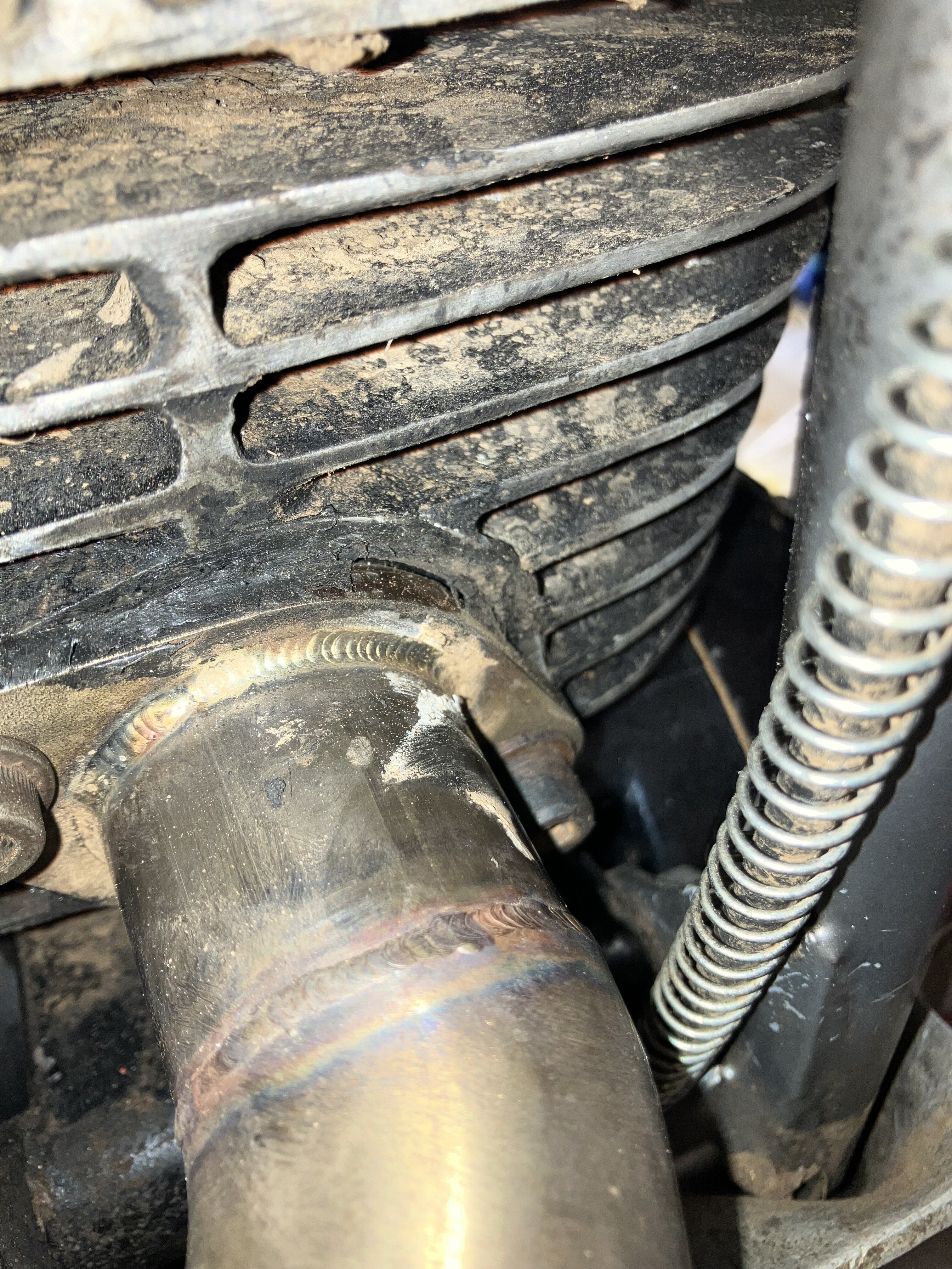

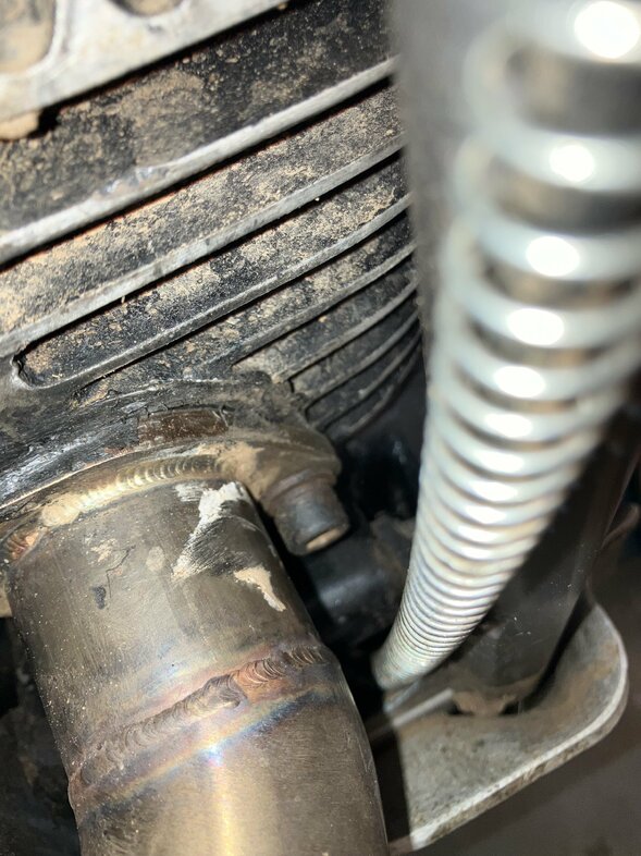

Dodgeym Posted May 26, 2024 Author Report Share Posted May 26, 2024 Hi feetupfun many thanks for your response. This came with the bike & there is a slight gap where exhaust flange isn’t sealing against barrel, not great photos but looks like due to exhaust flange not being able to rotate it doesn’t seal properly. Next question is what would be the best solution for this? Spoiler Quote Link to comment Share on other sites More sharing options...

feetupfun Posted May 26, 2024 Report Share Posted May 26, 2024 2 hours ago, Dodgeym said: Hi feetupfun many thanks for your response. This came with the bike & there is a slight gap where exhaust flange isn’t sealing against barrel, not great photos but looks like due to exhaust flange not being able to rotate it doesn’t seal properly. Next question is what would be the best solution for this? Reveal hidden contents Maybe the header pipe is bent. There is meant to be a metal crush sealing ring in there to seal against the flange. The flange needs to be quite close to being parallel with the mating surface for this sealing ring to work. When these header pipes are being fitted new, the first thing to do is fit the header pipe up fully to the cylinder then make whatever changes are needed to get things to fit. I remember fitting a header pipe that looks a lot like yours and had to reshape the header pipe (heating it with an oxy torch) to get the rear end of the header pipe in the right spot to fit to the front end of a WES mid box. Quote Link to comment Share on other sites More sharing options...
