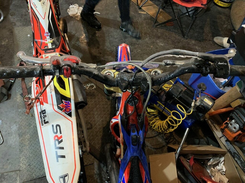

lemur Posted June 4, 2024 Report Share Posted June 4, 2024 Some days nothing seems to want to work good Quote Link to comment Share on other sites More sharing options...
