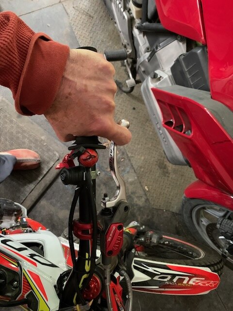

betaflaxton Posted June 7, 2024 Report Share Posted June 7, 2024 Hello again and thank you all for your replies Okay firstly it's takes a bit getting used to riding with one finger always on the clutch lever which means I tend to crush the remaining Fingers around the grip when pulling in on the lever , and wondering how much slippage I should have when clutch lever is fully pulled in and touching fingers on the grip With most motorcycle you want no slippage with the clutch when fully released but with trials you are riding most times with slippage ,so should I be able to select neutral with fingers on grip or should it only be possible when I remove fingers and pull lever all the way until it hits the grip, and should the lever be the same angle as my forearm, thanks , Probably didn't make this as clear as I should have Quote Link to comment Share on other sites More sharing options...
lemur Posted June 7, 2024 Report Share Posted June 7, 2024 On 6/7/2024 at 5:45 AM, betaflaxton said: Hello again and thank you all for your replies Okay firstly it's takes a bit getting used to riding with one finger always on the clutch lever which means I tend to crush the remaining ... Expand I solve that problem with shorty levers and by moving the lever mounts way far in on the handlebars. There is only enough room on the lever for one finger so the lever can never crush the remaining 3 fingers and you are operating with the index finger near the outmost end of the lever giving you the best possible purchase and power to operate the lever comfortably. Clutch friction range should be where your index finger can operate easiest and not give you arm cramps. If your index finger needs to extend too much to fully engage the clutch then you will get arm pump fast so set up of the levers is very dependent on the size of your particular hand. Quote Link to comment Share on other sites More sharing options...
lemur Posted June 7, 2024 Report Share Posted June 7, 2024 On 6/7/2024 at 5:45 AM, betaflaxton said: ... and should the lever be the same angle as my forearm ... Expand No the levers should be roughly 20 degrees down from horizontal. If you tilt the levers too far downwards you won't be able to reach them on steep down grades. Quote Link to comment Share on other sites More sharing options...
lineaway Posted June 7, 2024 Report Share Posted June 7, 2024 The bite point should be farther out. The lever should never touch your other fingers. You never mentioned what your riding? Quote Link to comment Share on other sites More sharing options...
