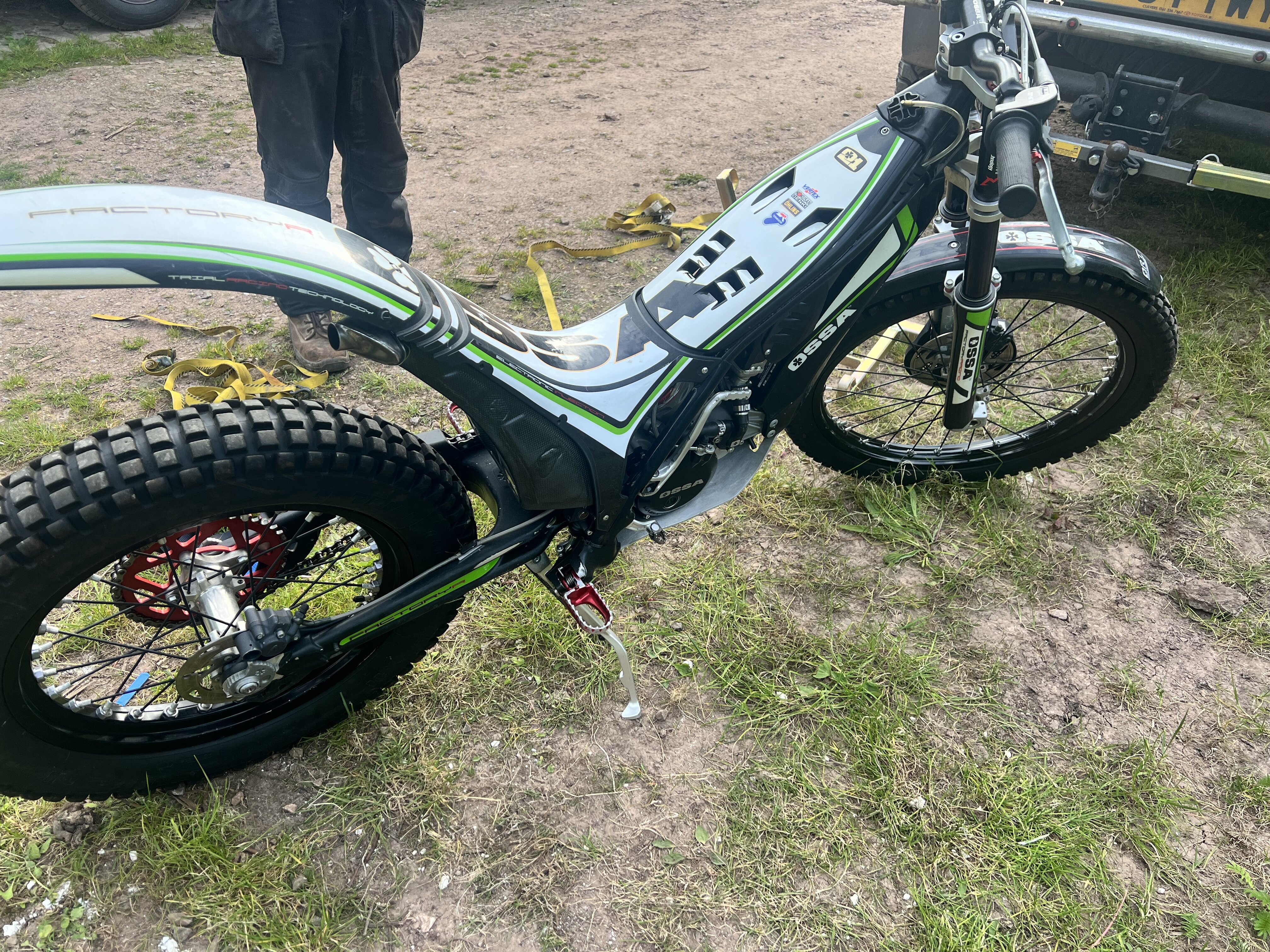

Just bought a 2014 TR280i with an explorer conversion kit
1) how do you connect the explorer tank to fuel system
2)  does anyone have the part number for the easy start system as the one supplied doesn’t look correct ?
thanks

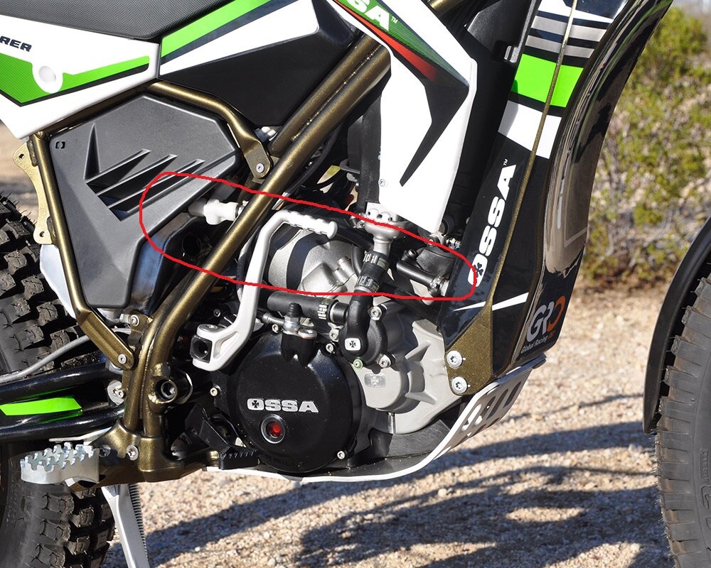

Part number for the Easy Start system is 1160030214.  There were at least two different versions of the printed circuit board manufactured, but the changes were nothing a typical rider would care about.
More information here: https://www.ossa-efi.com/home/electrics/easy-start
P.S.That's cool to convert the trials model into an Explorer as you'll have the superior suspension components.
