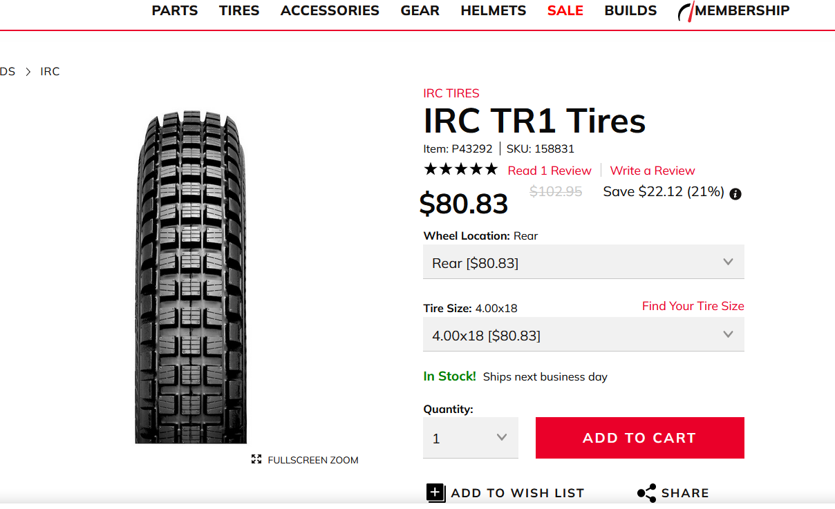

johnnyjazz Posted Sunday at 10:21 AM Author Report Share Posted Sunday at 10:21 AM (edited) Thank you so much for input B40rt! before i get to spring weight ....im not sure if i need 390 or 400mm? seems both work, is one better? - not that it would really make any difference to my terrible riding!...although the wife said i 'looked cool' so i im sure with new springs i might be allowed back in the house so its a very important decision.. currently has maxxis trial master tires which have the knobby bits almost falling off, prevous owner swapped the originals i believe for old ones off his beta or ktm or something... i think this is more of a trail tire too.. im just looking for a good all round DOT tire that will be good for pretending to do trials in the woods - think clubman class, C lines etc...nothing impressive...but handle 35mph on the road for 25% to get to spots...The previous suggestion of a Matis tire seems hard to locate here... would the IRC T1 be an ok cheap choice? i see the T11 is the better one but the T1 is DOT... And, having puttered around the yard yesterday (trying to get the back brake to create even the illusion it works) i can confirm the reflex is indeed quieter than the mower. Wish i could say the same about the missus! lol.. Edited Sunday at 10:25 AM by johnnyjazz 1 Quote Link to comment Share on other sites More sharing options...

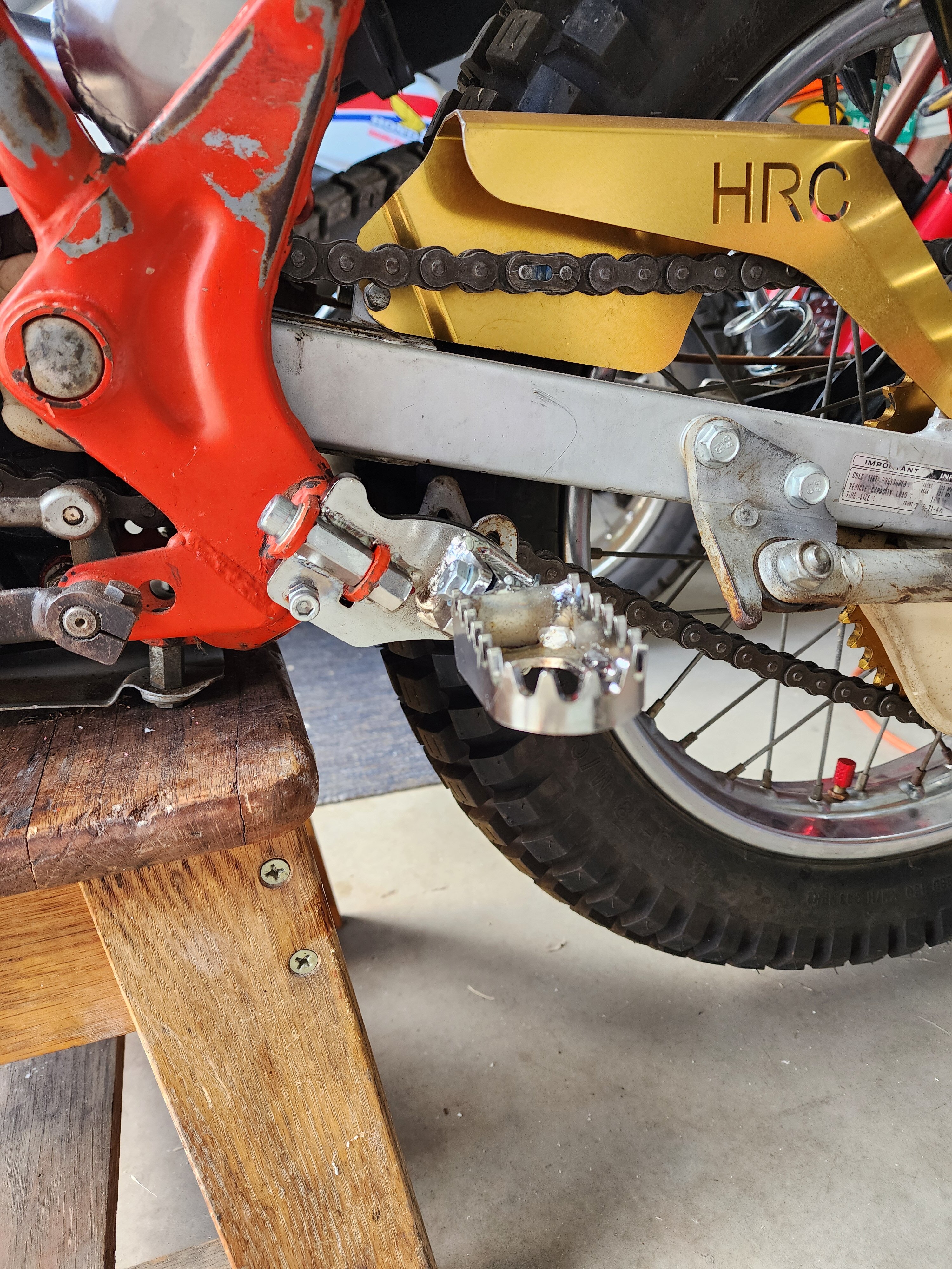

MichaelW Posted Sunday at 08:53 PM Report Share Posted Sunday at 08:53 PM PJust got pair of bolt on replacement pegs, much larger than stock, puts them about 2-2 1/2" back and lower. They are stainless steel and got them through Feked 2 Quote Link to comment Share on other sites More sharing options...

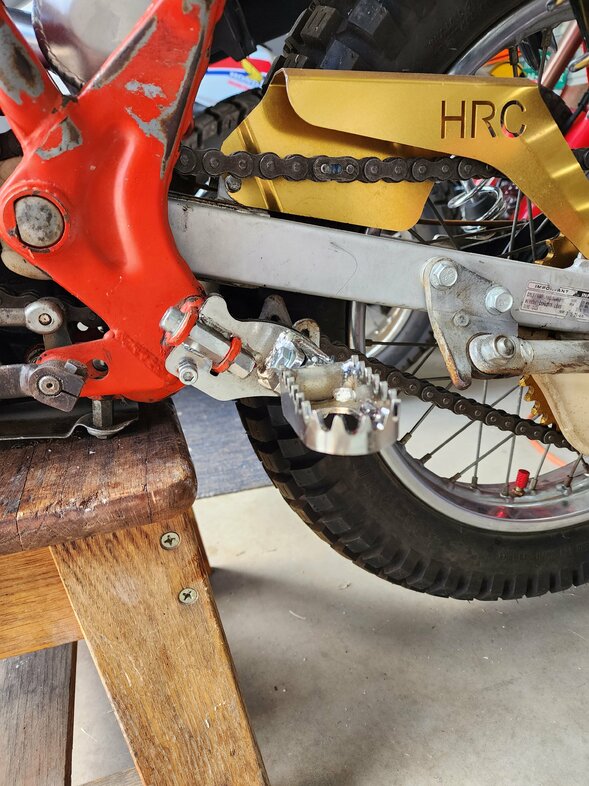

bashplate Posted Monday at 12:27 AM Report Share Posted Monday at 12:27 AM 1 Quote Link to comment Share on other sites More sharing options...
bashplate Posted Monday at 12:32 AM Report Share Posted Monday at 12:32 AM Sorry for double up my picture there. I moved my pegs down and back, and was well worth the effort, even easyer with the bolt on kit. I also used Betor 400mm shocks with 50lb springs....brilliant, the OZO shocks look exactly the same with different brand sticker and guys in the club have them...also good. 1 Quote Link to comment Share on other sites More sharing options...

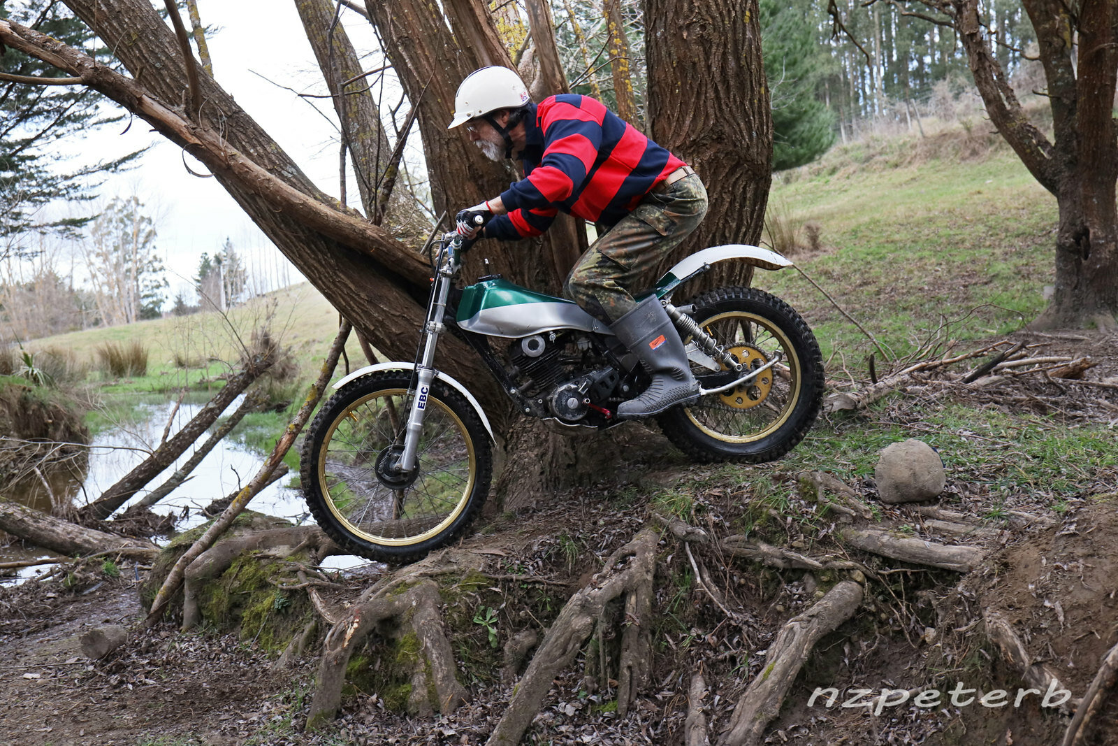

johnnyjazz Posted Monday at 02:44 AM Author Report Share Posted Monday at 02:44 AM (edited) Thanks Bashplate! appreciate the concise spring advice, will def get bolt on kit or fab some similar. ....great pic too. love it! btw, noticed nzpeterb on pics...you in NZ? i like the wheels too! do you have to build new aluminum ones yourself or can you buy them pre spoked and just 'swap em out' ...? Edited Monday at 02:56 AM by johnnyjazz Quote Link to comment Share on other sites More sharing options...

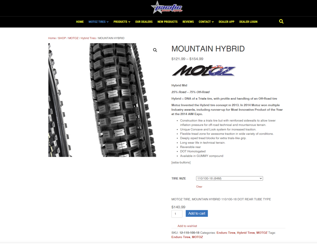

johnnyjazz Posted Monday at 05:20 PM Author Report Share Posted Monday at 05:20 PM Anyone got any intel on the Motoz mountain hybrid? says its a DOT trials tyre...good for lower PSI... at least its available and ready to ship and can run a tube... i'm presuming its in inches as i dont see a 4.00x18...what is the size i need please and very very thank you! super gummy version not DOT but regular is.... ALSO: so sorry if all this info is regurgitated for the umpteenth time...(i try to search the forum first).. there are some epic reflex posts on line, but sometimes trawling through 39 pages of a thread from 10 years ago can get a little tiresome. Quote Link to comment Share on other sites More sharing options...
lineaway Posted yesterday at 02:09 AM Report Share Posted yesterday at 02:09 AM That is not a tire for a trials motorcycle. Quote Link to comment Share on other sites More sharing options...
johnnyjazz Posted yesterday at 11:17 AM Author Report Share Posted yesterday at 11:17 AM (edited) thanks lineaway, i got that it's not a trials tire. however, is it the best of the worst(?) for a plated honda tractor thats nearly 40 years old? im just looking for a DOT tyre for someone with the trials ability of a three toed sloth to play around with in the woods... but not freak me out when corning on tarmac at 30mph... just looking for something i can get currently in NY.... The Mitas tire 'feet up fun' suggested seems unobtainable here or out of stock for ever..even called the dealers listed on their website who said they dont sell them. classic. Did have MT43 on a TY250 which were good on the street in manhattan, but not so in industrial urban sections.. upstate now...mostly hilly woodland riding now..tons of roots, mud, rocks etc... i only do this so i can be a safer, better road rider on my triumph i know a DOT trials tire is an oxymoron... i get it.. everything is a compromise.... would the IRC T1 be a better shoe? its DOT...i know the T11 is the 'trials' tyre but i must needs keep the boys in blue happy to play safely and responsibly. btw, i'm guessing you are 'lineaway' of epic OJ / brewtus posts on adv rider moons ago?- fun reading fun with outright junk. thanks again for input Edited 22 hours ago by johnnyjazz Quote Link to comment Share on other sites More sharing options...
