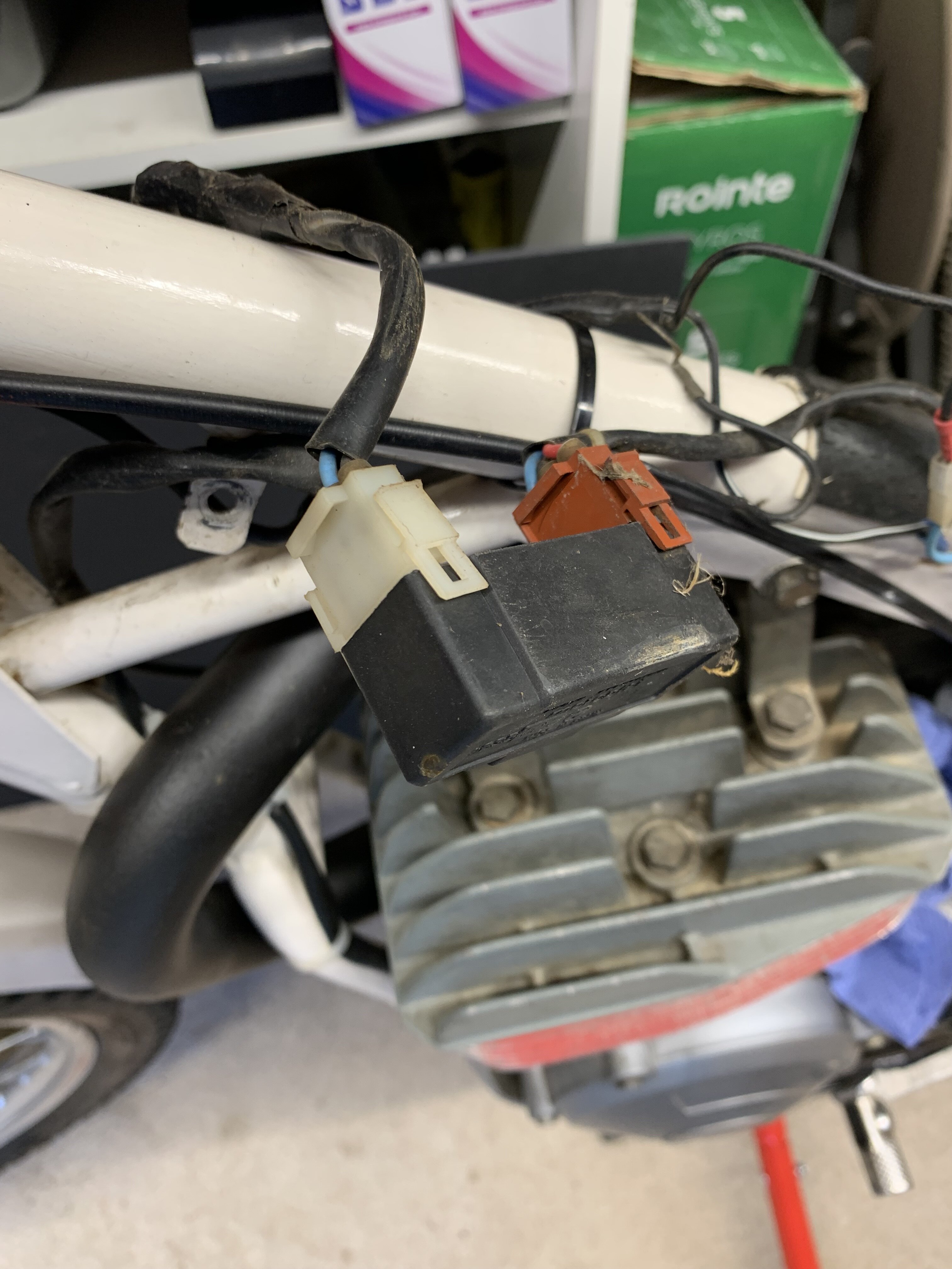

Tootsie Posted July 1, 2024 Report Share Posted July 1, 2024 Hi I’m looking for the correct flywheel puller for my 250 & 327. I’ve been told it’s a M30x1.5 but this is far too big. Also I know there are at least two types of the Motoplat electrics. Mine has a module adjacent to the Cdi with 3pin and 2 pin connectors on it and I know there is another larger module with wiring coming out from it with floating connections. Which is the later? Attached are the Flywheel and module photos. Both my bikes are 1989. What are the Timing settings for both bikes please. Thanks in advance. Quote Link to comment Share on other sites More sharing options...
