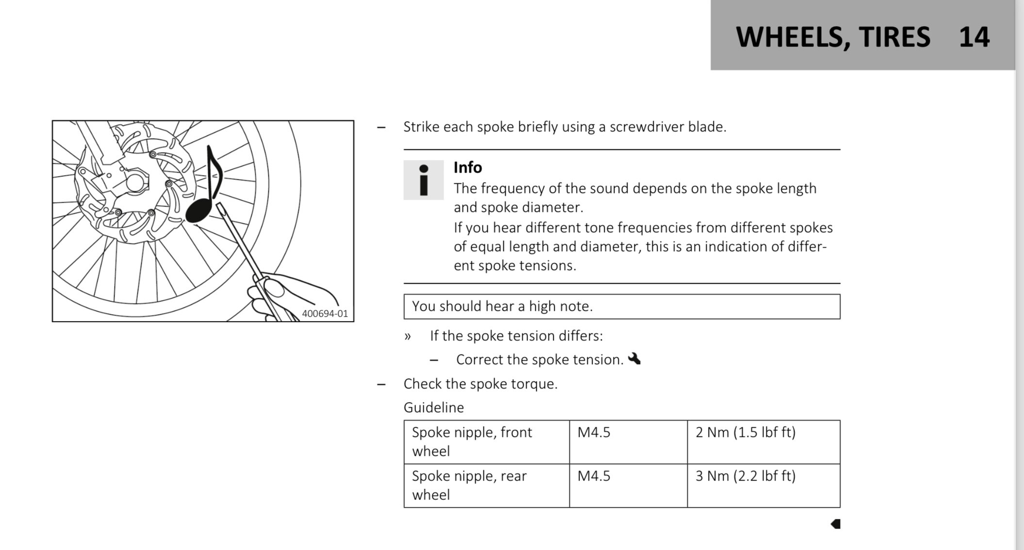

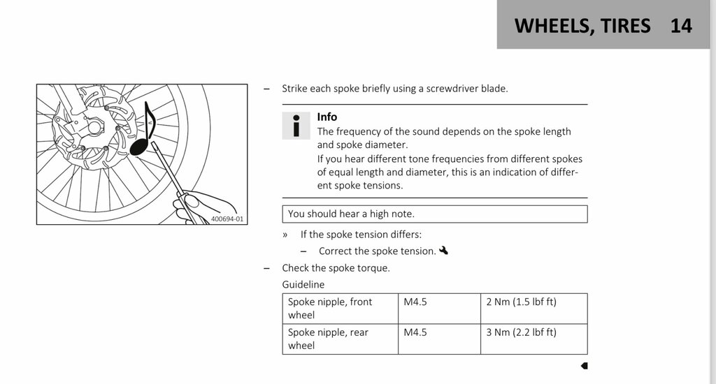

RonH Posted July 9, 2024 Report Share Posted July 9, 2024 (edited) Here’s the specs right out of the manual. I have the same bike. Edited July 9, 2024 by 7heilRhino Quote Link to comment Share on other sites More sharing options...
CaptainBob Posted July 9, 2024 Author Report Share Posted July 9, 2024 10 hours ago, 7heilRhino said: Here’s the specs right out of the manual. I have the same bike. Right, That is what the book says. Now... transfer the figures to inch pounds. Front wheel is 18 inch pounds. Seems kind of light to me. Like I said before, every wheel spec I have ever seen seems to fall between 40 and 50 inch pounds. I did check the spokes on my 23 TXT300 and they are much tighter than what the book says. That is why I question these specs. Quote Link to comment Share on other sites More sharing options...
