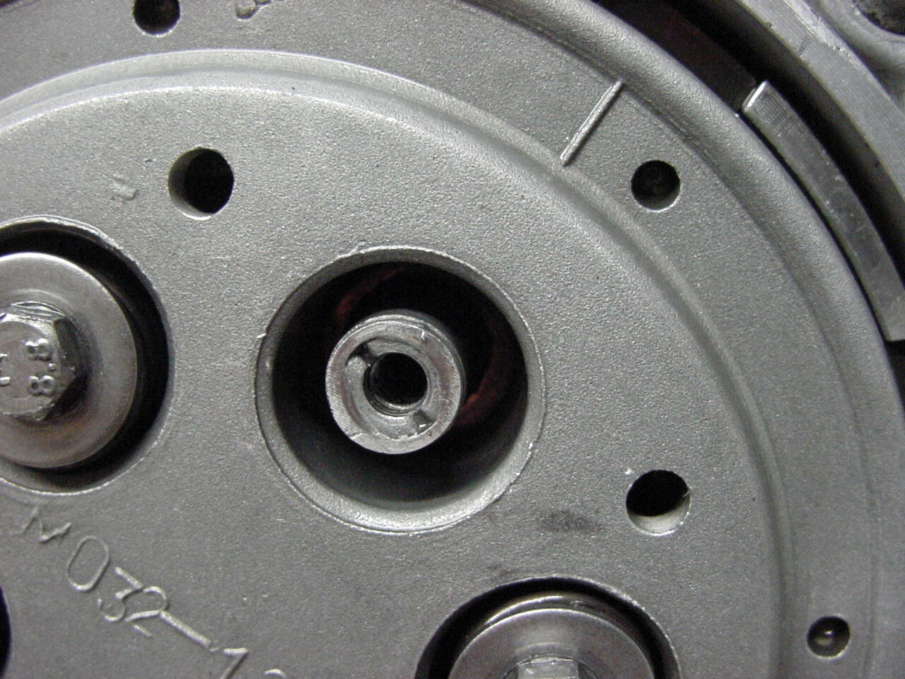

konrad Posted July 23, 2024 Report Share Posted July 23, 2024 (edited) The TXT321 was my first trials bike. I have a vague recollection that the pressure plate requires a specific orientation. Found the following pic in my notes on the bike. Note alignment marks. Also, I always short-filled the gearbox (using 450 - 500 ml) to reduce clutch drag. Discovered that on my own, but later learned it was the factory-approved fix. Edited July 23, 2024 by konrad 1 Quote Link to comment Share on other sites More sharing options...
