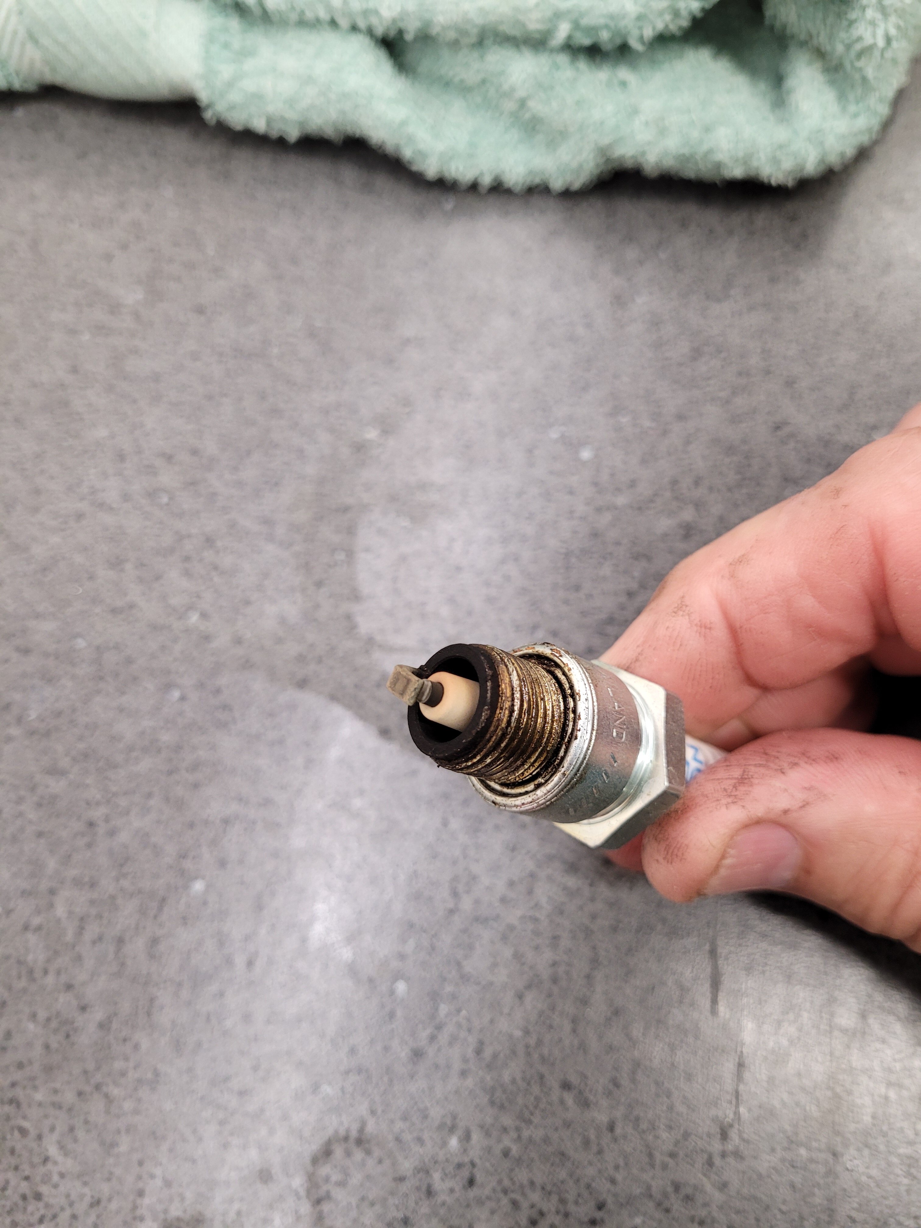

pete65 Posted August 2, 2024 Author Report Share Posted August 2, 2024 Good point Lemur, the plug tells me that the mixture is lean enough, I'll leave the needle at it's richest setting rather than the manual's setting of one slot lower and concentrate on getting the carb and jets clean. Quote Link to comment Share on other sites More sharing options...
pete65 Posted August 3, 2024 Author Report Share Posted August 3, 2024 After stripping and rebuilding my carb, with the benefit of an airline gun, and without the benefit of my rarely used £90 Chinese ultrasonic cleaner that decided to pack in, 🤬 I now have a smooth tickover and good throttle response. I was surprised at the colour of my plug with the needle being in it's highest position, I will keep an eye on that. Is it normal for these engines yo run lean? The fan also came on much quicker than usual? I would be interested in anyone's thoughts? Quote Link to comment Share on other sites More sharing options...
