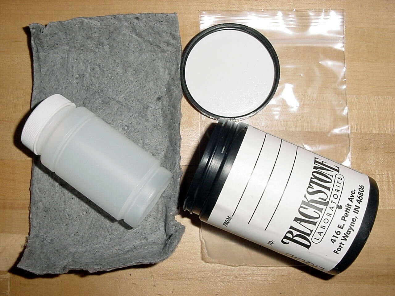

konrad Posted August 11, 2024 Report Share Posted August 11, 2024 I agree with Lemur. But if you insist, I can highly recommend Splatshop. They are second to none in terms of price, convenience, and support. But shipping oils by air will likely cause a problem. The US Postal Service allows a small volume of oil to be sent by mail, but only when using the special precautions shown below. 1 Quote Link to comment Share on other sites More sharing options...
