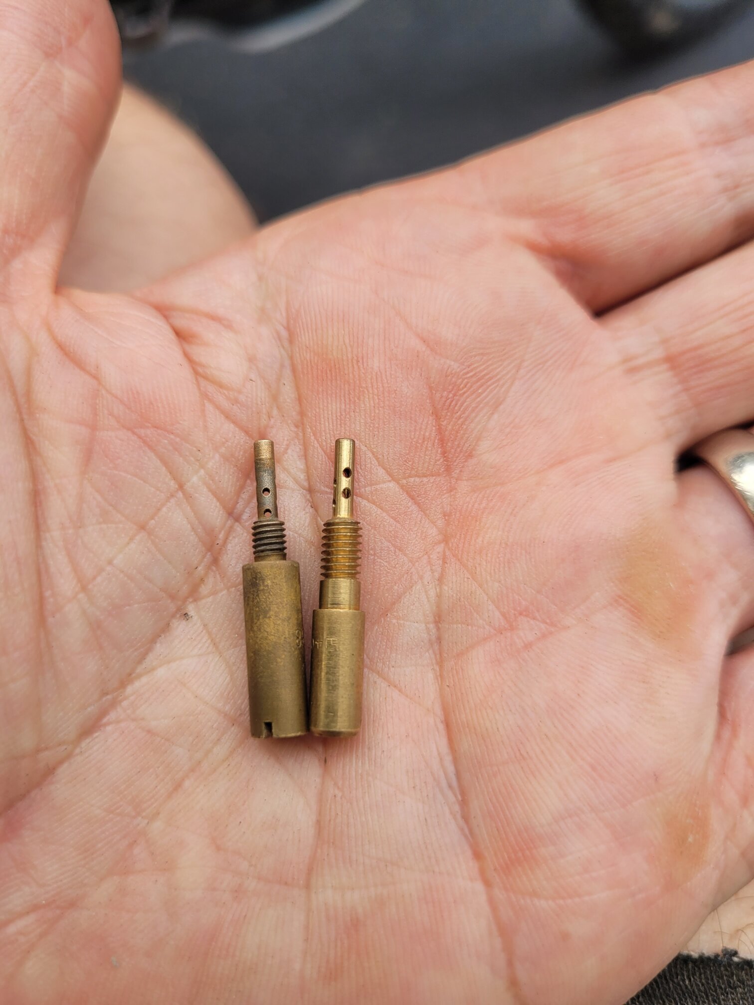

johnnyjazz Posted August 11, 2024 Report Share Posted August 11, 2024 (edited) Hi friends, sorry to be a nuisance again but i was hoping to garner some info to help me along...i have tried to do my due diligence to research but the web is so full of thoughts/opinions trying to access the pertinent (correct) info can be challenging. Rather than try and go for what someone said in on page 9 of a 37 page thread from 2007 i shall just try and start again! (i am a Noob) Q/ i know the reflex's that came stateside were set to run lean and have a #38 pilot jet. i obtained a #40 from what i thought was a 'reliable on line source' only to find out it def looks the wrong one (Part # 99124-076-0400). Rather than 'shove in in' and mess everything up and damage the brass, my judicious nature prevailed and i just stopped. would anyone know a correct part number for a #40 pilot jet for an 86 reflex? maybe that is the one but the threads look a wee bit bigger? also, am i right in thinking its quite common to have this issue on the TLRs? runs totally fine and tick over is sweet then it just drops revs and stalls after a minute at idle...very frustrating! - is that the pilot circuit taking over from the main? finally, i see in the manual where it says to 'turn the air screw all the way in then back it out 1 3/4 turns....am i being totally stupid as it looks like 1 turn is all i can get with the stopper/ tab thing in the way? is this the limiter tab that needs to be removed to adjust properly? oh and super lastly, pic of plug - does it looks ok?..maybe .is it too rich? thank you all so much for any help! having so much fun and making loads of awesome mods (new shocks, down and back pegs, 9 tooth front. new bash plate...etc) thanks to all the advice's and guidance here. learning SO much as always. Now i just need to practice!! very best from NY, Johnny... pics of 'new' #40 jet with old #38...totally wrong one yeah? and air screw with locking device thing and plug.... Thank you thank you thank you!! You Guys are the BEST!!! Edited August 11, 2024 by johnnyjazz Quote Link to comment Share on other sites More sharing options...

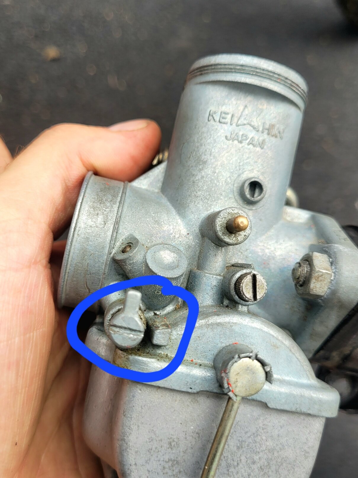

konrad Posted August 11, 2024 Report Share Posted August 11, 2024 Don't shove the wrong pilot jet in! Yes, that is a limiting cap that was introduced for EPA compliance. Reading a plug is a skill that can't be taught -- only gained through much experience and experimentation. Rather than bother about how the plug looks, concentrate on how the bike performs. Don't be afraid to experiment! I like to have at least one jet either side of standard to know in which direction to go. 1 Quote Link to comment Share on other sites More sharing options...

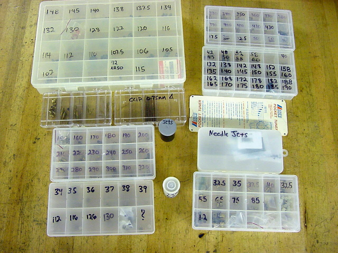

johnnyjazz Posted August 11, 2024 Author Report Share Posted August 11, 2024 Thanks Konrad! jeepers that is quite a selection, sir!! would you know the honda part # for a 40 slow and 100 main? other than the ****ey idling issue she runs sweet! reference reading plugs am learning about this stuff, slowly... Quote Link to comment Share on other sites More sharing options...

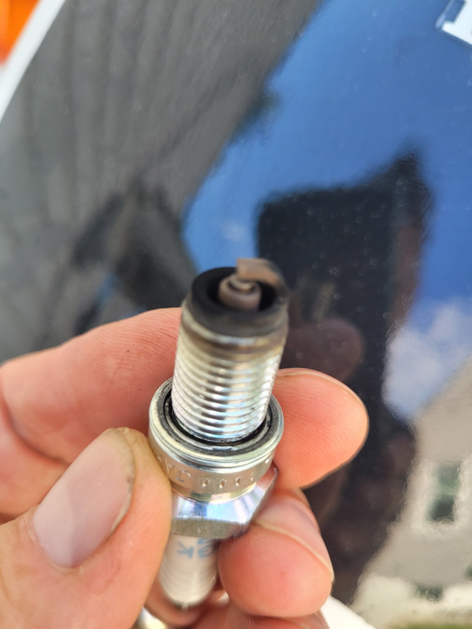

lemur Posted August 11, 2024 Report Share Posted August 11, 2024 (edited) It's a Keihin carburetor, go to the Keinin catalogue, Sudco is the biggest supplier of carburetor info and cataloged parts in NorthAmerica ... spark plug looks nice and toasty brown from here even though the important parts are out of focus. Edited August 11, 2024 by lemur 1 Quote Link to comment Share on other sites More sharing options...

johnnyjazz Posted August 16, 2024 Author Report Share Posted August 16, 2024 Thanks again everyone for help! i always learn so much here. i know putting money into a reflex isn't worth it, but to have a fully road legal trials bike is priceless. esp. as swapping back to a 13 front sprocket at any point gives trail options too. Bike is running like a charm now - if it helps anyone else....part number Part # 99124-076-0400 IS the correct slow jet - i was indeed given a bum steer by a 'reputable online retailer' who sent the wrong part, hence original post! Also i got the Keyster carb kit KH0047 which had a 100 main jet which indeed helps also.. finally with the 'tab' over the airscrew removed (was super glued on) and set at 2 1/2 turns out and its good as new with no stalling or dying at tickover Thanks again Lineaway for link to Brewtus's epic post... along with the kilt pic, the story about mrs bitters running the cat over with the forklift was worth going through the 37 pages again! 9 tooth front sprocket - check / New Betor shocks - check / Direct attach gear shifter - check / down and back pegs - check / new aluminum bash plate - check / battery eliminator - check / voltage regulator - check / fully street legal, registered and insured - check. (Fecked and TY trials - thanks you!) Deep joy!! Now i just need to learn how to ride better and not get intimated by falling off!! lol. Happy weekend all original 1986 reflex ad if you haven't seen it! lol...the good ol days.. https://www.youtube.com/watch?v=1txpslGSyhI (and if it helps anyone else save some time): https://www.feked.com/honda-tlr200-footrest-lowering-kit-direct-fit-to-original-mounting-point-en.html https://www.feked.com/honda-sump-guard-skid-plate-tlr250-tlr200-and-reflex-models.html https://www.tytrials.com/trailandtrialsuk/prod_502124-Front-Sprocket-TLR200.html https://www.tytrials.com/trailandtrialsuk/prod_516379-1-Pair-of-Betor-Classic-Trials-Shocks-400mm-TLR200-Reflex.html https://www.tytrials.com/trailandtrialsuk/prod_148184-1-Gear-Lever-TLR200-Reflex.html https://www.amazon.com/HONDA-SL125-SL125S-KEYSTER-CARB/dp/B0788X1F3Q 1 Quote Link to comment Share on other sites More sharing options...
