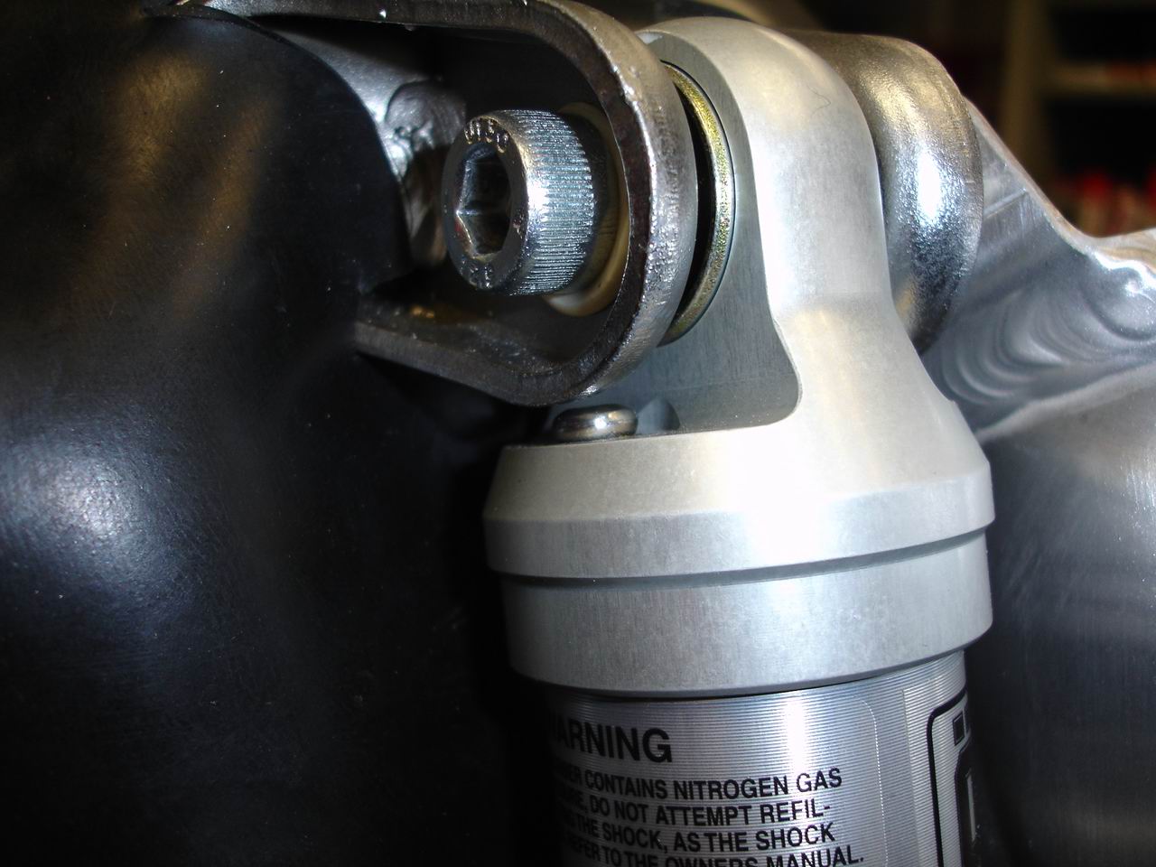

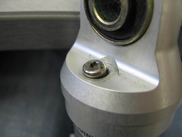

blocky Posted March 23, 2006 Report Share Posted March 23, 2006 IMPORTANT! ALL "06 PRO OWNERS!! 24 Mar 2006 ALL "06 250/280/300 AND 125 Racing MODEL PRO CUSTOMERS WITH THE "SILVER OHLINS SHOCK" We have now had 7 x "06 ohlins shocks lose their damping. This is un-heard of with Ohlins but we have sussed the reason why; The 'service screw' on top of the shock is VERY close on some bikes to touching the frame. Because the topbush is rubber, under heavy use, the bush flexes and then the screw is damaged, then losing all the nitrogen. All "06 BIKES MUST BE CHECKED! Take off your airbox and you'll see the screw on top of the shock. If your screw has been touching then you need to; 1. Grind the frame away a little to give more clearance. 2. Phone myself 01298 766811 or JUDE 01298 766812 and we will send you a different rose bearing type top bush. You can either fit a new type bush yourself or contact your GG dealer where you bought your bike. THIS MUST BE DONE AS SOON AS POSSIBLE because to add to this problem we have NO ohlins shocks in stock to replace them if the shock fails and we cannot 're-gas' the shocks here. They have to go back to Ohlins. Quote Link to comment Share on other sites More sharing options...
jordi Posted March 23, 2006 Report Share Posted March 23, 2006 Can anyone tell me the difference between the silver and gold bodied Ohlins shocks, my 06 has the gold body Ohlins. Quote Link to comment Share on other sites More sharing options...
no1 Posted March 23, 2006 Report Share Posted March 23, 2006 if it has a twist by hand adjuster at the bottom you are ok if you adjust it with a screwdriver you must replace the top bush or grind the frame away on the gold ohlins the top bush is a solid rose joint on the silver shoke it has a rubber top bush Quote Link to comment Share on other sites More sharing options...

simtech Posted March 24, 2006 Report Share Posted March 24, 2006 If any of you guys would like to have your dampers modified to solve the above problem then please contact me. The bearing and mods to the frame DO NOT totally solve the problem. The reason for this is that you can not re-gas the damper with the existing grub screw configuration (as per above photo)!!!! Please call the following for the complete solution to the problem by a Ohlins engineer and any servicing requirements 07786 926501 Quote Link to comment Share on other sites More sharing options...
