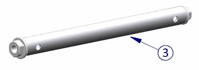

I'm planning on replacing the sliding bushes in my forks some time in the not too far distant future and am hoping someone can enlighten me about the Cartridge Assembly Tool 080008000 used to hold the left leg end stroke regulator.
What is the working end? It looks like it is just a socket key, but what size?
Presumably it should be easily replicated with a suitable allen key on an extension.

mine was made by welding a nut on a pipe...after I bored nut internals.
This tool has two ends because aluminium forks and steel forks are diffrent sizes
It is not needed everytime.
If you disassemble with an impact hammer, probably will no need to hold internals

Can you tell me the sizes of the hex (nuts)? That's what I'm missing.
