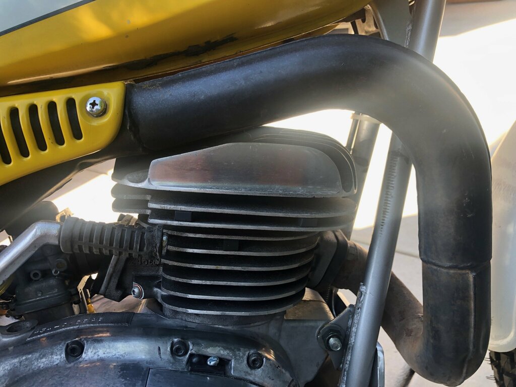

mcman56 Posted August 27 Report Share Posted August 27 I have a TY250A with two spark plug holes. Did they come that way or could it be an aftermarket head? Online parts lists don't seem to show two but a drawing in the service manual looks to have two. I remember having a DT1 with a compression release but don't know if it was OEM or after market. Quote Link to comment Share on other sites More sharing options...

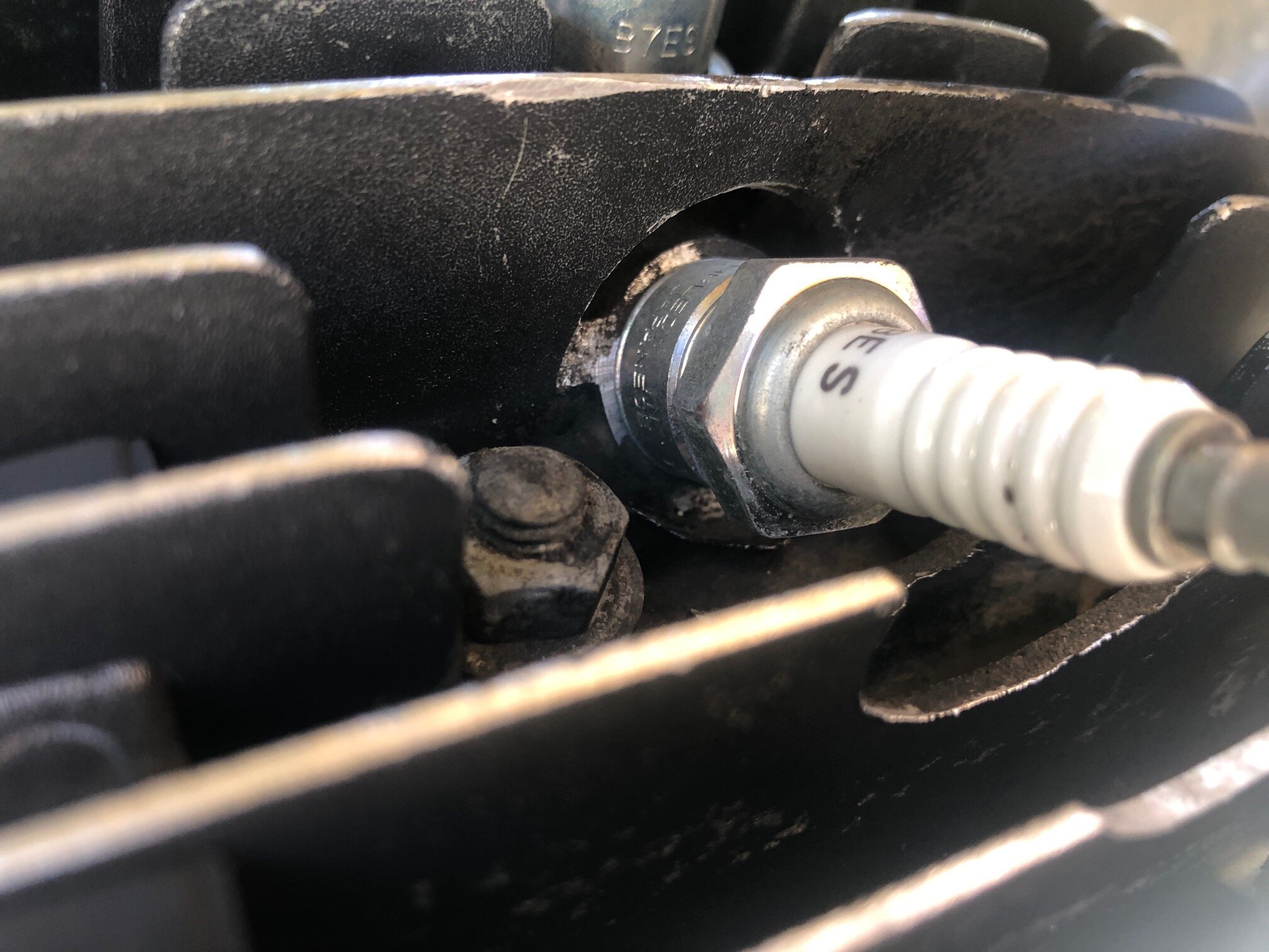

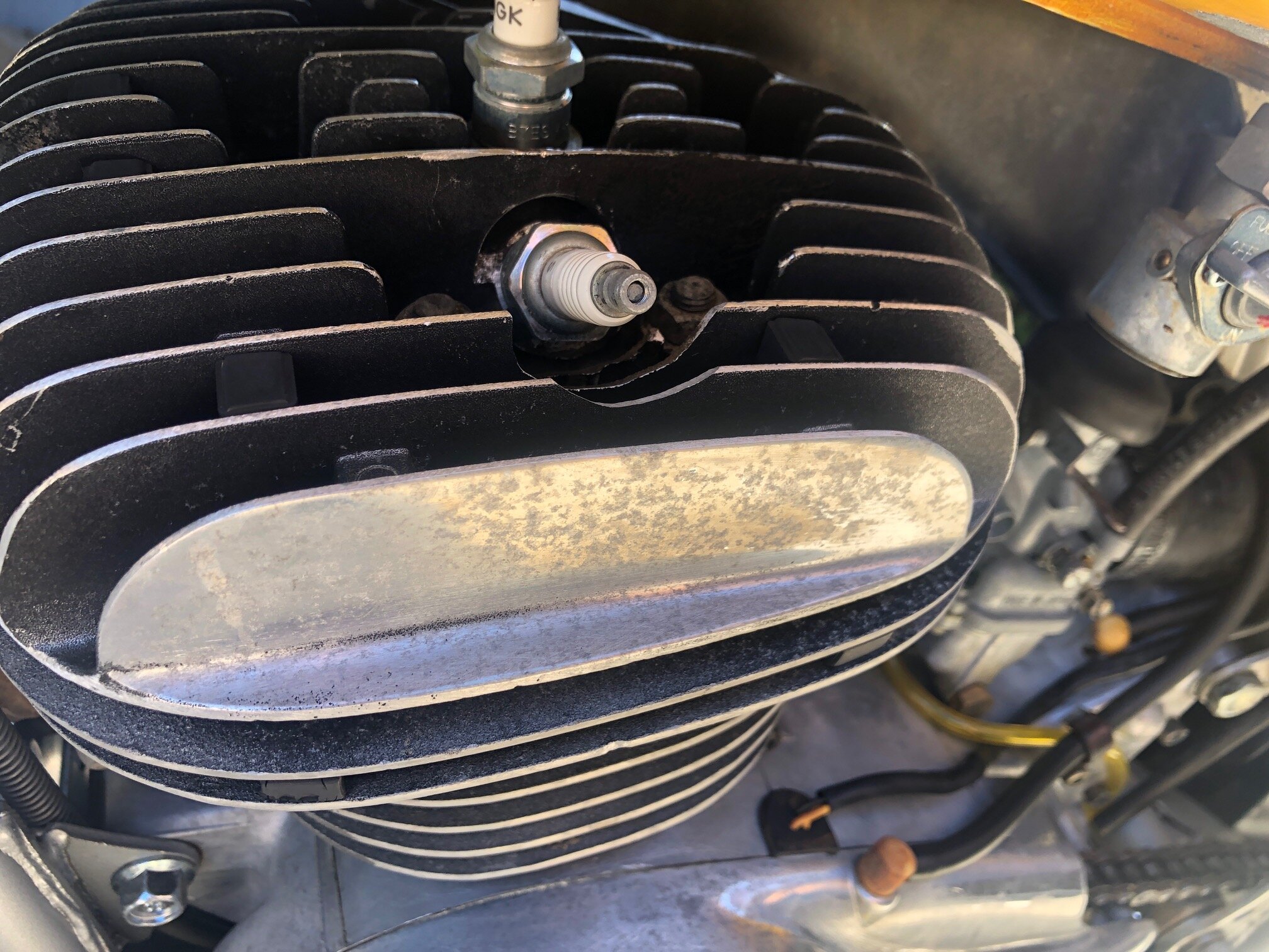

mcman56 Posted August 29 Author Report Share Posted August 29 (edited) Clearance holes in the fins look a bit crude and not OEM so maybe a modification. However, it looks like there is a cast in boss where the plug threads in. Edited August 29 by mcman56 1 Quote Link to comment Share on other sites More sharing options...
guy53 Posted August 30 Report Share Posted August 30 It sure look like an original 434 head with a modification made in an unconventional way. if it work, use it. The original plug wire must be short. Guy 1 Quote Link to comment Share on other sites More sharing options...
feetupfun Posted August 31 Report Share Posted August 31 Here are photos of a TY250 head to show the cast-in boss that mcman56 is referring to. 1 Quote Link to comment Share on other sites More sharing options...
