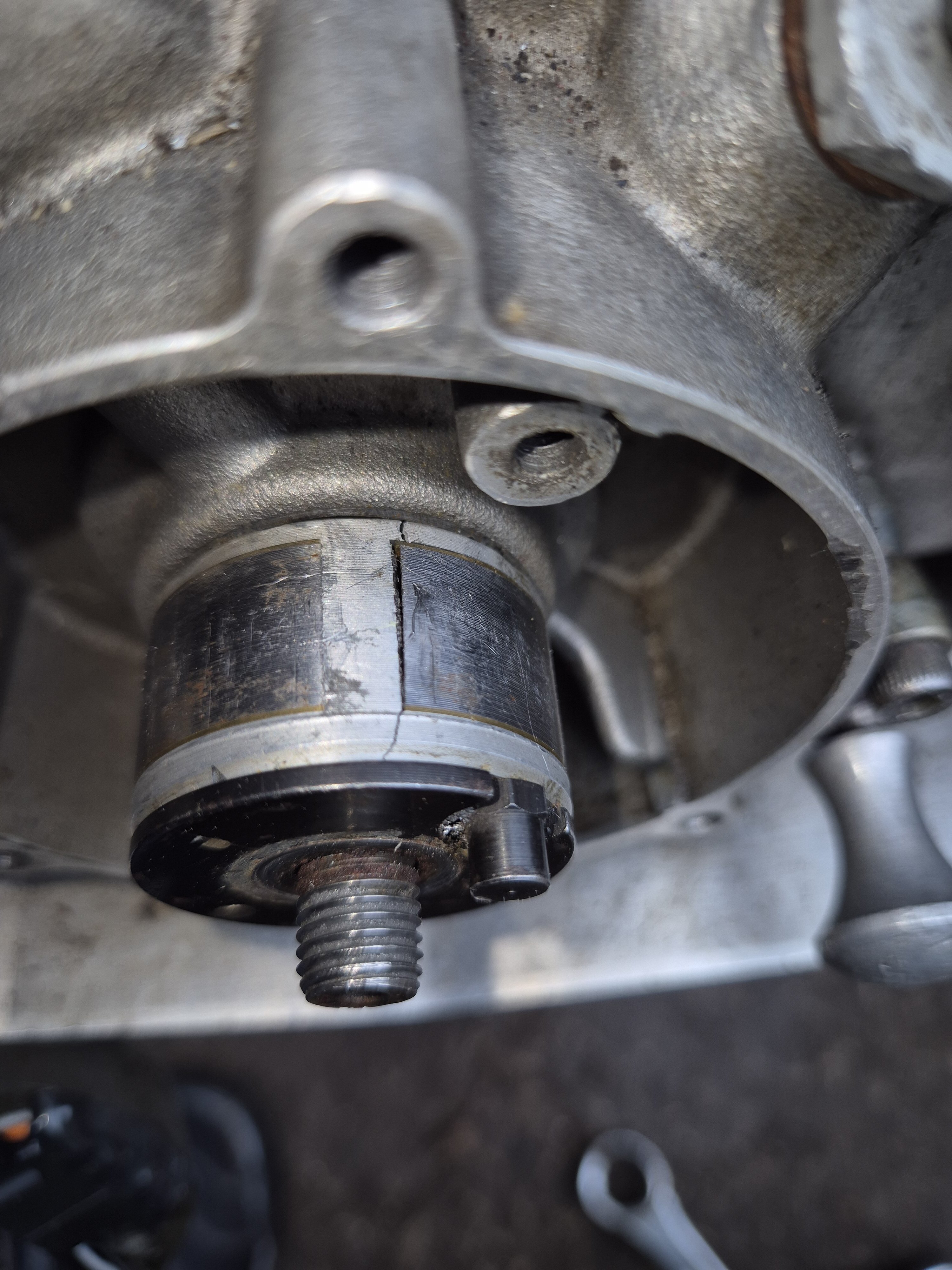

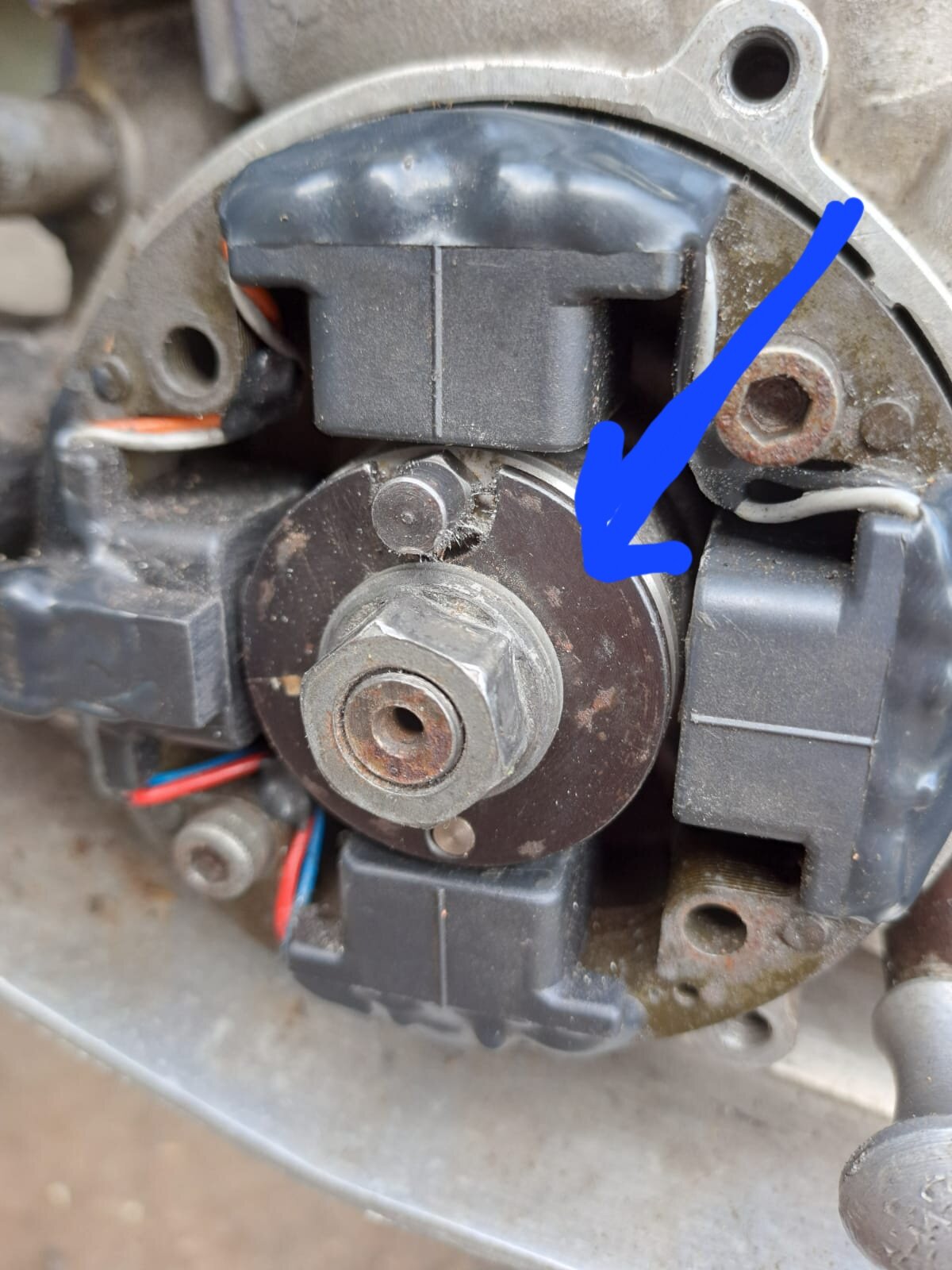

lemur Posted September 17, 2024 Report Share Posted September 17, 2024 It's a permanent magnet is it not? There are a lot of iron filings stuck to the magnet in the photo, that might cause shorts and indicates a wear problem, I would clean it all up, test the coils and try again. Quote Link to comment Share on other sites More sharing options...
jhorn Posted September 18, 2024 Author Report Share Posted September 18, 2024 HI seen them and cleaned them noticed crack line on core struggling to find replacement Quote Link to comment Share on other sites More sharing options...
ChrisCH Posted September 18, 2024 Report Share Posted September 18, 2024 Re-winding is a common thing. Not sure about the magnet part. Worth a try perhaps to these guys? http://www.westcountrywindings.co.uk/applications.php 1 Quote Link to comment Share on other sites More sharing options...

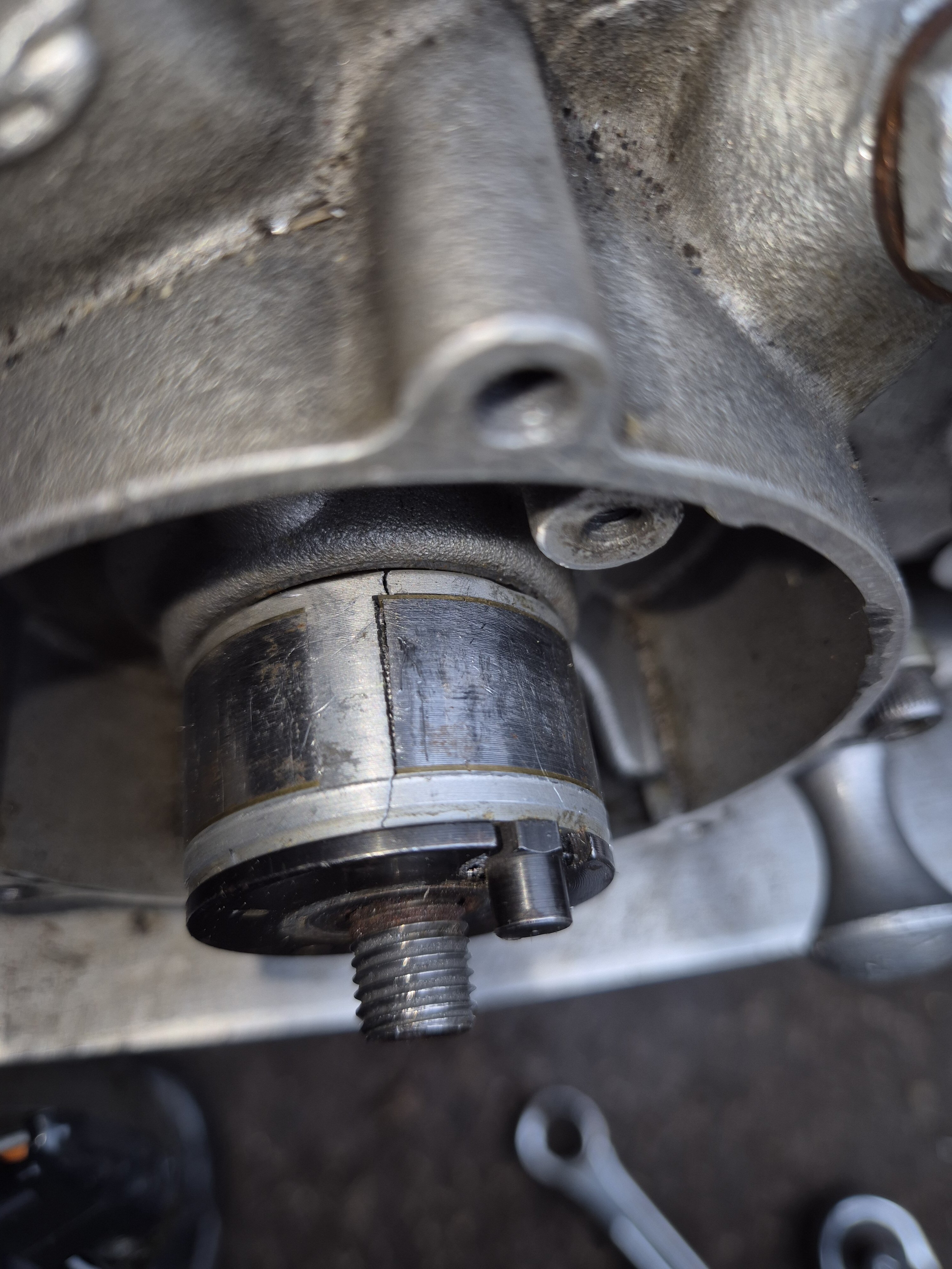

mcman56 Posted September 19, 2024 Report Share Posted September 19, 2024 Can you post a picture of crack in part? Quote Link to comment Share on other sites More sharing options...
jhorn Posted September 20, 2024 Author Report Share Posted September 20, 2024 On 9/19/2024 at 1:57 PM, mcman56 said: Can you post a picture of crack in part? Expand Hi yes will send one at weekend Quote Link to comment Share on other sites More sharing options...

lemur Posted September 21, 2024 Report Share Posted September 21, 2024 I'd pull it off to determine exactly why it split, see if the crack can be reduced back to zero and hit all the cracks with superglue to reinstall and see if it splits open again. Quote Link to comment Share on other sites More sharing options...
jhorn Posted September 22, 2024 Author Report Share Posted September 22, 2024 Cheers iĺl give that ago I've heard that the ktm 50 will fit but not sure which one any ideas .think I need a to replace the cdi too Quote Link to comment Share on other sites More sharing options...

mcman56 Posted September 22, 2024 Report Share Posted September 22, 2024 Without a picture of the center, it looks like an aluminum core with steel plate on front. Is so or even if not, you may be able to pry the magnets out, have the aluminium piece remade and epoxy the magnets back in place. You could take it to a shop that does machine work and ask. I found this also. 1 1 Quote Link to comment Share on other sites More sharing options...
