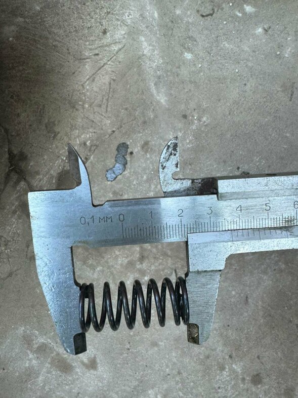

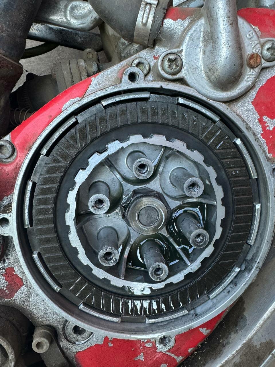

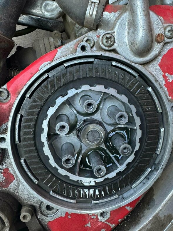

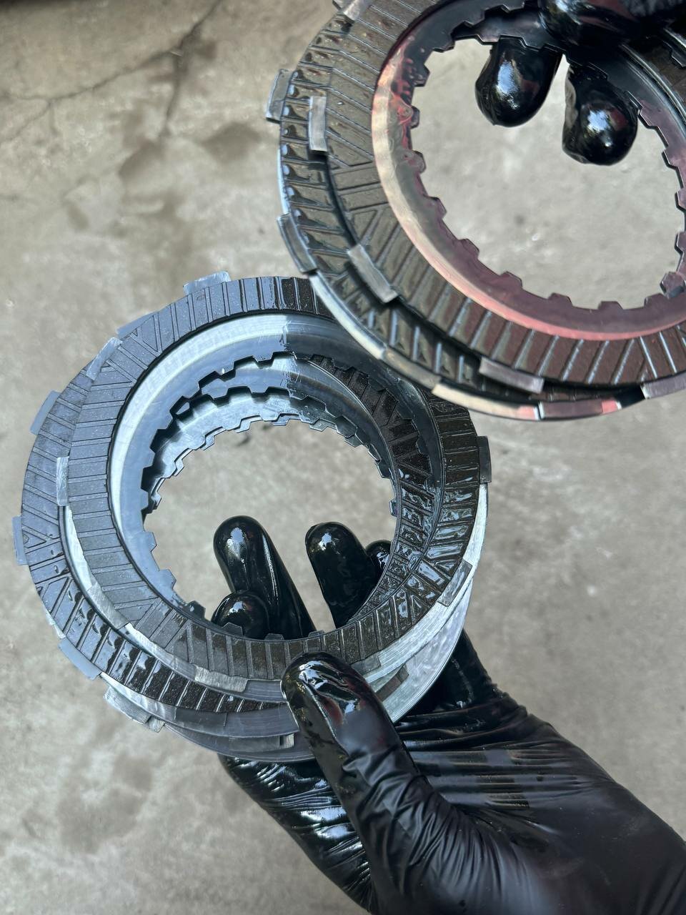

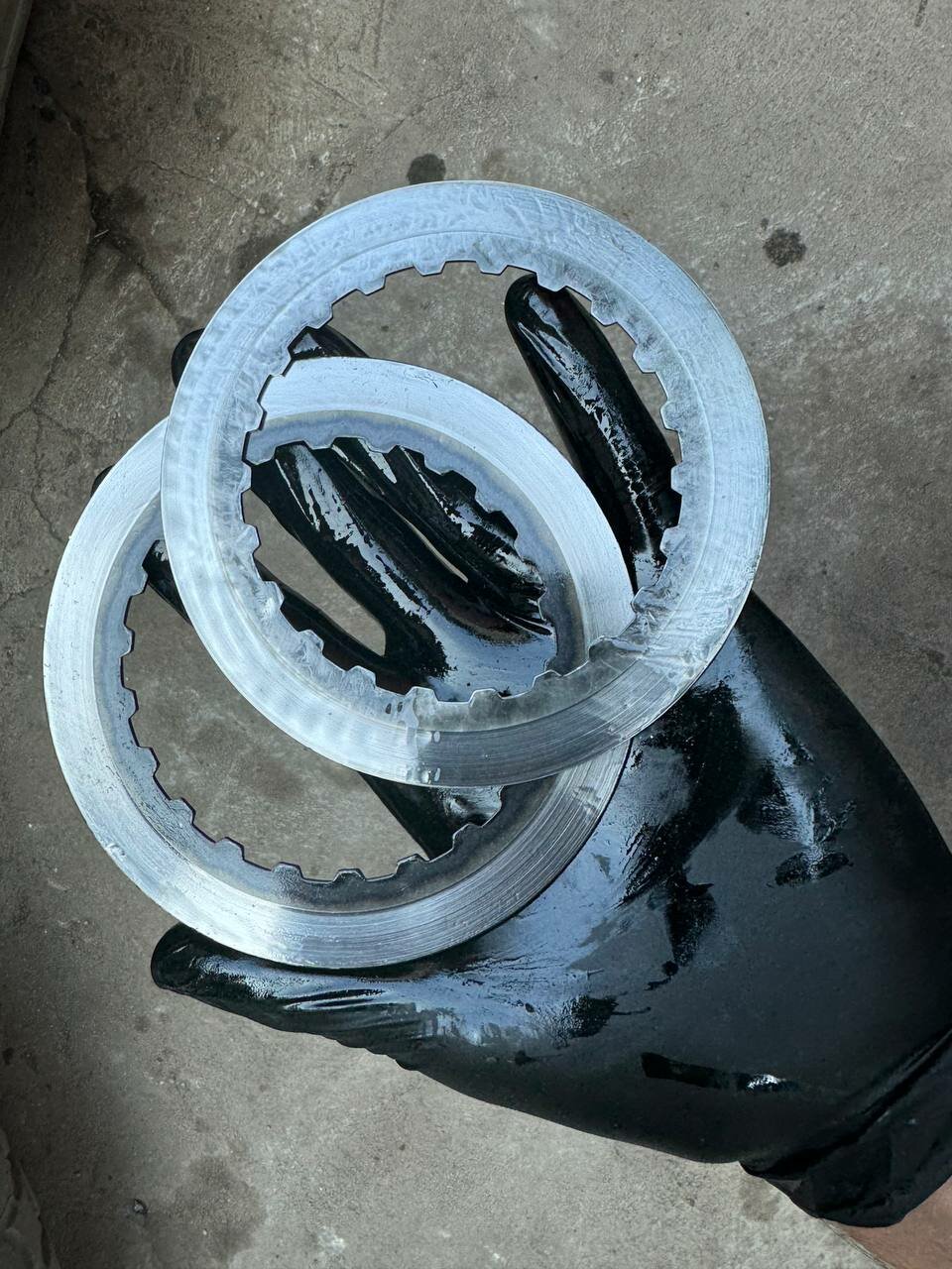

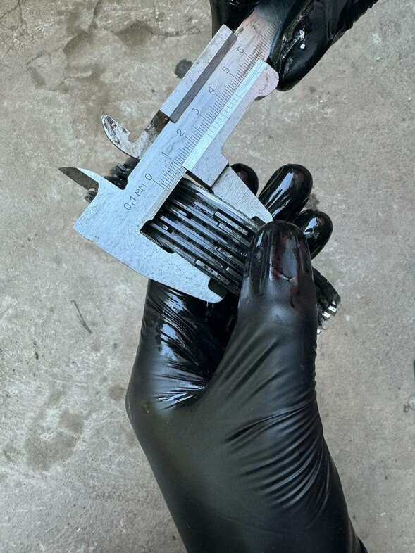

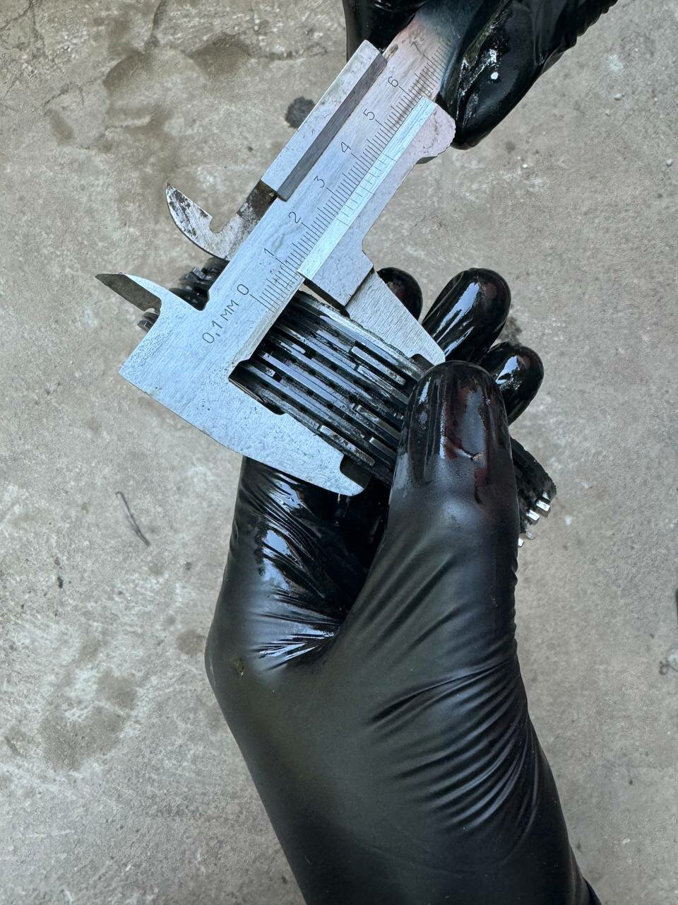

The clutch will probably slip. At high speeds there is vibration and the motorcycle does not move!
The size of the package is 25.8 mm, I checked the feredo in place and did not lag behind the disk. Spring size 37 mm.
