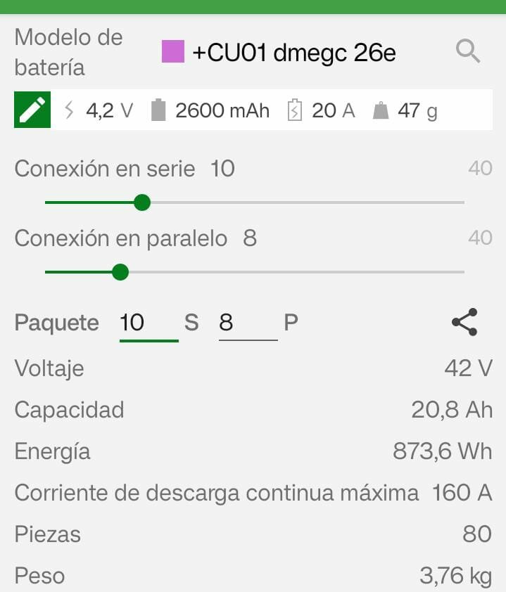

I have bought a lithium battery for her of 36-42v and 21aH, with a continuous discharge of 160A (according to the manufacturer).
The motorcycle now has a spectacular duration, but the problem comes when on some occasion, perhaps when accelerating very suddenly, the motorcycle stops, with the ignition button on, the accelerator lights disappear and the motorcycle stops. To start it again you just need to turn OFF/ON in one second and it works again.

P.S. I attach an image with the characteristics of the battery

I don't know anything about the Oset 20 Lite, but this source https://www.ultimatespecs.com/motorcycles-specs/oset/oset-200-lite-2017 says it has a maximum power output of 0.9 kW.
Your lithium-ion battery is rated 42V and 160A, which would permit a maximum power output of 6.7kW!  Even when the battery is depleted to 36V, it's capable of providing 5.7 kW.
Electric vehicles are a system comprising motor, battery, and controller all designed to work together.   Your controller is protecting the system from that very powerful battery by temporarily shutting off.
Basically, your Li-Ion battery has "upset the balance of power."

After much discussion I have managed to get the manufacturer of my battery to make me a new battery since they sent me the one that did not correspond to me, they sent me one that was inferior to the one I had paid for.
After speaking with electrical engineers they tell me that the BMS may be in poor condition or incorrectly configured. I hope the new battery will put an end to my problems.
