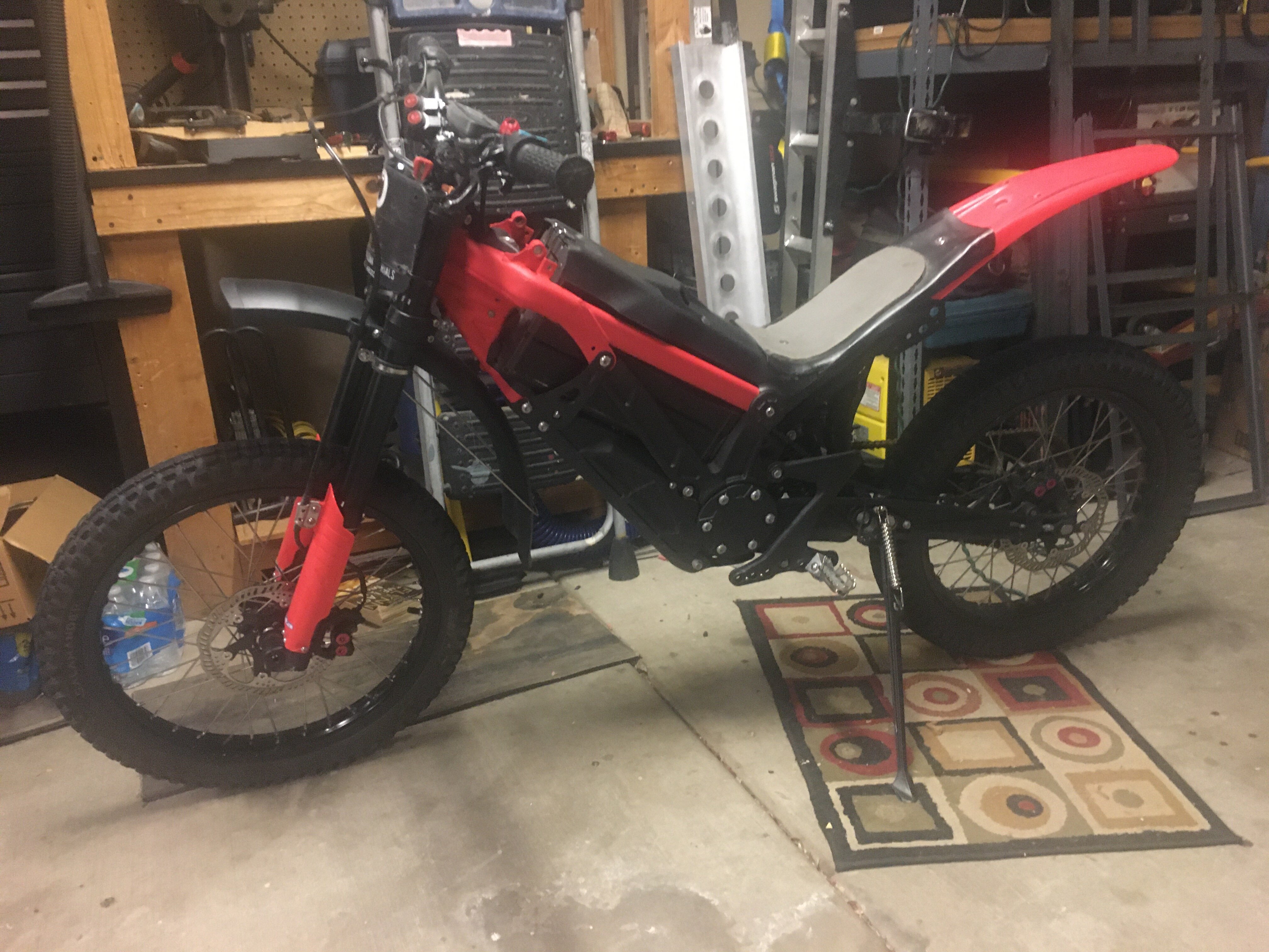

jwalsh Posted October 8, 2024 Report Share Posted October 8, 2024 My self-modified trials special has insufficient fork lock. I have ground off the fork stops until the fork legs almost touch the frame. The bike is supposed to have 45 degrees but it doesn't - close but not quite. Probably not the best fork trail for trials either. So, doing full lock turns, a requirement our local trials masters love to require, is difficult. I am working on decreasing the turning radius by leaning into it with my substantial butt as counterbalance. I am told to not dip my shoulder (which one?) and to look at where I want to go (over my shoulder?). There is no way I can move the front or rear around - I only have 'both tires planted' skills. Floater turn? Don't make me (or the observers) laugh. I have been doing this for many decades and, like many of my generation, am baffled by the skills that have evolved. Nonetheless, I would appreciate any tips or coaching. Footpeg weighting? Throttle control (the front tire wants to push)? Front/rear weighting? Quote Link to comment Share on other sites More sharing options...

lemur Posted October 8, 2024 Report Share Posted October 8, 2024 Had to look at your other posts to know the problem is TLR200 related, stock forks and geometry are marginal for a competition trials bike, too much rake and trail. You are leaning the bike into the turn to make the forks stand up more vertical (steeper fork angle) and thereby reduce the turning radius very slightly, but by applying that lean technique eventually the tire contact patch is too far ahead of the axle and forward travel becomes unstable. The stock TLR200 forks have a leading axle (axle is forward on the lower fork leg) and that wheelbase lengthening feature is to make the bike more stable at road speed but also increases the bikes turning radius. If you are worried about your shoulders, that sounds like you are riding the bars and not the pegs, bend the knees to crouch more and that will have you riding the pegs more and weighting the bars less. Nice bowleg stance and weighting your pegs on the outside helps give better control, but stock TLR200 footpegs are not good, upgrading pegs to a more modern, wider, more aggressive footpeg is a good upgrade that can improve your riding style. Need to see the bike and you riding it to know better 👍 but you likely need a motorcycle upgrade to take your riding skills to the next level. 1 Quote Link to comment Share on other sites More sharing options...

jwalsh Posted October 8, 2024 Author Report Share Posted October 8, 2024 2 hours ago, konrad said: Now you've got me curious! What is it? Quote Link to comment Share on other sites More sharing options...

lemur Posted October 9, 2024 Report Share Posted October 9, 2024 You might have started with saying it's a Beta Explorer. If Beta wanted to make the explorer into a trials bike they would have started by not fitting it with USD forks and enduro style geometry. Your wheelbase is likely about 3 inches longer than a typical trials bike, front fork travel about 3 inches more front wheel travel than a typical trials bike and it can't fit real trials tires, making it about as much of a trials bike as a surron is. No amount of riding technique or lean angle or grinding down steering stops is going to change the nature of the bikes original design. 1 1 Quote Link to comment Share on other sites More sharing options...
jwalsh Posted October 10, 2024 Author Report Share Posted October 10, 2024 10 hours ago, lemur said: You might have started with saying it's a Beta Explorer. If Beta wanted to make the explorer into a trials bike they would have started by not fitting it with USD forks and enduro style geometry. Your wheelbase is likely about 3 inches longer than a typical trials bike, front fork travel about 3 inches more front wheel travel than a typical trials bike and it can't fit real trials tires, making it about as much of a trials bike as a surron is. No amount of riding technique or lean angle or grinding down steering stops is going to change the nature of the bikes original design. I said it was a non-trials bike. Am I being chewed for how quickly I posted details about the bike ? My post is about how to maximize success with tight turns through technique. This particular bike is offered as an example of one that does not sufficiently lend itself to it. Whatever bike, my questions are the same. On paper, the Explorer encourages experimenting like I am doing. It is easy to get trials "seating" and footpeg positioning. The Explorer wheelbase is amost exactly the same as my TRS - just under 53". The fork trail is only 1/2" more. It is easy to get trials "seating" and footpeg positioning. Other parameters are on the wrong side but not radically so (fork travel is only 0.2" longer). USD forks are used on real Trials too - Like the EVO and TRS One. They are more rigid and tend to give less unsprung weight, but their design does contribute to my problem in that the fat uppers will touch the frame sooner (and mounting a low fender is difficult). Yeah, it was not designed for trials but there are things we do for the fun of it and I got to play with electrical for half the cost and still ride in trials (like my putting on real trials tires and engineering a lanyard button. I still haven't figured out the mandatory spark arrestor ). Where the design mostly departs is fork lock. We don't typically get specs for that but The Explorer is obviously deficient there. It's OK my friends here focused a bit on what I can do with the bike instead of with me. In many cases they gave me courage to try things I have not yet done - like lowering the front by slipping the forks. Expert suggestions from experts and many thanks. 2 Quote Link to comment Share on other sites More sharing options...
lemur Posted October 10, 2024 Report Share Posted October 10, 2024 6 hours ago, jwalsh said: .... USD forks are used on real Trials too - Like the EVO and TRS One. ... TRS One with USD forks 🤔 Never seen such a thing. I think it's a bad idea but if you flip the forks around your leading axle will become a trailing axle and that will change your wheelbase, fork rake and fork trail specs. Quote Link to comment Share on other sites More sharing options...
