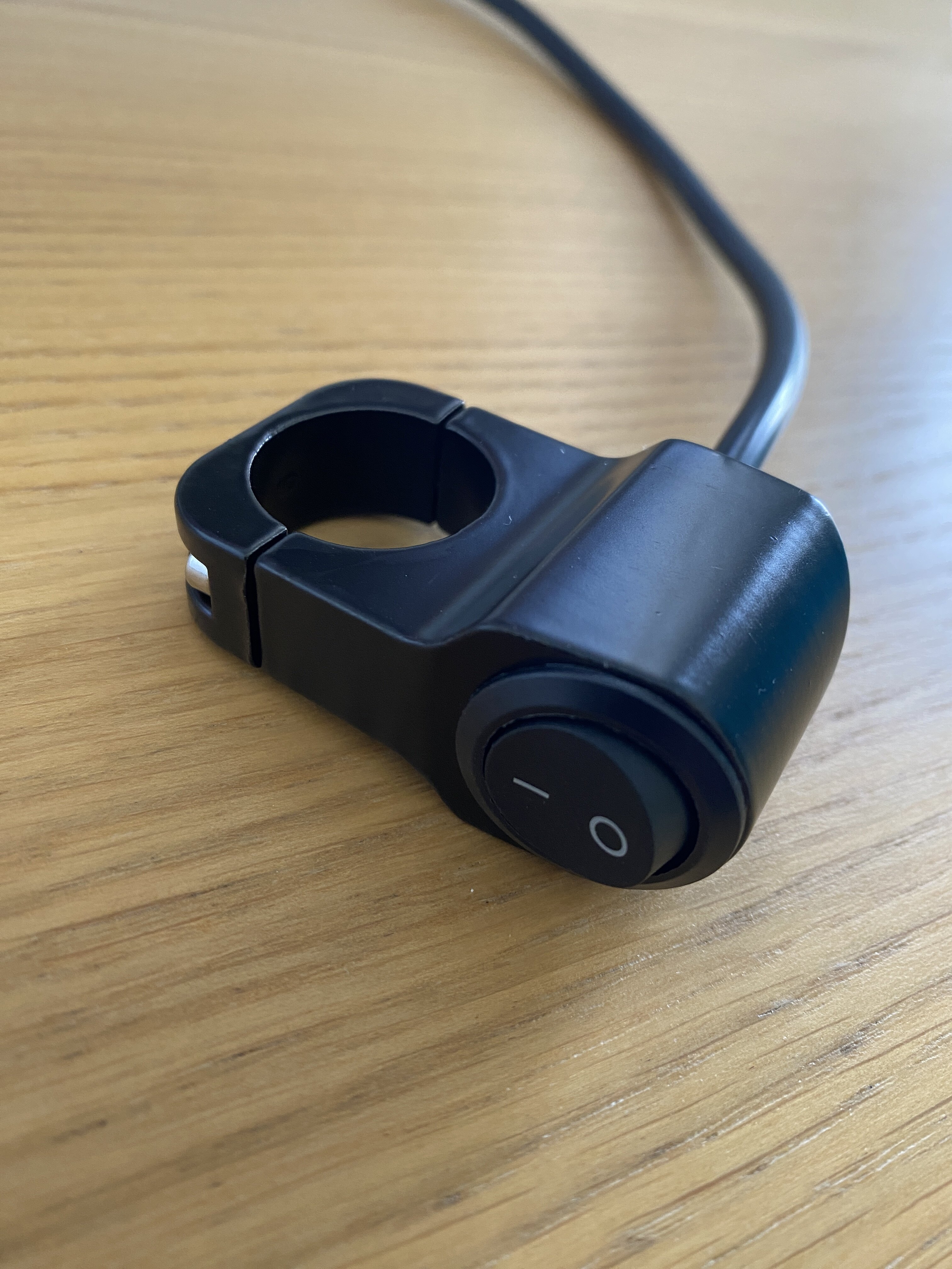

I've just bought this switch off eBay. It's a CNC aluminium body and "waterproof" (though without any IPxx rating), and it cost just £4 inc postage. It is so much better quality than the OE switch. The handlebar attachment is very narrow so it may go onto the straight bit of frame tube under the seat. If that's not suitable I'll mount it on the handlebar.

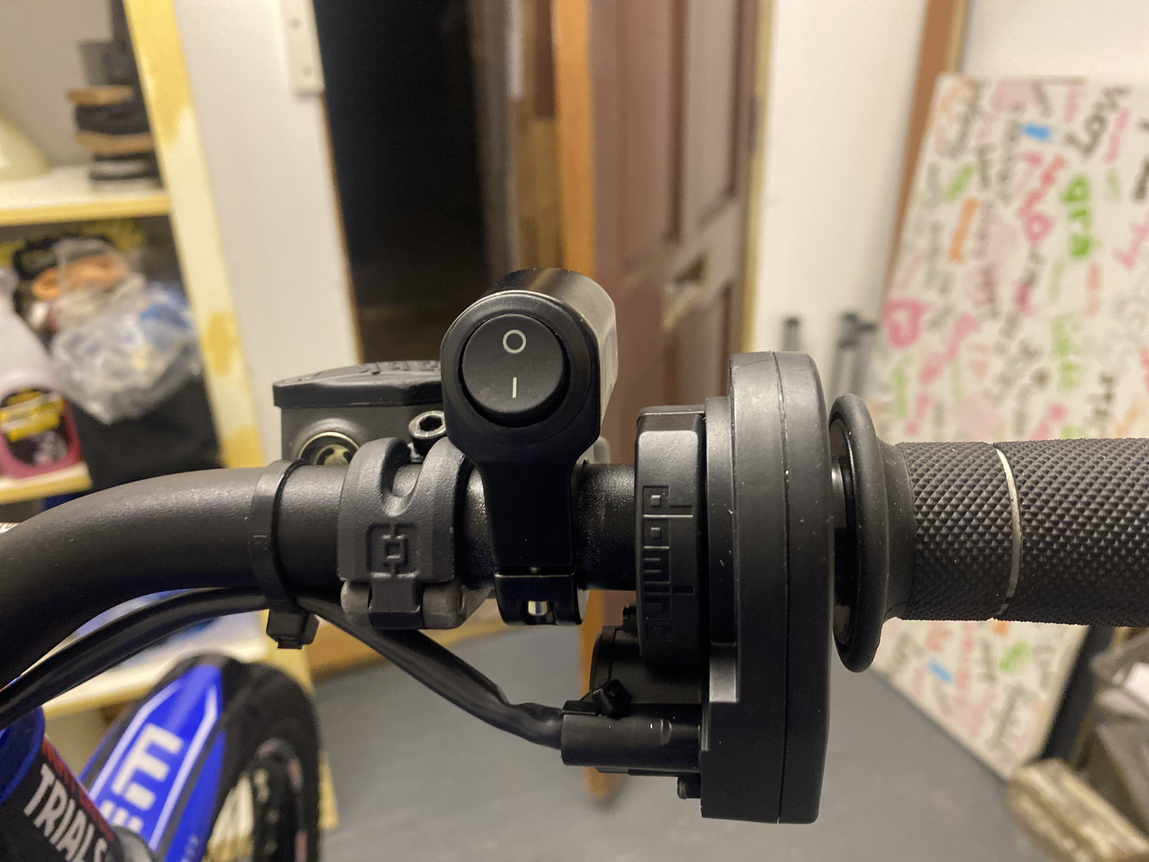

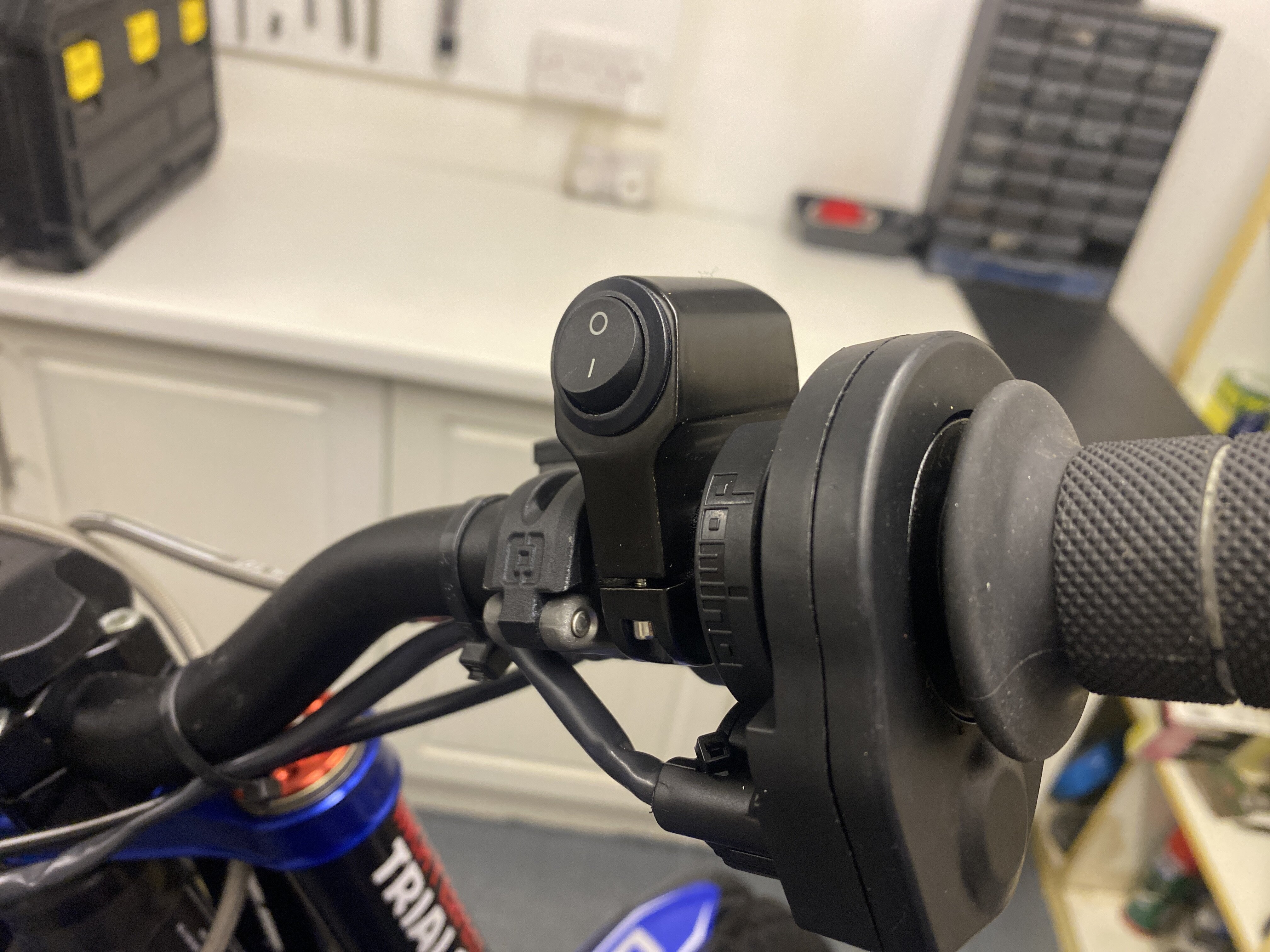

The switch didn't fit nicely under the seat because it is designed to mount on a 7/8 handlebar. So I've put it up beside the throttle. Total cost for switch, plug and a bit of wire was just over £9 from eBay, plus some time to solder and heat shrink the three elements together. For comparison, the OE switch from Inch Perfect (not nearly such good quality) is £52.99.
