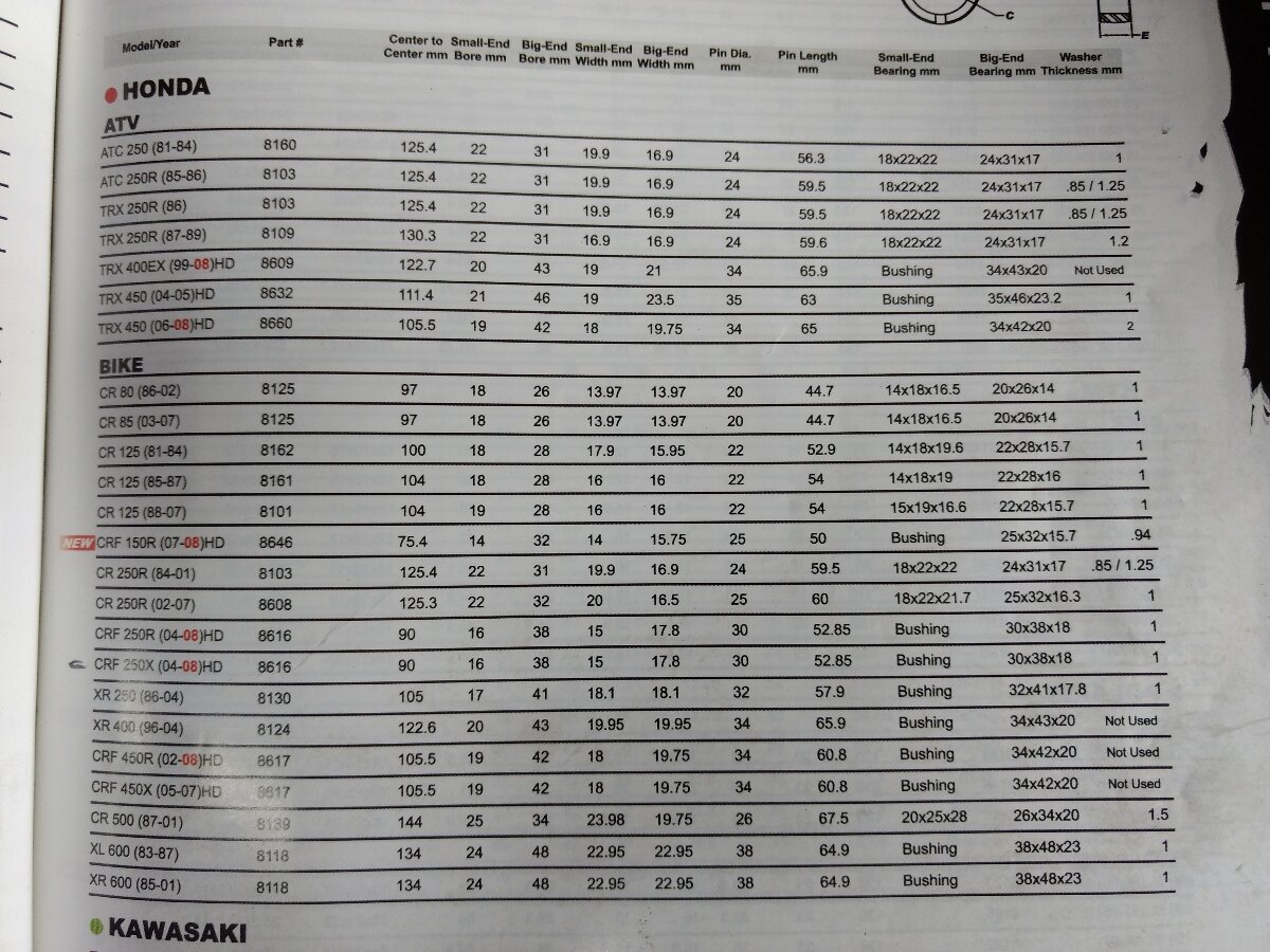

aussiechris Posted November 23, 2024 Report Share Posted November 23, 2024 I'm a bit late to the party but I thought I'd mention that I used a rod kit from HotRods for repairing my 2015 4RT 260 and it worked perfectly. Their part number is 8616. Original rod on the left... Specs are on the lines for CRF250R or CRF250X... Sources might be: https://www.allballsracinggroup.com/8616-connecting-rod-kit Or in the UK: https://www.motocrosspartsuk.com/honda-crf-250r-x-2004-2017-hot-rods-connecting-rod Quote Link to comment Share on other sites More sharing options...
