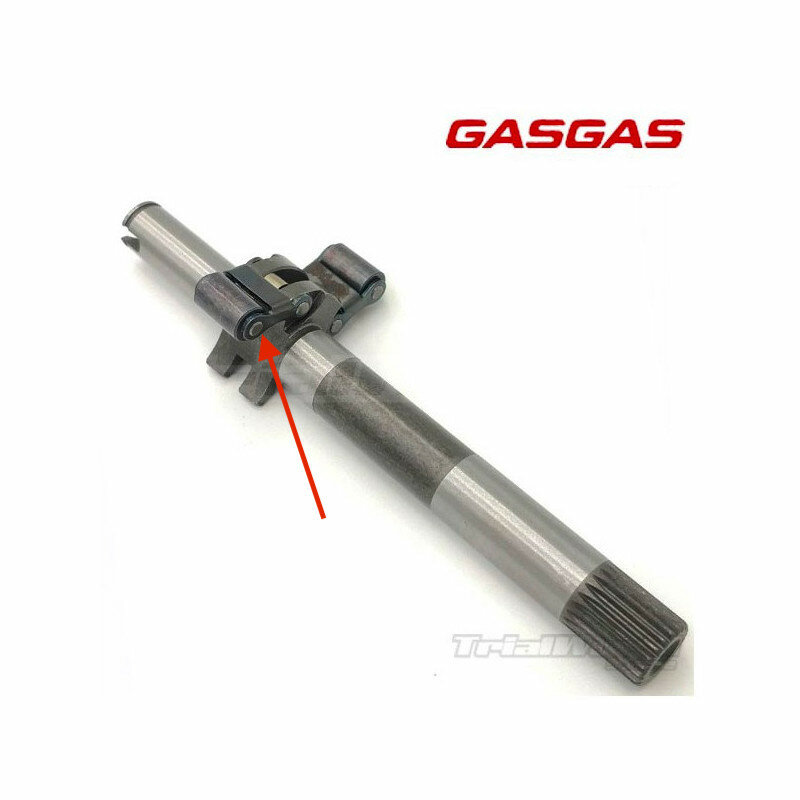

sectionone Posted November 6, 2024 Report Share Posted November 6, 2024 My 2007 Pro wouldn't shift from 3rd up and the shift shaft had a small crack where the arrow points to that caused the roller to not have enough pressure. I could have just welded it and saved some money since splitting the cases is not that hard. Quote Link to comment Share on other sites More sharing options...

cedec96 Posted November 6, 2024 Author Report Share Posted November 6, 2024 40 minutes ago, sectionone said: My 2007 Pro wouldn't shift from 3rd up and the shift shaft had a small crack where the arrow points to that caused the roller to not have enough pressure. I could have just welded it and saved some money since splitting the cases is not that hard. thanks for the advice, I'll definitely check it out Quote Link to comment Share on other sites More sharing options...
