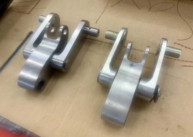

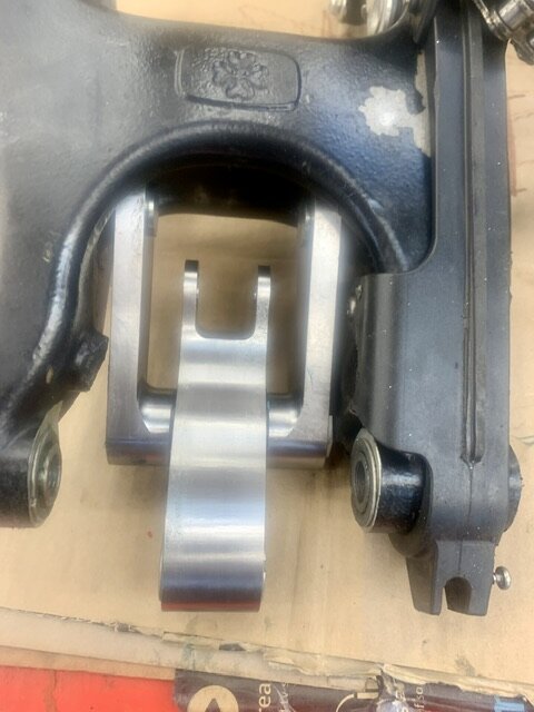

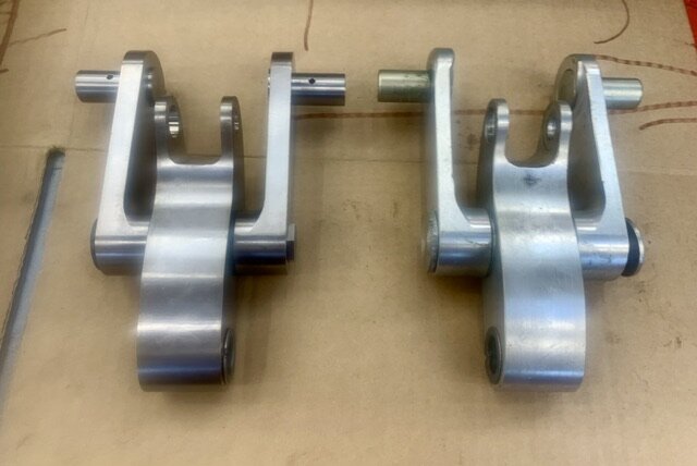

lotus54 Posted December 9, 2024 Author Report Share Posted December 9, 2024 (edited) Side by side with factory, and mounted in swingarm. Dogbones are 10mm thick and original is 7mm. Plus made from Ti grade 5 vrs some sort of aluminium for stock. Edited December 9, 2024 by lotus54 Quote Link to comment Share on other sites More sharing options...
larro Posted December 9, 2024 Report Share Posted December 9, 2024 Nice thank you for the pics. I presume the trials bike and Explorer are the same suspension wise. Where would the grease nipples be attached. Could be tempted but a little close to Christmas don't want them stuck some were over that period. Any idea of shipping cost to the UK. Thanks. Quote Link to comment Share on other sites More sharing options...
