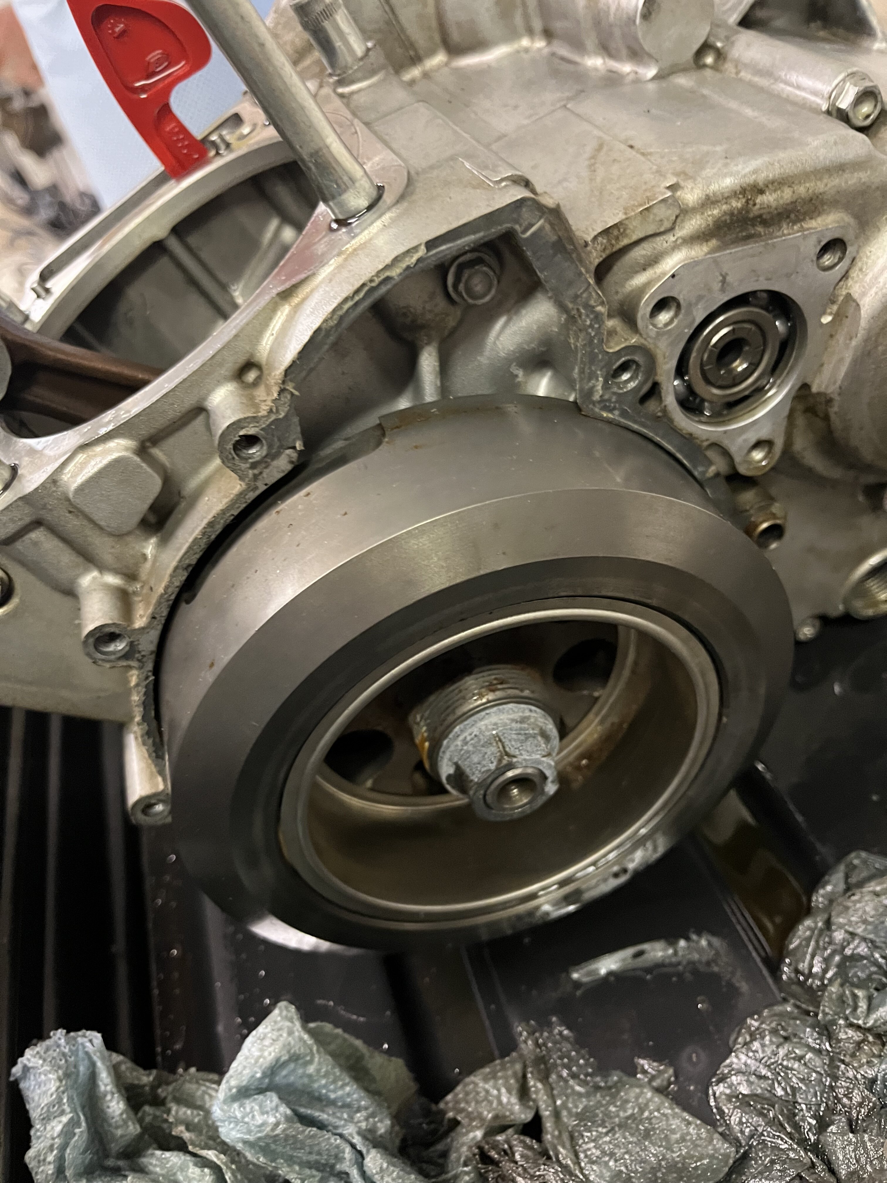

thall1 Posted November 13, 2024 Report Share Posted November 13, 2024 Is the flywheel securing nut Lh tbread? also, what about the threads on the flywheel itself where you screw in the puller… M32x1.5 I think?.. left or Rh thread? (cant see why it should be Lh but you never know?!) Quote Link to comment Share on other sites More sharing options...
lineaway Posted November 15, 2024 Report Share Posted November 15, 2024 The 4t is a fairly new motor. Should be right hand thread. A little hard with the motor apart. Quote Link to comment Share on other sites More sharing options...
thall1 Posted November 15, 2024 Author Report Share Posted November 15, 2024 Yes probably should have done it whilst still in the frame!. so just to confirm, you think the crank nut is RH thread? Quote Link to comment Share on other sites More sharing options...
lineaway Posted November 15, 2024 Report Share Posted November 15, 2024 Yes. 1 Quote Link to comment Share on other sites More sharing options...
lemur Posted November 15, 2024 Report Share Posted November 15, 2024 (edited) 6 hours ago, thall1 said: Yes probably should have done it whilst still in the frame!. so just to confirm, you think the crank nut is RH thread? That would be the correct way for the nut to tighten as a result of the engine firing, if the engine had to spin in the opposite direction it would need a reverse thread. If it had a reverse thread it would need something to positively stop (locking washer) the nut from loosening off in operation. Nobody puts a left hand thread on anything that does not absolutely require it, too expensive. Edited November 15, 2024 by lemur Quote Link to comment Share on other sites More sharing options...
thall1 Posted November 15, 2024 Author Report Share Posted November 15, 2024 (edited) Thanks guys… I’ll have a go later i can confirm it’s rh thread.. one person holding the engine and me on a breaker bar and it came free… just waiting for a flywheel puller now Edited November 15, 2024 by thall1 Quote Link to comment Share on other sites More sharing options...
thall1 Posted November 16, 2024 Author Report Share Posted November 16, 2024 Puller arrived… it won’t budge!… even with two of us on a spanner each!… can I put any heat on the flywheel? Quote Link to comment Share on other sites More sharing options...
lineaway Posted November 17, 2024 Report Share Posted November 17, 2024 You don't have an air impact or electric. Is the clutch side still togethet that you could hold the crank from turning by the rear sprocket. All tbis should have been done before engine tear down. Quote Link to comment Share on other sites More sharing options...
thall1 Posted November 17, 2024 Author Report Share Posted November 17, 2024 I do have both but haven't tried them yet. Yes I agree , probably should have come off whilst still in the bike…hindsight is a wonderful thing!.. Quote Link to comment Share on other sites More sharing options...
lemur Posted November 17, 2024 Report Share Posted November 17, 2024 Bring the puller up tight as you can and the give the puller a blow with a weighty hammer, let inertia do the work. Quote Link to comment Share on other sites More sharing options...
thall1 Posted November 17, 2024 Author Report Share Posted November 17, 2024 1 hour ago, lemur said: Bring the puller up tight as you can and the give the puller a blow with a weighty hammer, let inertia do the work. Someone else said too me… but taking a lump hammer to a precision shaft sat in bearings in an Ali casing just goes against the grain!… if all else fails I’ll give it a go!… thanks! Quote Link to comment Share on other sites More sharing options...
trapezeartist Posted November 17, 2024 Report Share Posted November 17, 2024 +1 for Lemur's suggestion. It really only needs quite a modest hit with a decently heavy hammer, and won't harm anything else. Quote Link to comment Share on other sites More sharing options...
Tr1AL Posted November 17, 2024 Report Share Posted November 17, 2024 9 hours ago, thall1 said: I do have both but haven't tried them yet. Yes I agree , probably should have come off whilst still in the bike…hindsight is a wonderful thing!.. How to go about doing things is all available on the internet , do your research first before attempting any jobs that you know nothing about , it is so much easier and there will be less chance of damage occurring. Quote Link to comment Share on other sites More sharing options...
thall1 Posted November 17, 2024 Author Report Share Posted November 17, 2024 Flywheel is off.. never used the ‘sharp hammer blow’ technique before, but it worked on this one… the two Gasgas’s and Montesa 4rt that I’ve stripped previously just came off with the puller… live and learn! 2 Quote Link to comment Share on other sites More sharing options...
lineaway Posted November 17, 2024 Report Share Posted November 17, 2024 Working on hydraulics all the time, that is the preffered method. THE HAMMER. I always loosen all the large parts before removing the top end so you can hold it all in place. Makes life much easier. Same going back together. Quote Link to comment Share on other sites More sharing options...
