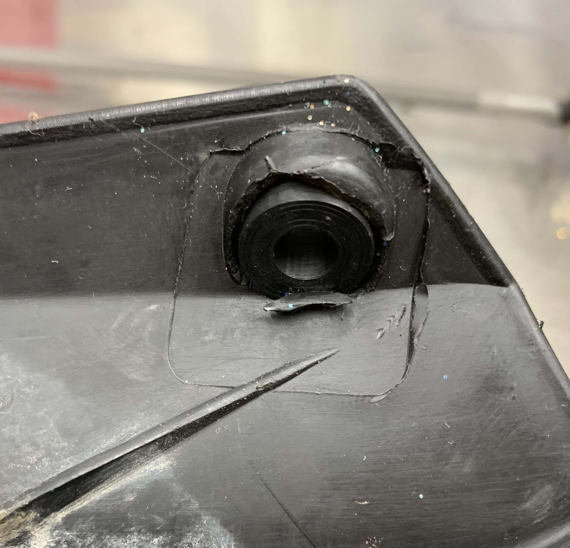

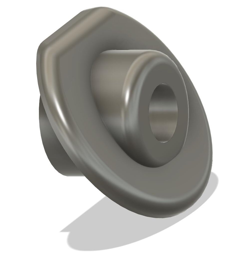

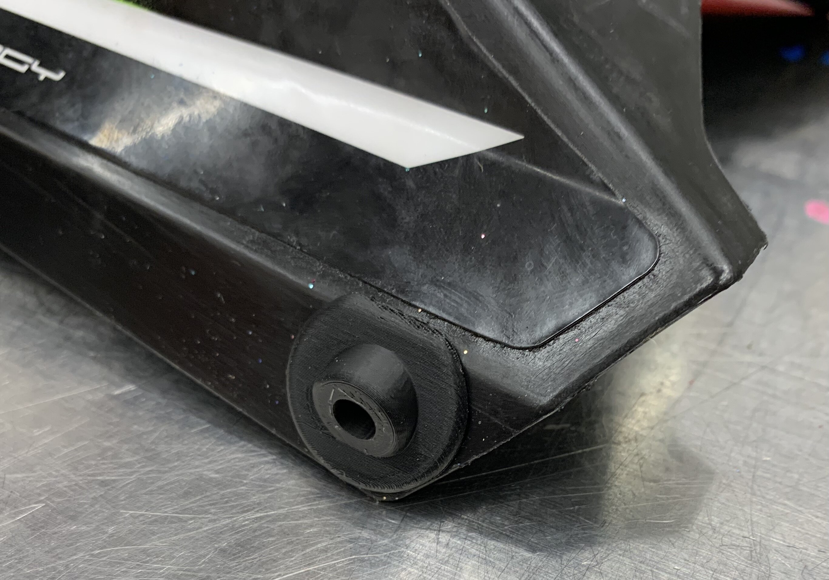

lotus54 Posted November 17, 2024 Report Share Posted November 17, 2024 2015 Explorer. I’ve seen several Explorers that had the rear fender mount areas broken- there the huge handrail is mounted. I take those off anyway, since they get in the way when getting weight wayback. So I designed some bushings that will fill the broken sections and press against good part of the fender. This allows easy firm mounting of fender without grabrail, especially if the parts are broken. Quote Link to comment Share on other sites More sharing options...
