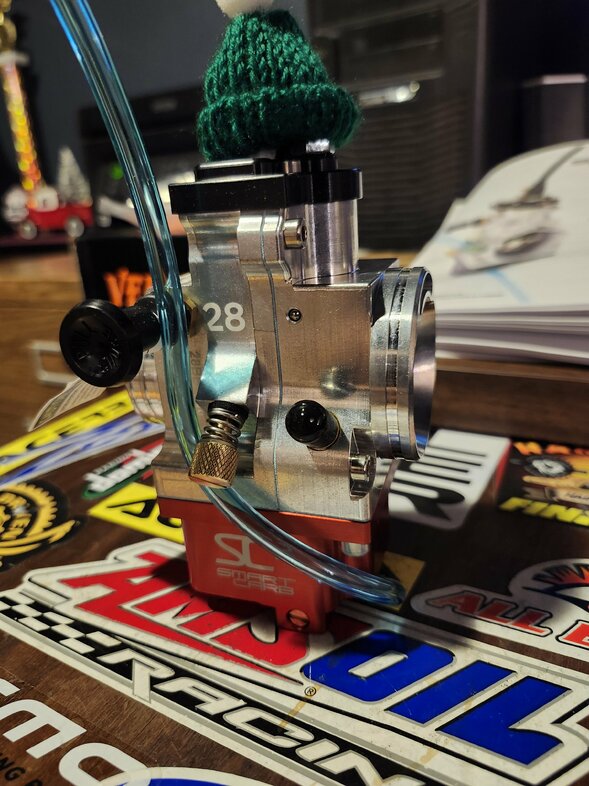

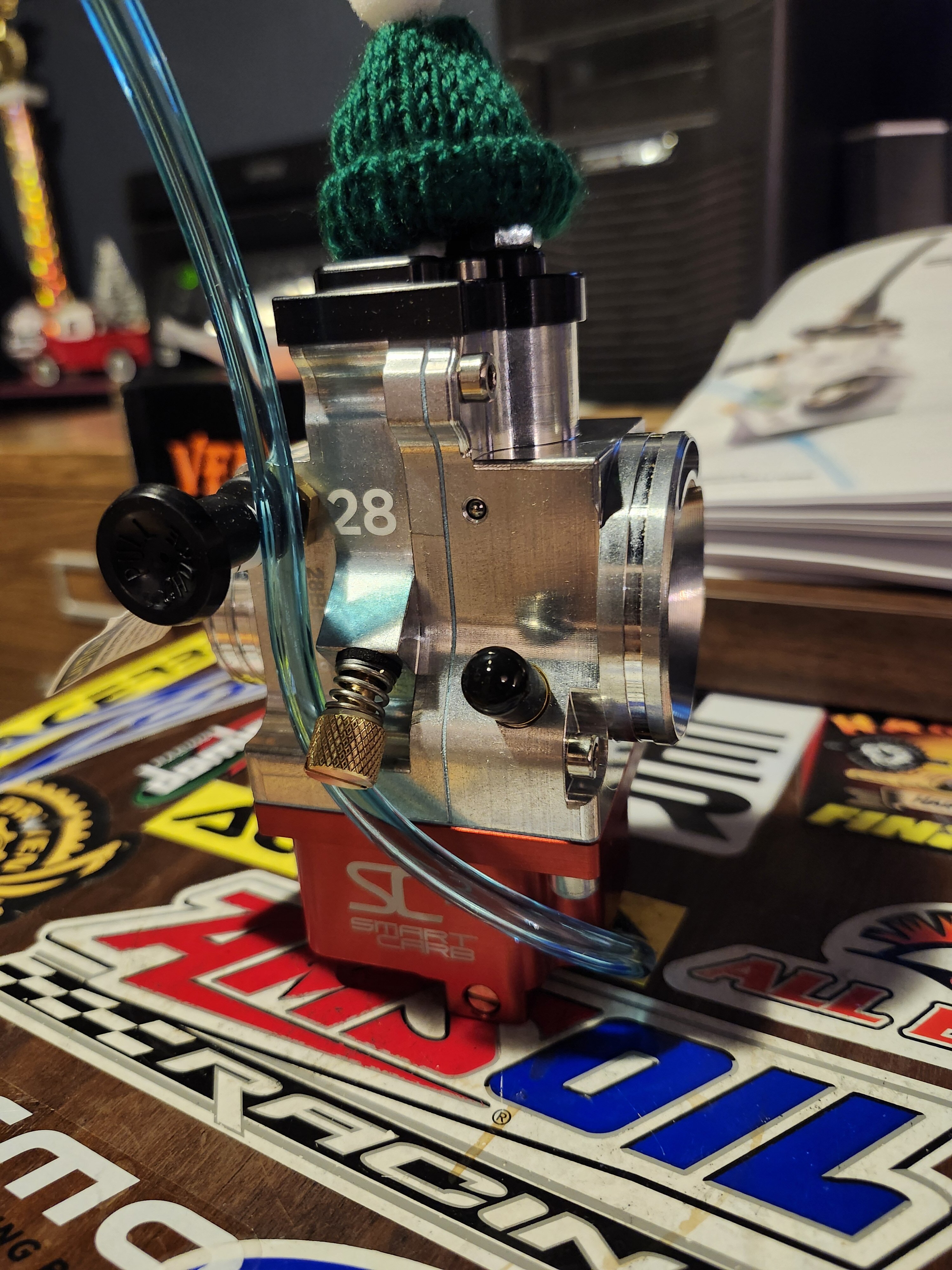

Assgas Posted March 14 Author Report Share Posted March 14 I just bought a Smart Carb now it runs like EFI perfect 1 Quote Link to comment Share on other sites More sharing options...
Tr1AL Posted March 15 Report Share Posted March 15 The design of that carb is very interesting I like it a lot but at $700.00 USA and £770.00 in the UK it seems to be a works rider only choice. At club level in the UK it seems a little excessive to my mind . A couple of years ago I bought a second hand genuine KEIHIN PWK28 with standard manufacturer recommended jets/settings for £50.00 off ebay gave it a clean by hand and it worked absolutely crisp from pick up through to rev out. If you have Elons money then of course why not if it works as well as they say its like having fuel injection as you point out. Enjoy and no more jetting problems for you , that has to feel good. All the best Alan. Quote Link to comment Share on other sites More sharing options...
Tr1AL Posted March 15 Report Share Posted March 15 For any one that is interested I just found this that gives the necessary information about the SMART CARB SC2. https://youtu.be/tBuwSkjruk0?feature=shared . Quote Link to comment Share on other sites More sharing options...
Assgas Posted March 15 Author Report Share Posted March 15 My bike does not ping anymore at mid throttle and it revs clean all the way threw the RPM range and over rev I let a Vertigo rider try it He gave it a two thumbs up. It runs like my EFI Quote Link to comment Share on other sites More sharing options...
