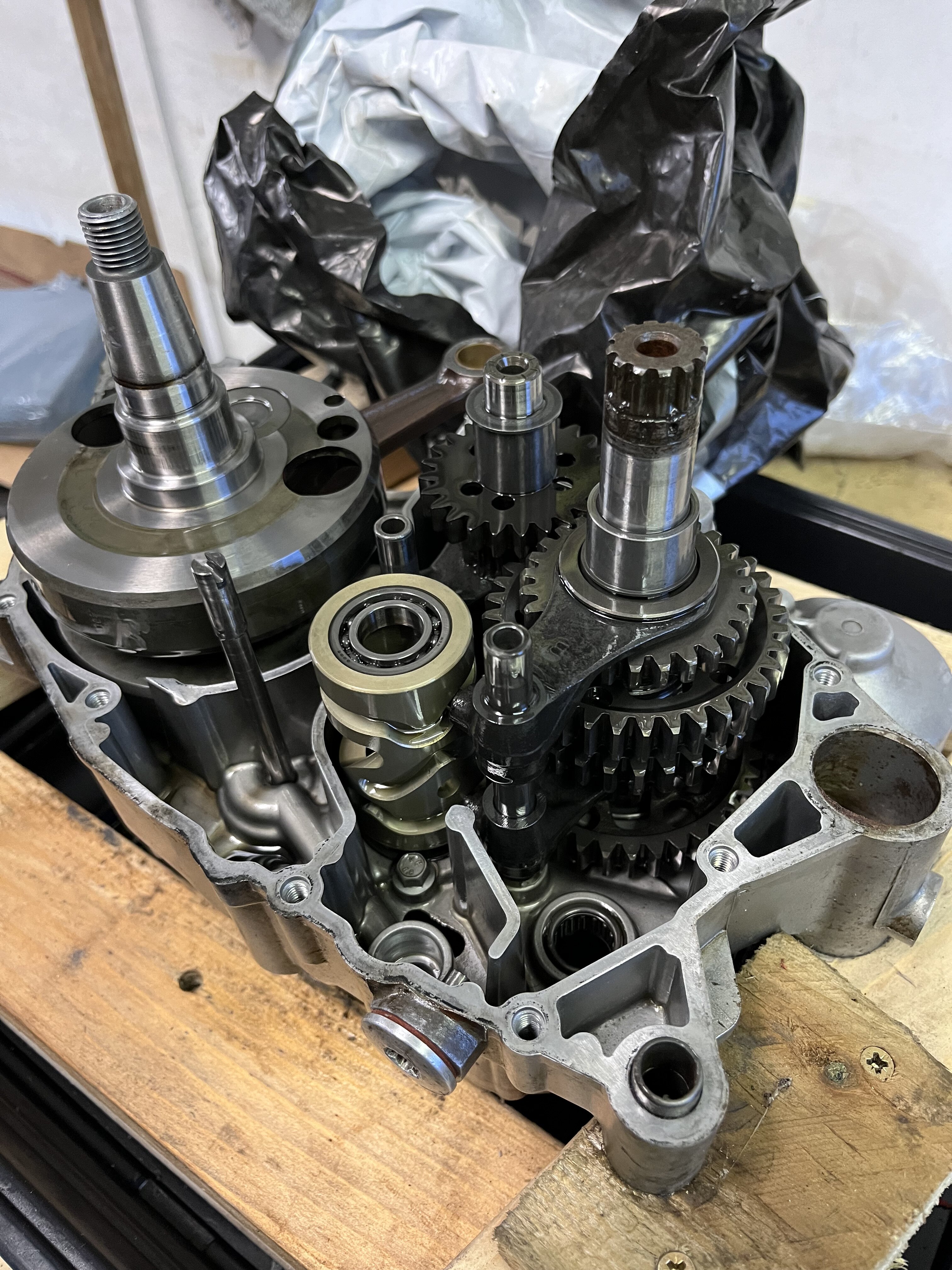

thall1 Posted November 19, 2024 Report Share Posted November 19, 2024 So casings split… nothing obvious that’s broken or damaged. Using an Allen wrench on the gear change drum on the clutch side I can get 1st, neutral and 2nd… and there it stops? always had a problem when going 2nd-3rd it felt like 2nd hadn’t fully disengaged but cleared if I went back to 2nd the up into 3rd… lovely & clean inside.. no debris or any sort to be found which in some respects is very good but was hopping to see something obvious and maybe something sat in the bottom of the casing! any thoughts would be greatly appreciated! Quote Link to comment Share on other sites More sharing options...

lemur Posted November 20, 2024 Report Share Posted November 20, 2024 Check the shift forks for slight bends or wear on the tips or binding on the shaft. Quote Link to comment Share on other sites More sharing options...
thall1 Posted November 20, 2024 Author Report Share Posted November 20, 2024 4 hours ago, lemur said: Check the shift forks for slight bends or wear on the tips or binding on the shaft. That’s my next plan… the shafts are fine and they don’t bind on them.. I was going to put the shafts into vee blocks and check the squareness of the selector forks. Initial inspection shows nothing up.. Quote Link to comment Share on other sites More sharing options...

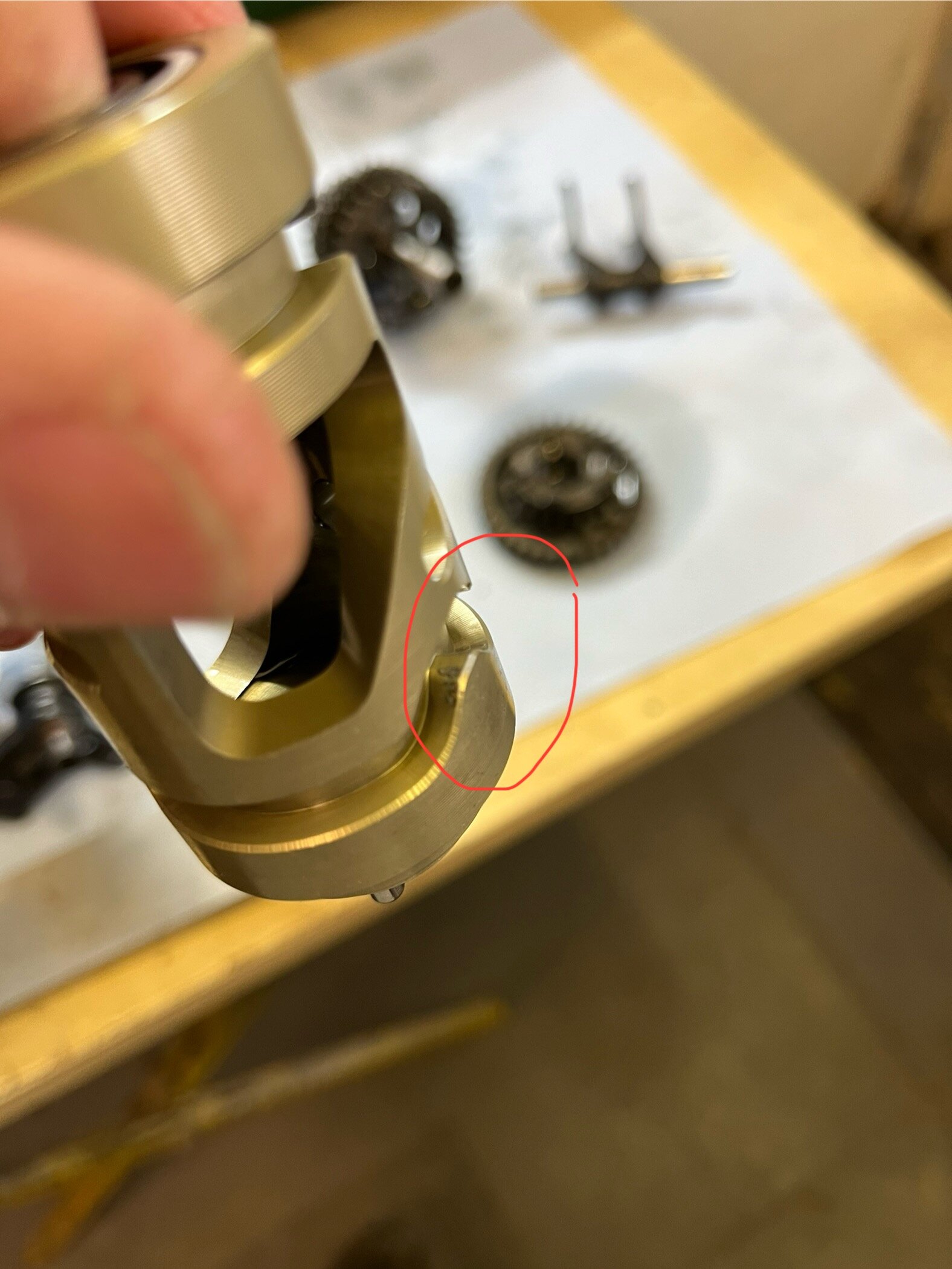

thall1 Posted November 22, 2024 Author Report Share Posted November 22, 2024 Had a good look over everything today… the only issue I can see or find are very slight wear marks on the crowns of the gear selector drum guides, and a very slightly notchy drum bearing… other than that it all looks to be fine… I’ll try and post pictures of the drum but I wasn’t allowed last time… if I do get them posted if anyone has any opinions on wether this would be enough to stop the gears selecting I’d be greatfil to hear your thoughts? Quote Link to comment Share on other sites More sharing options...
lemur Posted November 22, 2024 Report Share Posted November 22, 2024 1 hour ago, thall1 said: ... very slightly notchy drum bearing… Roller bearings should not feel notchy or they have been compromised. 1 Quote Link to comment Share on other sites More sharing options...
thall1 Posted November 22, 2024 Author Report Share Posted November 22, 2024 (edited) Yes I was going to replace the bearing as a matter of course… not sure this could be the cause of the issue?… any thoughts on the wear marks on the selector drum?… not sure these would be enough to jam the mechanism.. they look worse than you can feel Edited November 22, 2024 by thall1 Quote Link to comment Share on other sites More sharing options...
