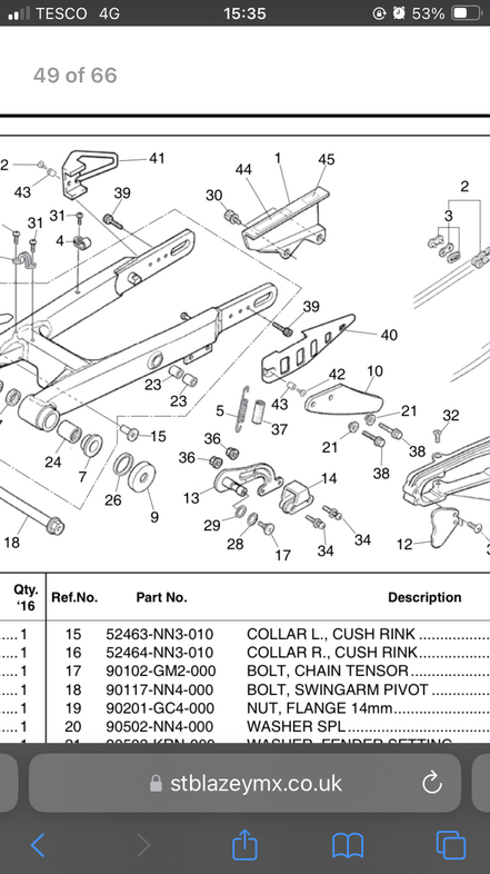

mcman56 Posted November 27, 2024 Report Share Posted November 27, 2024 Are there any secrets to removing the chain tensioner pivot bolt on a 2018 300 4rt? So far I have tried penetrating oil, heat and a few heat cycles. Does a steel bolt thread right into an aluminium pivot? Quote Link to comment Share on other sites More sharing options...

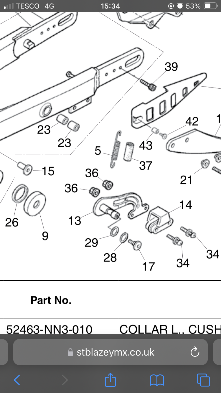

jrsunt Posted November 28, 2024 Report Share Posted November 28, 2024 The tensioner arm returns back into the swinging arm and the bolt threads in to it. There are a couple of copper bushes pressed into the swinging arm which the tensioner pivots on. They’ll probably be worn as will the aluminium tensioner. Quote Link to comment Share on other sites More sharing options...
jrsunt Posted November 28, 2024 Report Share Posted November 28, 2024 2 Quote Link to comment Share on other sites More sharing options...
barnesy Posted December 2, 2024 Report Share Posted December 2, 2024 I've just changed mine on a 315 which is a similiar set up I believe. I used a socket set with an allen key to get the allen bolt out (number 17 in the diagram above) a regular allen key just bent it was that tightly wedged in.. Quote Link to comment Share on other sites More sharing options...
