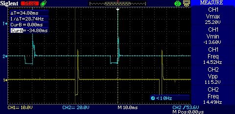

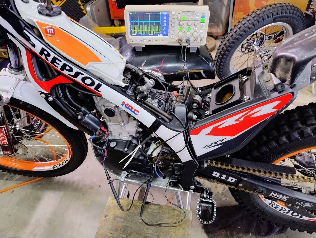

aussiechris Posted December 12, 2024 Report Share Posted December 12, 2024 (edited) Warning: long message with copious amounts of techno-babble. I was reading an old discussion on this forum about whether the 4RT runs a “wasted spark” ignition (that is one spark per revolution of the crankshaft) rather than a more conventional (four stroke) one spark every 2nd revolution. It was also suggested that the fuel injection is not sequential but rather injects fuel continuously. Certainly Honda are not averse to using wasted spark ignitions - many of their multi-cylinder bikes do just that. And given the engine does NOT have a cam position sensor, both the above would be reasonable assumptions. However, I think I have managed to prove that the engine does only fire the spark plug every second revolution and the fuel injection also occurs every second revolution timed to intake valve opening (which makes sense given the location of the injector). How? Let’s get technical… I made up some test harnesses to enable me to intercept the wiring at the trigger (pulse generator) coil, the ignition coil, and the fuel injector so that I could view what’s happening on an oscilloscope. At my (slow) idle speed of around 1700rpm, the crankshaft is rotating 28.3 times per second or once every 35 milliseconds. The crank trigger coil sends pulses to the ECU every time a hole in the flywheel passes by. The flywheel actually has a row of holes/slots that pass the trigger coil, then a gap with no holes and that gap or burst occurs every 35mS. The pic below shows the output of the trigger coil on Ch1 in yellow. The blue trace (Ch2) is the ECU signal going to the ignition coil primary. You will note that it only occurs every 2nd burst of trigger pulses. The ignition coil pulses are about 70mS apart (each grid square being 10mS) so that is about 14.2 times a second or 850rpm. That’s half the crank rpm of 1700. So what about the fuel injection? Unfortunately I only have a two channel scope so in the following image, the Ch1 yellow trace is now the fuel injector signal. The blue trace is still the ignition coil showing the relationship between the two. You can see how the fuel injector fires in between each ignition pulse. This is always the case regardless of rpm. The injector is firing every 70mS just like the ignition coil except one crank rotation out of phase. I did some measuring and the injection pulse* occurs 34.8mS before ignition spark… Given the time for two revolutions (720°) is70ms, then fuel injection is commencing about 358° before the spark which sounds about right - just before the intake valves open at the end of the exhaust stroke (taking into account spark advance and valve overlap). The injector pulse duration (the negative bit) at idle is about 2ms long (just over 20° of crank rotation) but is visibly longer when the throttle is opened. So, in summary, this engine definitely fires the spark plug every second revolution (at the end of the compression stroke) and injects fuel sequentially just prior to the intake stroke. That just leaves one question for ya’ll to ponder… Since the engine does not have cam position sensor (or points), how does it know which stroke it is on? It would be easy to suggest it just fires the spark plug every second crank trigger but it has to pick the correct one to align with the camshaft otherwise it wouldn’t run. I have a theory on how it might achieve this every start but wondered if someone else would like to offer an opinion. Looking forward to your comments. * Note: the above traces are referenced to the +13.5v power. Both the ignition coil and fuel injector are switched to ground by the ECU. The spark plug fires when that ground is removed (the end of the negative pulse) but the fuel injector opens when the ground is applied (start of the negative pulse). Edited December 12, 2024 by aussiechris Quote Link to comment Share on other sites More sharing options...

aussiechris Posted December 12, 2024 Author Report Share Posted December 12, 2024 6 minutes ago, konrad said: Instantaneous crankshaft speed. The crank slows on compression and speeds up on expansion. Almost certain it must fire every crank revolution until it's actually "running", though. Nice to see another curious person on this forum! That's certainly a possibility Konrad. I know my six cylinder car does that so it can detect a misfire and log a code indicating which individual cylinder is missing. It could explain why there's a row of trigger holes in the flywheel rather than a single slot like other bikes. But I was thinking of another possibility. And yes, too curious for my own good! Quote Link to comment Share on other sites More sharing options...

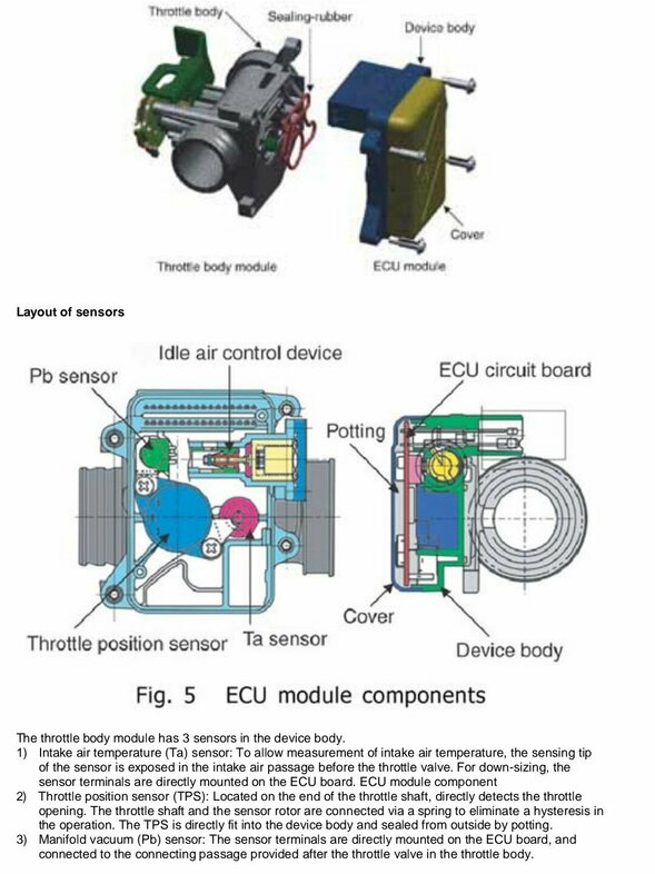

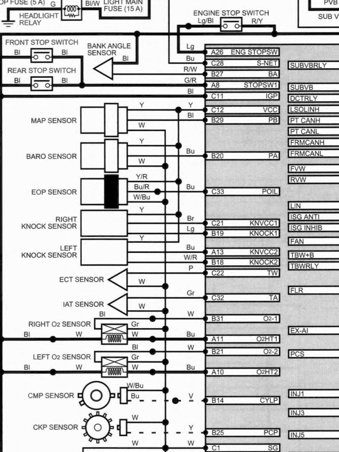

konrad Posted December 12, 2024 Report Share Posted December 12, 2024 The ECU is integrated into the throttle body. The wiring diagram shows three blocks inside the ECU marked TPS, PB, and TA. I assume these stand for Throttle Position Sensor, Pressure Barometric, and Temperature Ambient. Elsewhere in the service manual, however, reference is made to a MAP (Manifold Absolute Pressure) sensor. So if it's a MAP sensor, I can see looking for intake vacuum. If it's a barometric pressure sensor, that would be on the other side of the butterfly. The intake vacuum theory would also explain why they say not to touch the throttle while kicking-starting. I'm sure the answer is well known since Honda started using this integrated throttle body on the first FI 450 MX bikes circa 2009. 1 Quote Link to comment Share on other sites More sharing options...
aussiechris Posted December 12, 2024 Author Report Share Posted December 12, 2024 7 hours ago, sportsawyer said: I the past, I suspected the ECU was looking at MAP vacuum to determine the intake stroke and know which crank revolution it was on. Yes, that's exactly the way I was thinking. During start up, it would be relatively easy to detect the first sudden pressure drop as the inlet valves open. That would tell the ECU that the next crank trigger pulse requires a spark and the one after requires fuel and so on. 2 hours ago, konrad said: The ECU is integrated into the throttle body. The wiring diagram shows three blocks inside the ECU marked TPS, PB, and TA. I assume these stand for Throttle Position Sensor, Pressure Barometric, and Temperature Ambient. Elsewhere in the service manual, however, reference is made to a MAP (Manifold Absolute Pressure) sensor. So if it's a MAP sensor, I can see looking for intake vacuum. If it's a barometric pressure sensor, that would be on the other side of the butterfly. The intake vacuum theory would also explain why they say not to touch the throttle while kicking-starting. I'm sure the answer is well known since Honda started using this integrated throttle body on the first FI 450 MX bikes circa 2009. I agree. I think the PB sensor incorporated in the throttle body is actually a MAP sensor. Just as an aside, this is part of the ECU wiring from my current model Honda Goldwing. It has both a MAP sensor (in the intake manifold) and a baro sensor (under the seat). Notice that the MAP sensor goes to the input labelled "PB" at B29 whilst the baro sensor goes to "PA". Coincidence, or is this Honda's terminology. I think PB is a MAP sensor. Quote Link to comment Share on other sites More sharing options...

aussiechris Posted December 13, 2024 Author Report Share Posted December 13, 2024 5 hours ago, konrad said: The ECU is integrated into the throttle body. The wiring diagram shows three blocks inside the ECU marked TPS, PB, and TA. I assume these stand for Throttle Position Sensor, Pressure Barometric, and Temperature Ambient. Elsewhere in the service manual, however, reference is made to a MAP (Manifold Absolute Pressure) sensor. So if it's a MAP sensor, I can see looking for intake vacuum. If it's a barometric pressure sensor, that would be on the other side of the butterfly. The intake vacuum theory would also explain why they say not to touch the throttle while kicking-starting. I'm sure the answer is well known since Honda started using this integrated throttle body on the first FI 450 MX bikes circa 2009. I found this snippet from a Honda PGM-FI development document... It's not identical to ours because it's off a scooter but close enough. It notes that the Pb sensor reads manifold vacuum and is mounted downstream of the butterfly valve (point 3 at the bottom). Quote Link to comment Share on other sites More sharing options...
konrad Posted December 13, 2024 Report Share Posted December 13, 2024 Nice find! So maybe "a" just refers to the airbox side of the butterfly and "b" the engine side? The automatic idle air control is a nice feature. But I guess Honda figures competition riders have their own preferences. Quote Link to comment Share on other sites More sharing options...
