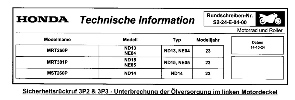

In the EU there's a recall on 2023 models, mine included. On some 2023 models there's an oil channel in the left cover that hasn't been drilled properly. I got notified more than a month ago. Had to do a test according to a dealer document sent by Honda Germany. Here's a short vid of the test. Both pieces of paper have to move. If not, there's an issue.
After Honda saw the result, they said they were going to replace the engine which they did. I picked it up today. Excellent service that Honda is doing this.

Yes, Honda had my dealer install the new motor. And indeed that is good service.
