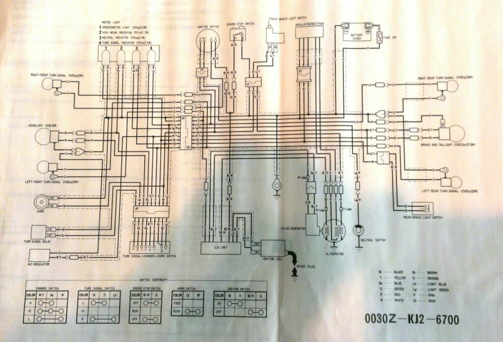

johnnyjazz Posted March 4 Report Share Posted March 4 Hello friends, hoping someone with more knowledge than I could help with a question!... I have a TLR reflex that I use for trials, however it is fully road legal as I need to ride to my spots. Is there any way one could install some kind of switch to essentially turn the 'lighting' circuit off but keep the bike running? i was told it runs 2 seperate circuits.... Currently the woods are mid winter bare and the lack of leaf cover makes me quite visible to passers by (cop callers). Thealways on headlight esp can be seen a mile off! just wondering if one could install a 'stealth' option...has anyone done this? Not sure where in the wiring one would put it or if it's even possible? Thank you so much in advance for any help!..Johnny in NY Quote Link to comment Share on other sites More sharing options...

lemur Posted March 4 Report Share Posted March 4 You could maybe try unplugging the White to White/Yellow wire coming out of the engine. Diagram appears to show it as being a dedicated lighting coil output. 1 Quote Link to comment Share on other sites More sharing options...
lsv Posted March 16 Report Share Posted March 16 I would have thought a switch in series with the main fuse would suffice as they don't need battery to run ignition I believe. But I stand to be corrected! 🙂 1 Quote Link to comment Share on other sites More sharing options...
